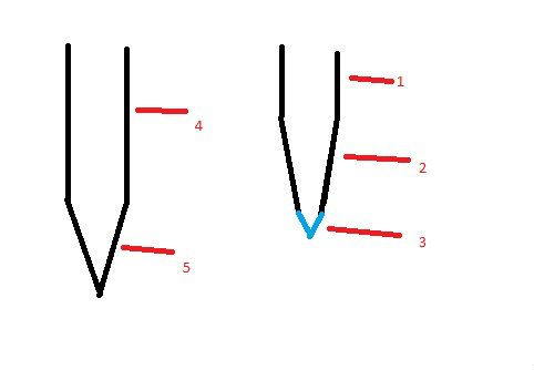

This is my understanding
The one on the left is the scandi line 5 points to the cutting edge where on a sabre grind knife (the one on the right) line 3 points to the cutting edge. Basically the sabre grind is a really high scandi grind with a microbevil added to the cutting edge. If someone else can explain it better please do to. I am by no means a word smith. Hope that helps.
Here's the way I understand it.
Saber grinds are any grind toward mid-line (symetrical) that does not include the entire blade. This can be with or without a secondary bevel.
Scandi do not have a secondary bevel.
So Scandi grind is a type of Sabre grind (without the secondary bevel).
I'm by no means an expert, but this is what I was told at a knife show once.

Actually some scandi grinds DO have a secondary bevel, the Enzo Trapper is avalible with a secondary bevel and all of the Habilis Bushtool range have a secondary bevel.
Let i put it here.
Scandi is a sub tipe off sabre grind in witch the bevel is closer tothe edge.
The fact of having a second bevel doenst matter. And it can be convexed.
A sabre but not scandi:
V
A sabre and scandi:
V

I wouldn't really say a scandi is a type of sabre grind. A sabre is ground around mid spine or higher with whatever secondary bevel you prefer. A scandi is more of a double chisel grind i guess you could say. I suppose you could set a scandi bevel that high but I have never seen it. They are usually around a half in to at most 3/4 of an inch.

Thanks to the poster and responses as I now understand this.
The whole "a scandi is a sabre without the second grind" would have made my brain melt if I didn't see the pics :)
