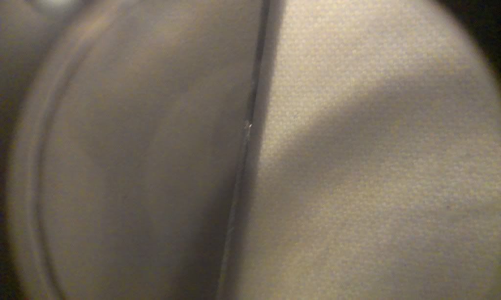

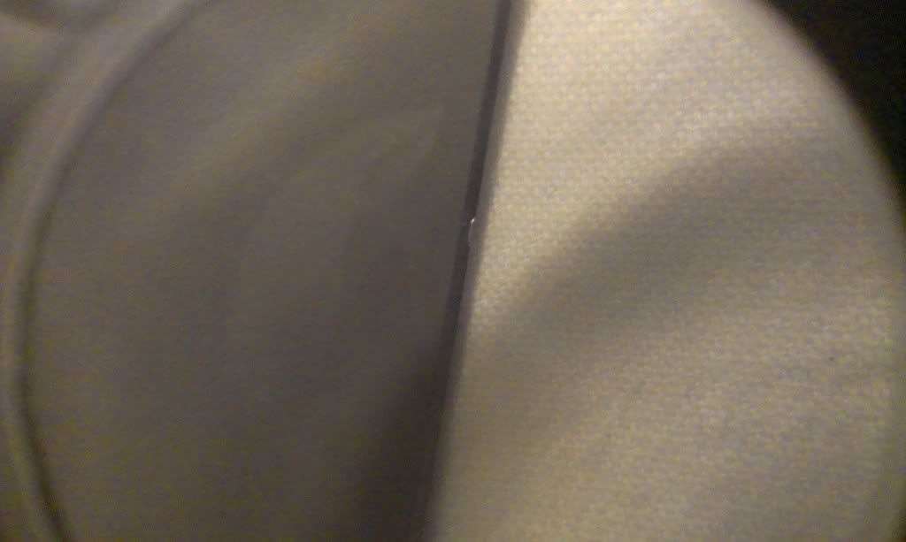

So I got to looking at the edge on my Contego just now. There's a small roll and I can't imagine what it could be from. I've only cut cardstock, clamshells and other light duty stuff. Like I said, it's small, but it'll pull on my fingernail pretty hard. Also this is a pretty obtuse edge, factory bevel honed on a wicked edge.
Here's a couple of pics through my loupe.
Am I expecting too much?
yes, it's a knife edge, sometimes they take damage. maybe you hit a small piece of staple you didn't see. maybe the factory edge had a wire edge, who knows. If it's not in a 100% controlled environment, and it's a one time thing I wouldn't worry about it.
