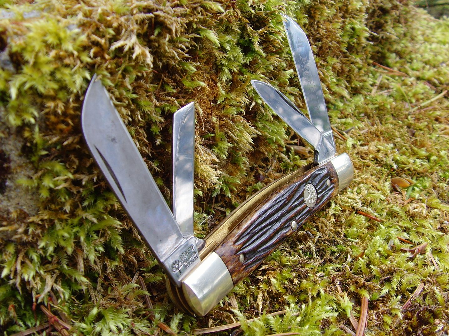

So what happens if it's just a tree with nothing else? For instance I just stole this image of the Boker Appaloosa Tracker from KnifeCenter.
Shield JUST has a tree. Blade is marked Solingen. does this mean german parts with Chinese assembly? or all done in Solingen?
depends on what you order, look for Solingen on the tang, that will give you a better clue of production. its not much hope it helps

I have a few of the completely made in Germany Tree Bokers and they are excellent! Here is the congress that I have(not my picture b/c I am at work) which has beer barrel covers and c75 carbon steel blades that take a nice keen edge:
The fit and finish is very good and the blades even came sharp!
I'm sure this is a true Solingen made Boker.

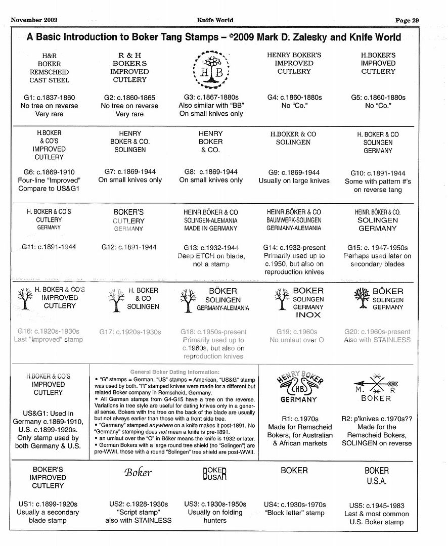

I have two congress models in different covers;
Both have in descending order;
BOKER
SOLINGEN
GERMANY
stamped on the main blade tangs with the tree to the left of the text. The lack of tree on yours doesn't concern me at all - I still think it's fine.
Here's a tang stamp chart if you want to date it;
Edited to add: thinking about it this chart is probably 6 or 7 years old...
