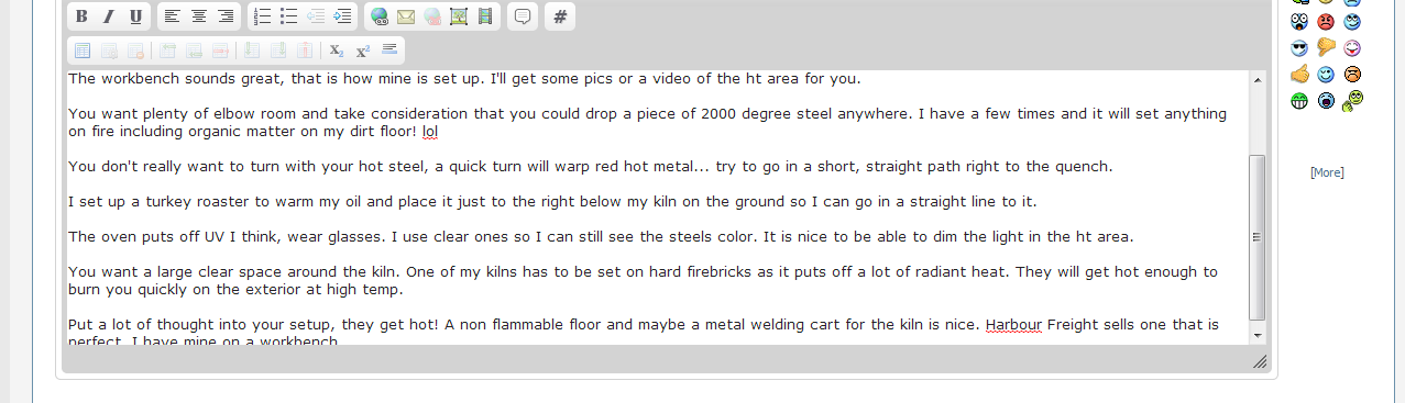

[/URL]
That's a lot of good info on setup to take into consideration—thanks Daniel! I don't think I would've considered UV protection as a safety measure. The link to USA Knifemakers you posted earlier has this particular oven in stock: http://usaknifemaker.com/heat-treat...n-oven-and-kilns-c-57-168/kinfedogs-oven.html
Since you gave me the brilliant idea to run a 220 extension from my dryer outlet, I think I could pull that off. That is assuming there isn't a limit to the effectiveness/range of a 220V extension cord. Also, the oven found in the above link is not digital. Do you feel that would pose an issue starting off?
