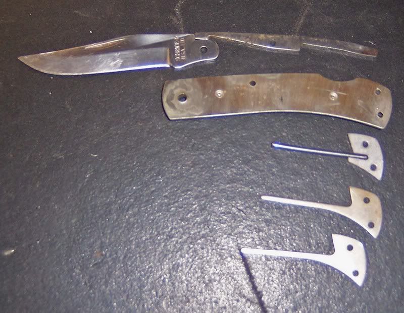

The LB7 first appears in Schrade Catalogs in 1978. So you see Buck had a big head start on Schrade in that pattern. I have several LB7s & several Buck 110s. I actually prefer the 110 over the LB7 just for the way it fits my hand. Design wise the knives are very close. In later years Schrade went to a different spring system than they started with. The new system was 2 flat springs that ate pinned in side by side, forming both the spring & the spacer between the rear bolsters. The same style of flat spring was used on the 3OT & 5OT. I think perhaps they had problems getting the heat treatment right on the flat springs. I have probably seen 3-4 dozen failures of that type spring, especially in the 3OT. The flat springs in the LB7 seem to fail at a higher rate than the old spring (bar) and keeper type.
Here are the 2 spring types illustrated in an LB5.
The upper spring assembly is the spring (bar) and keeper type.
The 2 one-piece springs below it were installed side by side to act as the spacer to hold the bolsters apart & as the spring. They usually fail about 1/4 to 3/8" from the body of the spring.
Buck stayed with the old system (like the upper spring), which in my opinion is better & more reliable. I give them kudos for not changing something that works. I also am a great fan of their Build a 110 portion of their web site. I have a 110 with a BG-42 blade. That knife is scary sharp.

I'd have to agree with Dale on the failure of the newer style lockbacks springs. I've got LB-1, 3 and 5 failures as well. The custom LB5 and 7 seem to have this as a major issue.
Thanks guys. The LB7 I have has the older style with the bar and the keeper.
Hopefully I got a good one because this seems to me just as good or better than a buck 110. Now I've only had 2 Buck 110's but this LB7 is sure nice (and that's considering that I bought both Buck 110's brand new).

Larry,
If you haven't been able to fix them yet, send them to me & I will convert them to the bar & keeper type. It is a pretty easy fix, just a bit of work with the file and some flat nickle silver or brass stock.
I also have some to the flat type springs as well if you want to keep it original.
