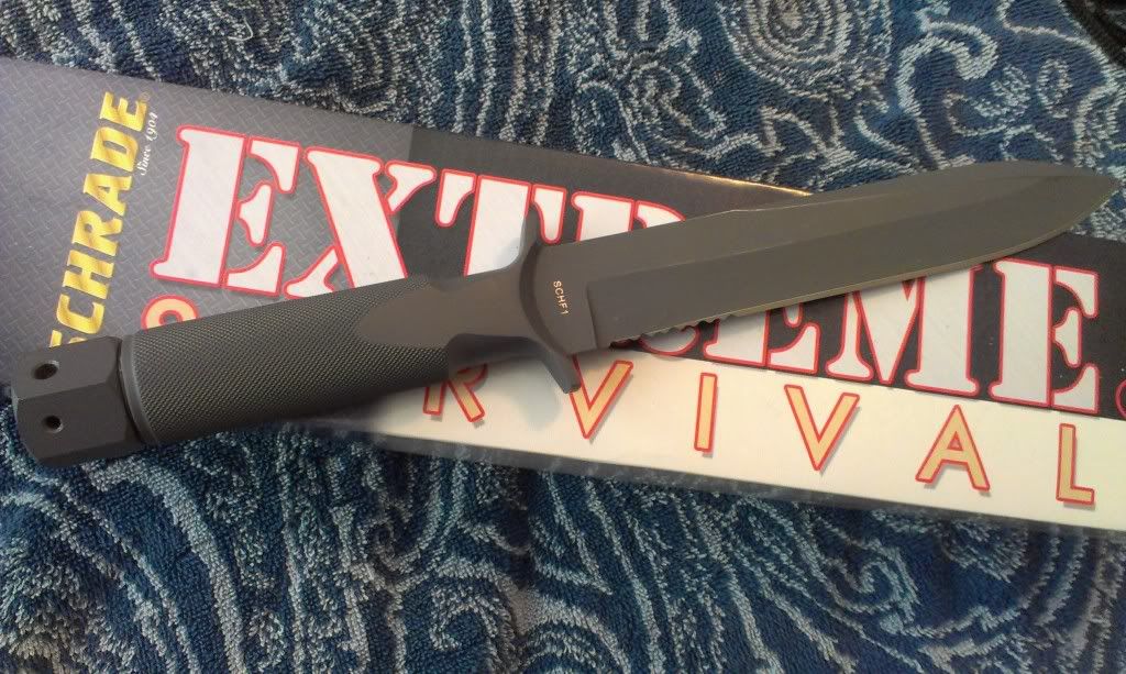

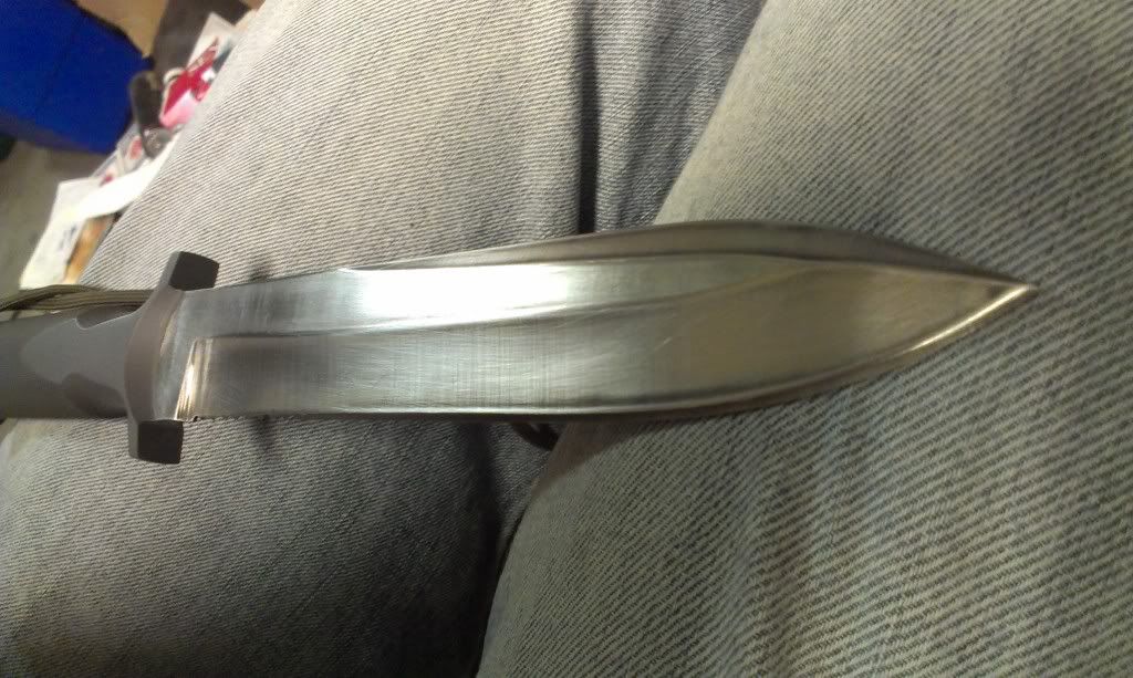

So I've taken a number of pics that hopefully show some things that can help you decide if you like the knife or not. I haven't even used it yet and I can tell you that I love it for $60 shipped!

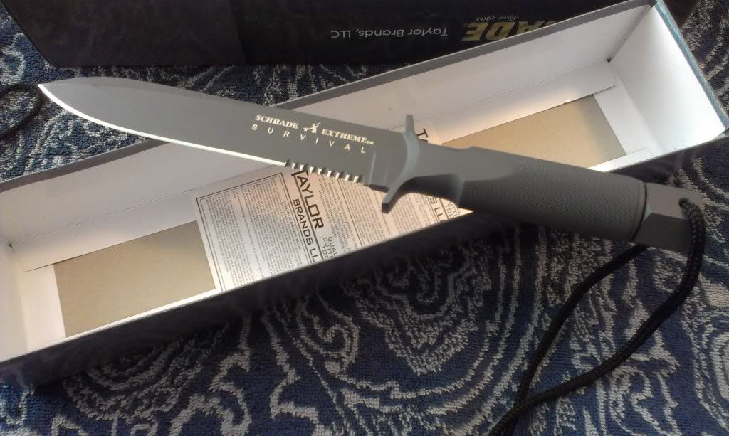

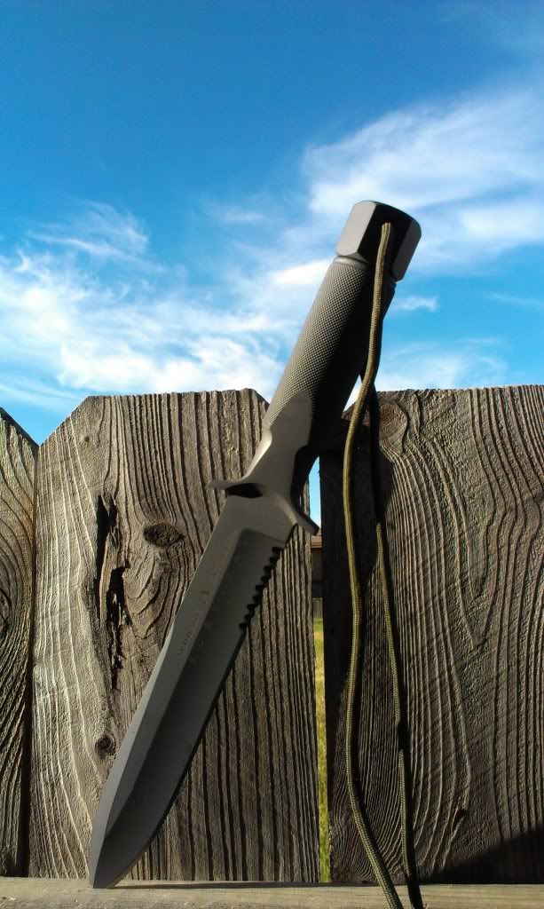

First up are a simple front and back shot. Unfortunately Schrade (Taylor) has not made the big knife (there are multiple versions, clip point, plain edge short blade/handle etc...) in a plain edge version yet as far as I know. The serrations aren't horrible though as they are flat ground. Not that big a deal to me anyway.

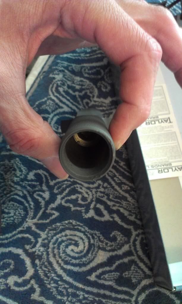

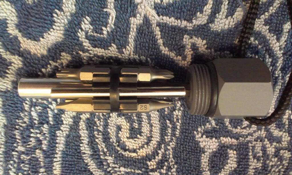

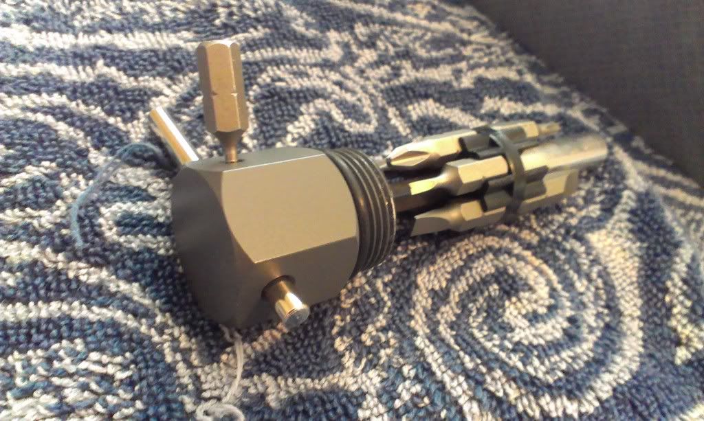

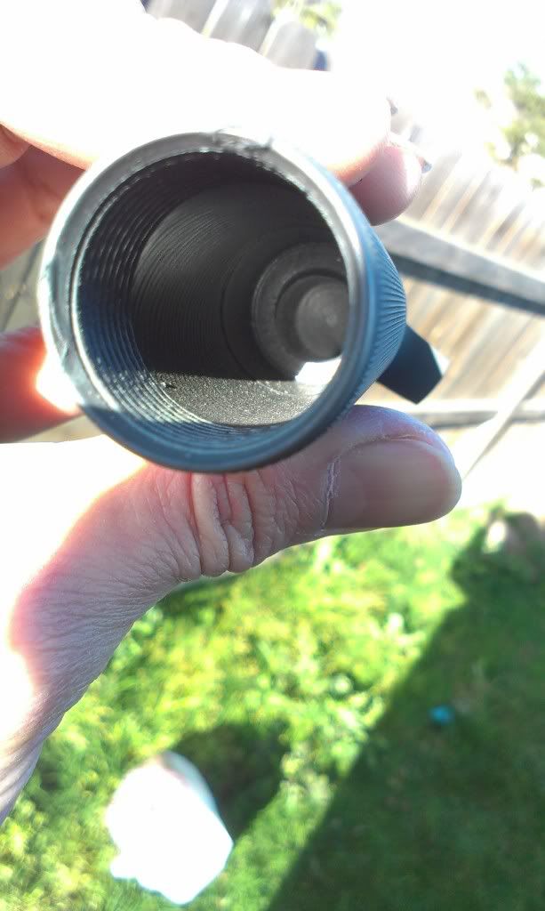

Inside the handle resides a nice screwdriver kit. It's held in by a magnet which is pretty strong. My guess would be a rare earth.
It can be pulled out, which most will want to do. Who needs a screwdriver in a survival situation?

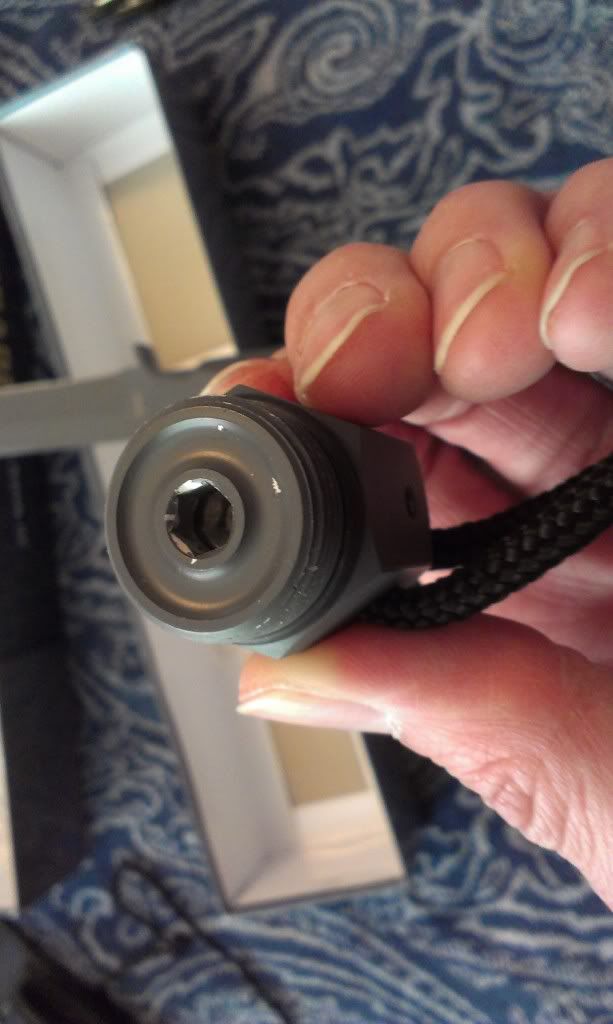

One thing that isn't described by the company and may not be known by every owner is that the kit comes with a bit that fits a set screw in the aluminum cap. Put the included rod through the lanyard hole, tighten the screw and you can get power behind the driver.

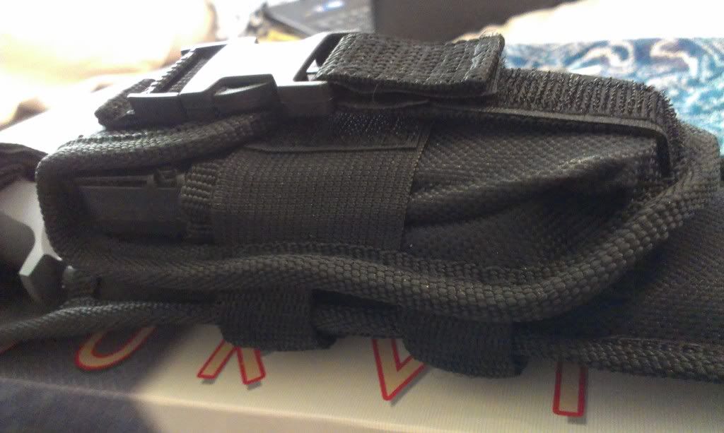

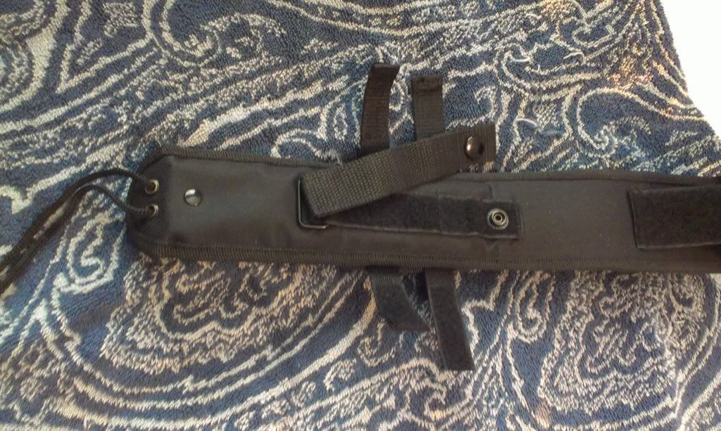

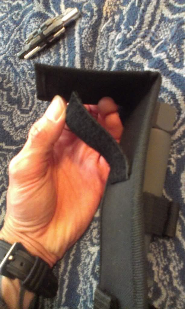

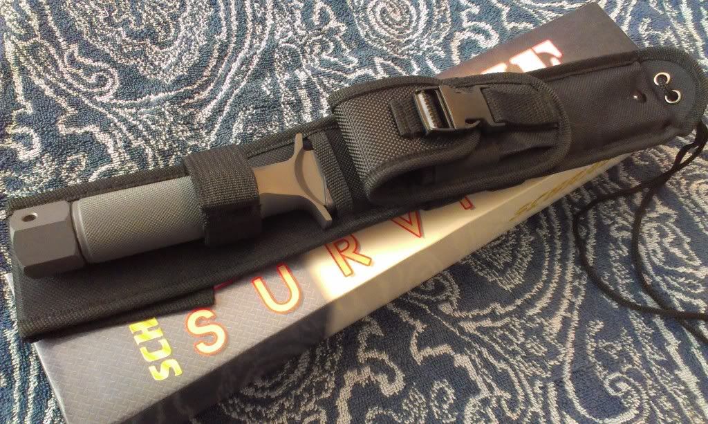

So that describes the knife. What about the sheath? Well, I don't own many fixed blades and don't have a lot of experience so I'll let you judge. To me it seems usable if not luxurious. Many of the features are foreign to me so I just took pics of the straps and whatnot.
Beltloop
Handle strap. Not sure why its adjustable?
Backside options. Molle maybe?

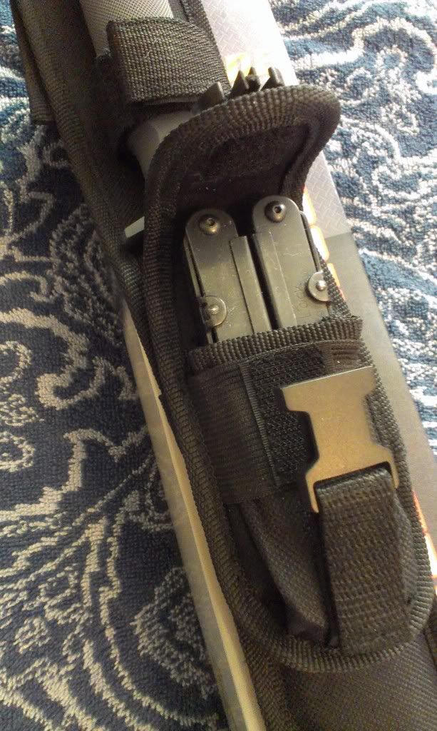

The front pouch I actually like a lot. It has the regular elastic to cinch down whatever you put in there, and the buckle strap is adjustable. That's a full size SOG Powerlock in there.
There's also a length of cord at the bottom, I assume to strap to your leg or something?

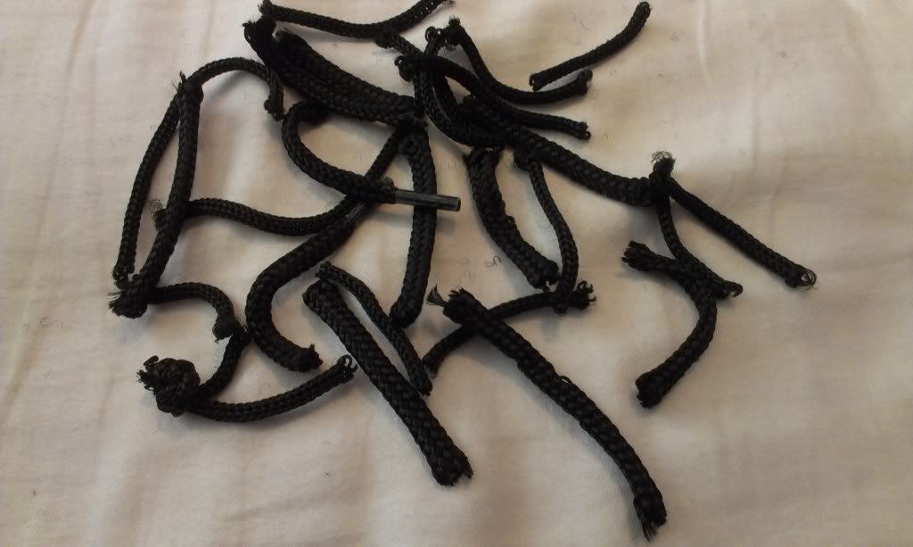

Speaking of the included cord... it's crap. So I used it to check the edge.
Yup. It's sharp. :D I replaced it with 550.

Here are the pics i took with my crappy phone.. I do not have a pROJECT..

I need to track down the dimensions for the Project. I'm wondering if the Schrade is thinner stock. If it is I wonder if that's an indicator that Taylor is not using the same tooling. Not sure why it matters so much to me. I guess I'm just curious.
Yeah I wouldn't use this one as my only knife in a life or death situation, but on the other hand I can't see breaking it. It certainly looks and feels tough. I'm sure you've seen the destruction knife "test" videos. Looks like the Schrade faired a little better than the CR Knife, but I hardly see those as scientific evidence.
One thing that really surprised me about this knife is how incredibly obtuse (obese?) the edge is. Something over 60° (inclusive) is just silly, even for an axe. I doubt I'll reprofile it myself as it would be too much work given the tools I have. I mean, I have files and stuff, but I hate a nasty edge. I'll probably send it to someone. Richardj maybe, if he's willing to touch it. :)

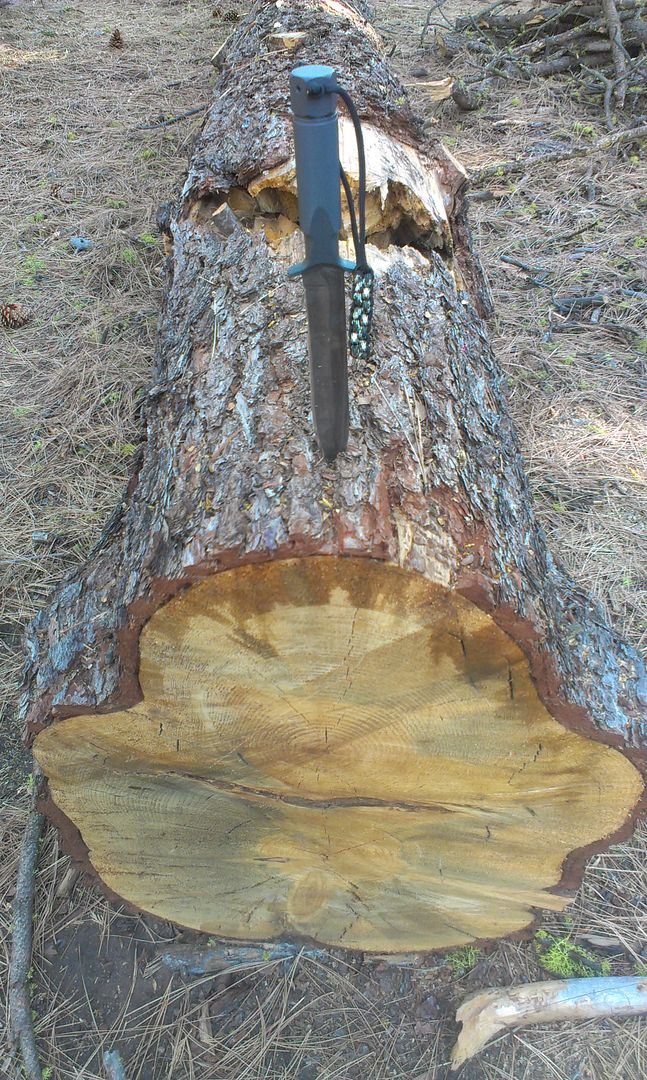

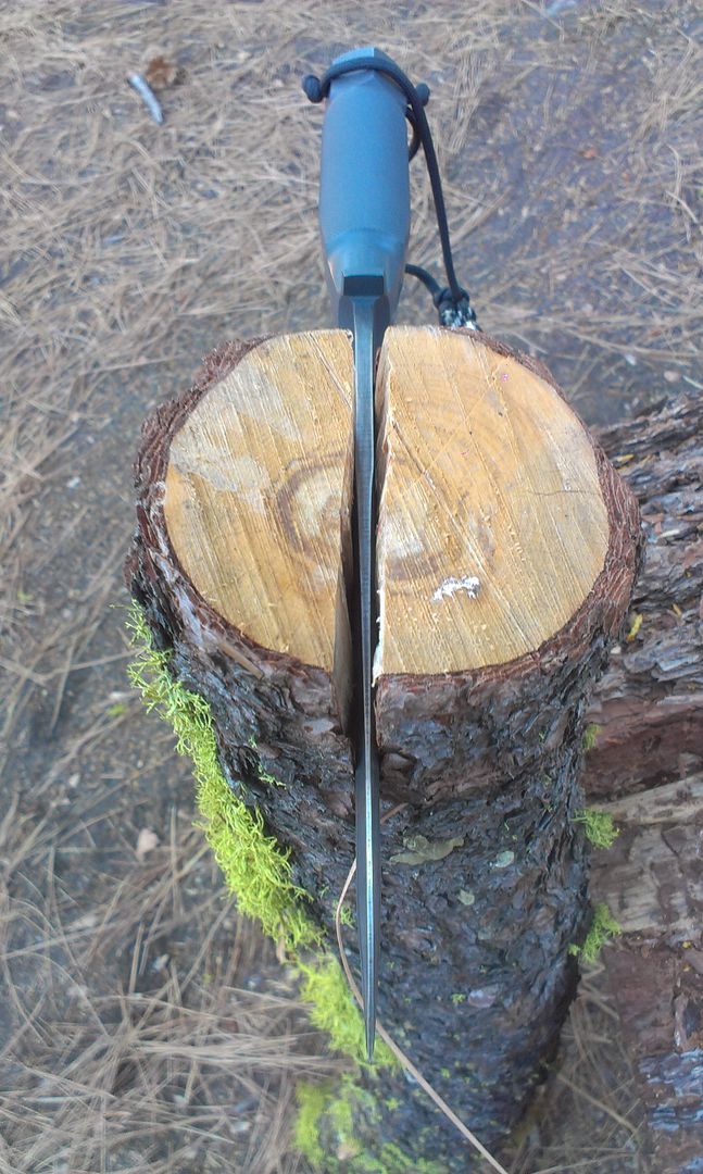

I didn't forget my promise to take the knife and give it a decent beating. I must say that between when I first posted the review and now I learned sharpening on my belt grinder, mostly using this knife since I didn't want to screw up any of my more expensive folders. What I ended up with was a freaking awesome apple seed convex edge that was very close to mirror polished. Being a fairly thick geometry, and convex to boot, it wasn't up to my folders level of sharpness, but it was better than I did with the edge pro, and easily shaved hair and cleanly sliced phone book paper.
On to the pics...

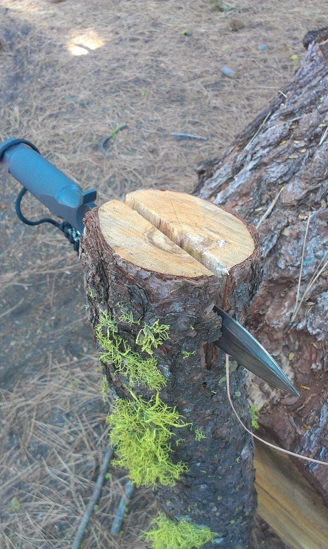

I batoned it through this tree cross grain. The second pic shows what happened to the tree after I hammered the tip in and snapped it out sideways.
Just kidding guys.
:D
Seriously though, it really excelled at batoning, although the thick stock wanted to push the wood apart.
The edge showed no sign of damage, which is what I expected.
It mearly took off some of the polish. It is still quite sharp after beating it through a number of logs, and the spine, even at the tip where the stock thins due to the swedge, shows zero impact damage.
I forgot to take pics after snapping the tip out a number of times. Forgive me, it was freezing! :) Anyway, there was also no damage there.

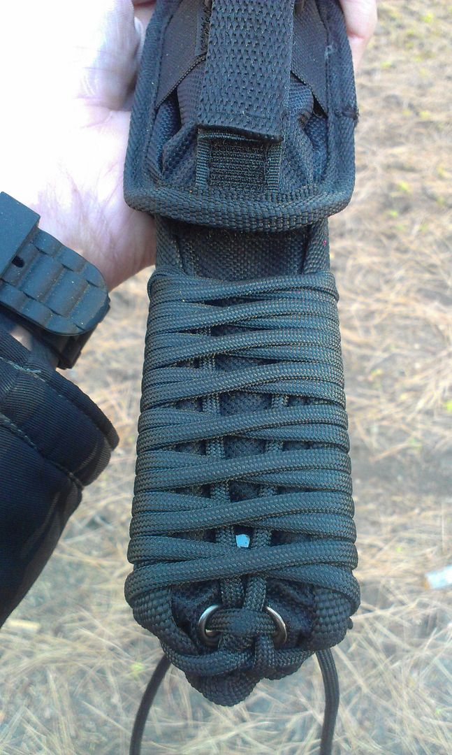

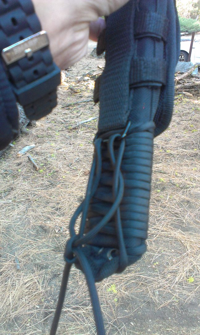

Here's a couple of pics of the sheath with a paracord wrap.

Hey Dax since you own both the Chris Reeve knife and the Schrade could you tell me if the caps on the handle are interchangeable? Thanks in advance!
I could be wrong but I believe that the threads on the CRK are finer.
Can anyone verify this?
