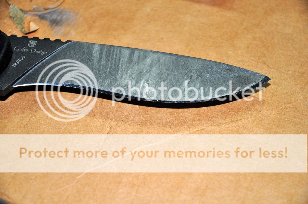

That sharp step where the blade meets the ricasso is not good. It will cause a stress concentration under weak axis bending that could lead to fracture. Now if the blade is a steel such as 1095, and not hardened very high, it might survive OK.
This is one of the things I was talking about when I said they did not have the tooling to do the grind as I drew it. As drawn it had a radius plunge more like the that of the Tibo design I did for TOPS, which is a radius inside a radius...
That said, it is something we discussed, and though it is hard to see in these photos, neither the inside or outside of that grind is actually 90 degree angle. The inside is radiused, albeit a tighter radius than I would have liked, and the outside edge is also slightly broken. It is 1095 steel, and at RC58.
I had some concerns about it initially, and yes it is technically weaker than I would have liked. But the first thing I did was send five of them to different people I trusted to test them hard up to and including slightly beyond what could be considered reasonable expectation of the design. We all came to the conclusion that the only way there would be a failure would be if their was an issue with the steel, and issue with the heat treat, or abuse beyond reasonable expectations. I was a little worried at first when I sent one to Len McDougall for the initial tests after the abuse he put the SCHF9 I designed through, but I wanted to know how it would do. So far of the 4000 sold to date I have seen one failure and I have it, and there was an inclusion in the steel. I just wish they would actually tighten and lock tite the handle screws at the factory, but since so far many folks are switching to the micarta, the fact that they do not may be a blessing in disguise.
