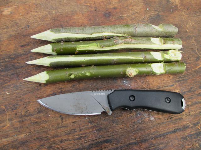

I used this hard today and wore it on my belt all day.
Used it as a Hori-hori to dig up root balls in rocky soil. Perfect blade shape and thickness for this task.
Cut through very grungy carpet that had been outside on the ground for years.
Chopped branches off trees and also trimmed up Ti leaf and pannix.
Cut sisal rope to make load tie downs.
Batoned through a few pieces of wood to make stakes.
Things I noted:
The steel performed well, even after the abuse. I needed to run it across Arkansas stones to remove some chips and rolling...but this was expected from contacting so many rocks. I’m very pleased with the steel.
The handle is VERY comfortable, even when stabbing into the ground.
The scales did start to loosen. I have re-tightened them, they seem ok now. One fastener has started to strip and round out. It might be worth having male/female fasteners with one side being bedded in the scale.
The snap did come undone quite a bit. Mostly from going in and out of my truck all day. When sitting down, the leverage of the knife in the sheath pops the snap open. That said, it was easy to slide the knife in and out all day.
When it’s all said and done I’m very happy with the way this knife is performing...and especially the very low price.
