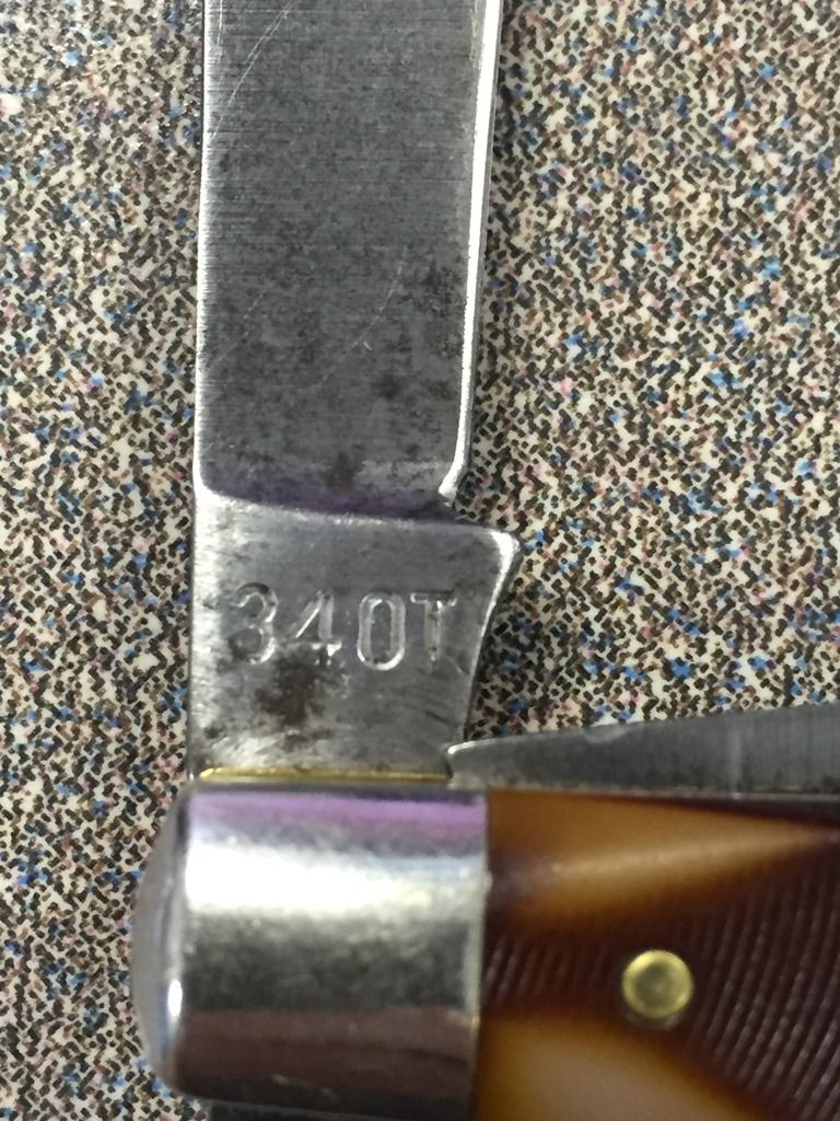

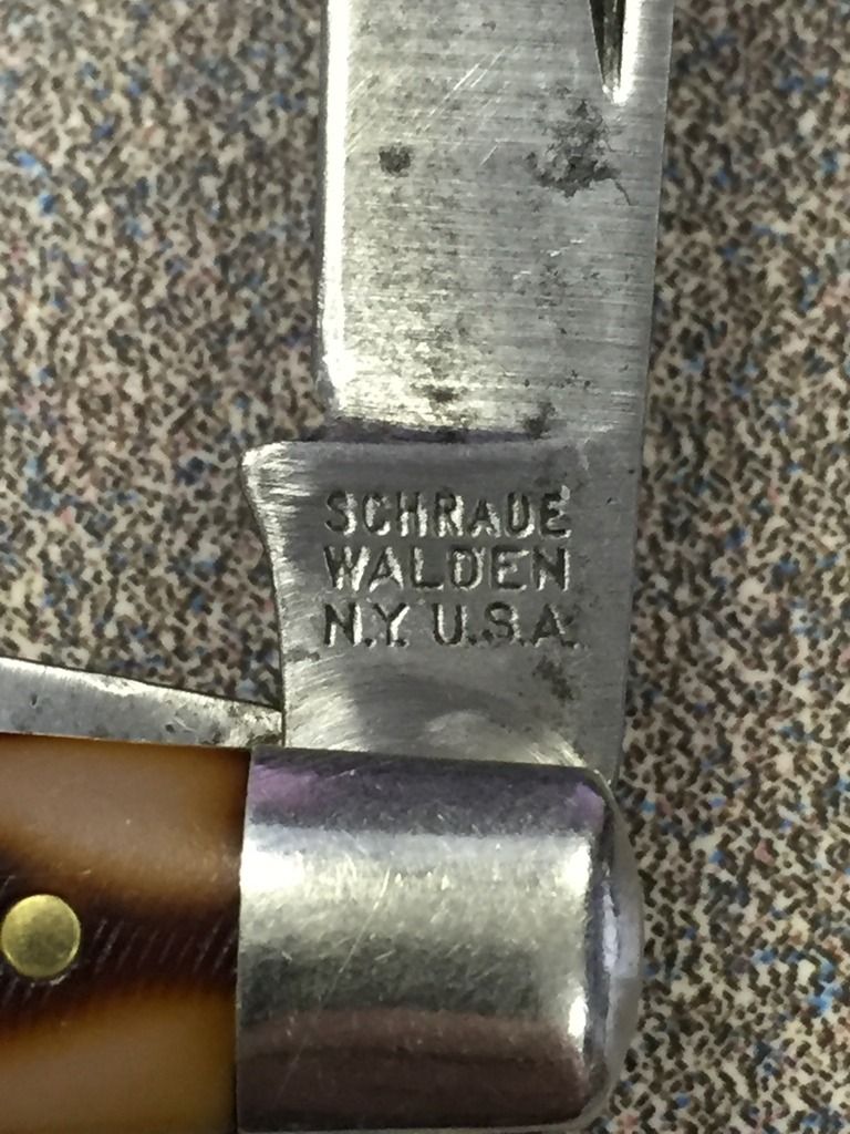

I realize this is quite an old thread but had a contribution to make. In thawk's post, it was stated that the 34OT was not released without NY in the second line. I don't know if this applies only to Schrade, or both Schrade and Schrade Walden stamps. Below are photos of my grandfather's 34OT that I'm lucky enough to have. In addition, I noticed a small discrepancy between my stamp and the stamp chart. My last line reads "N.Y. U.S.A." instead of "N.Y. USA" as pictured. Not sure if it was a typo on the stamp chart or an actual change in the stamp.
