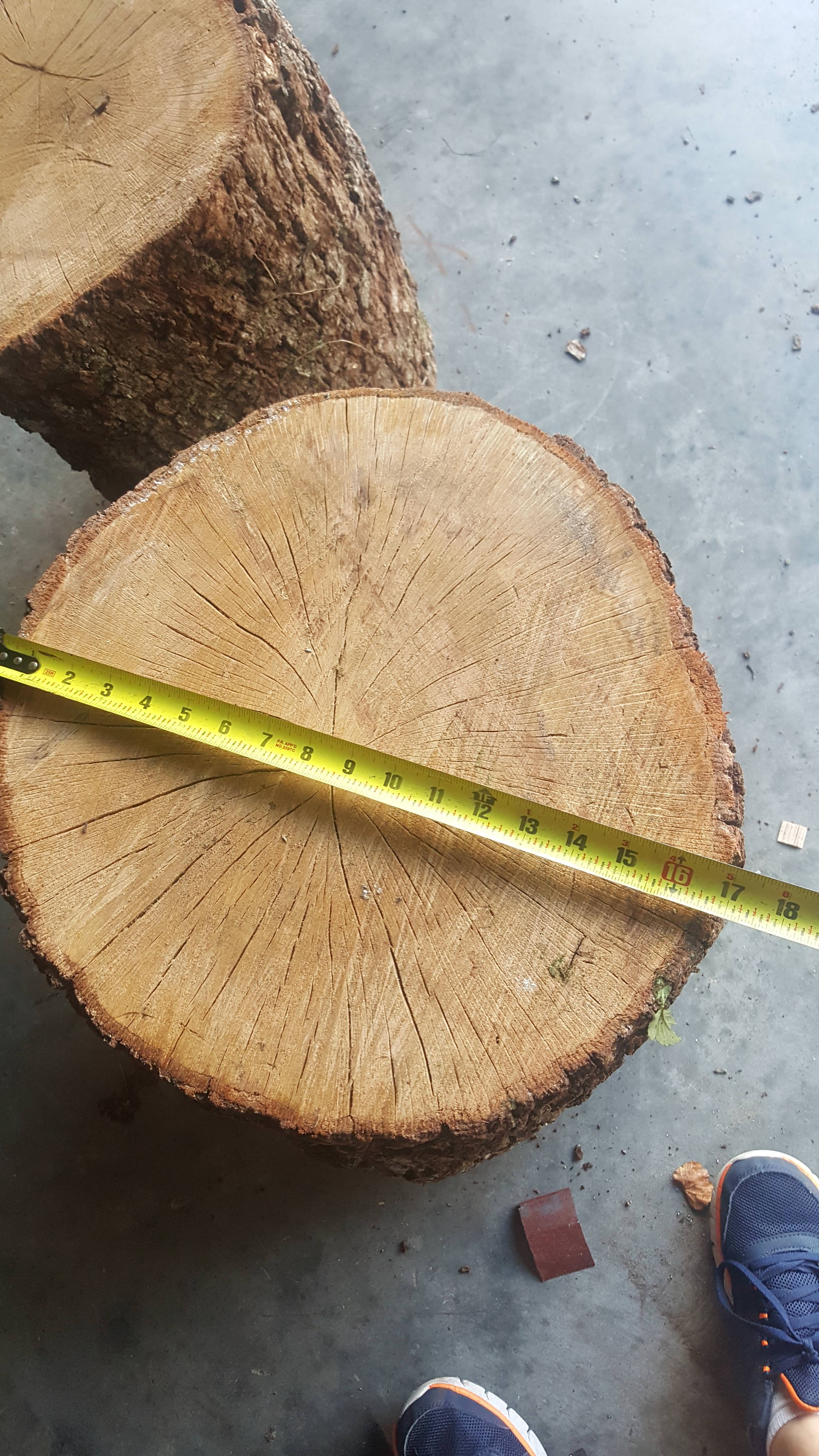

Being in the great state of Florida we are never short on downed trees thanks to hurricanes. Well I bought a piece of 3.25in x6 in 4140 that's been HT to 27-33 for an improvised anvil here it is:

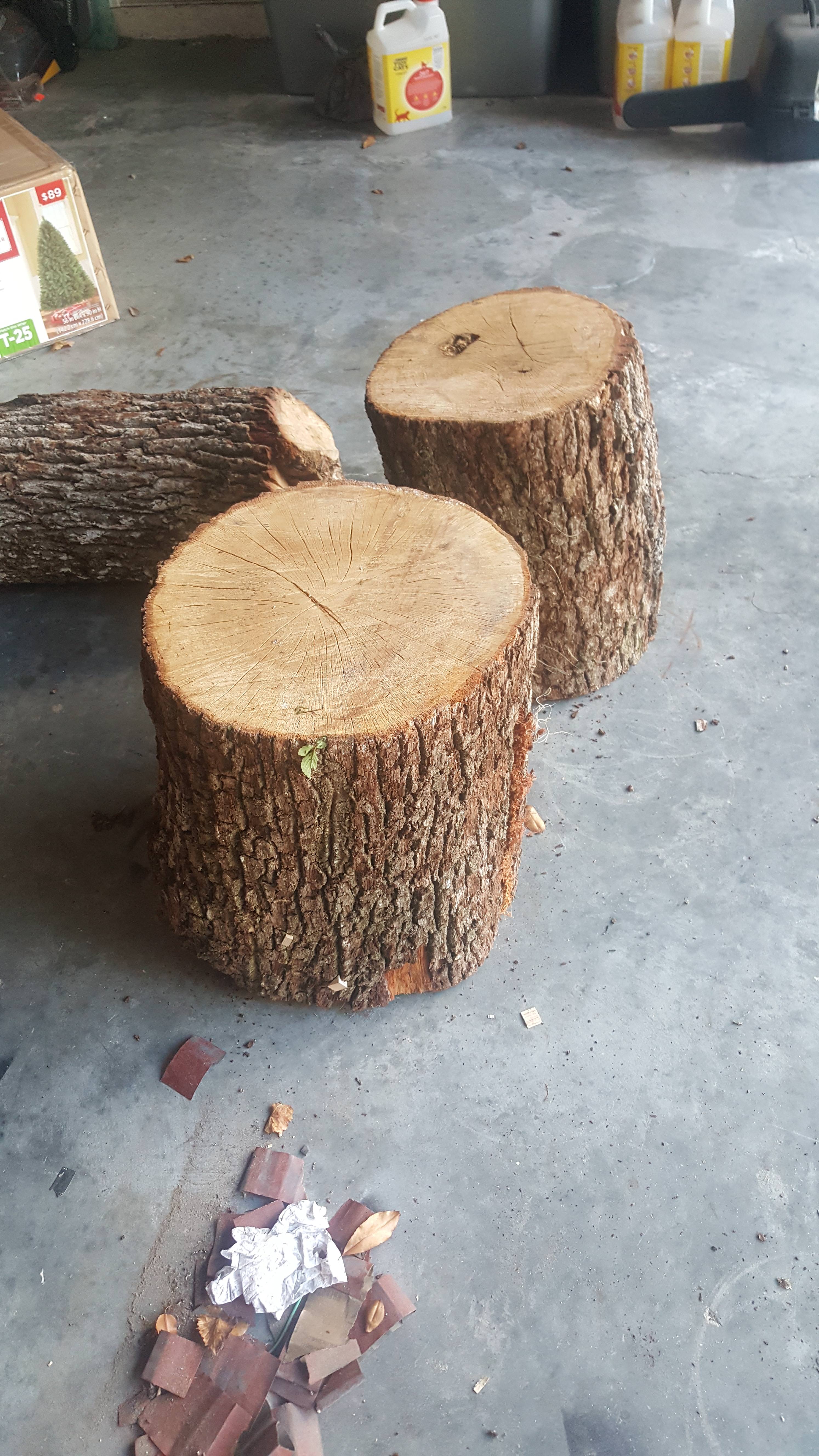

There just so happened to be a piece of oak that was cut down and movedabout 100 yards from my house and I scored this beautiful thing:

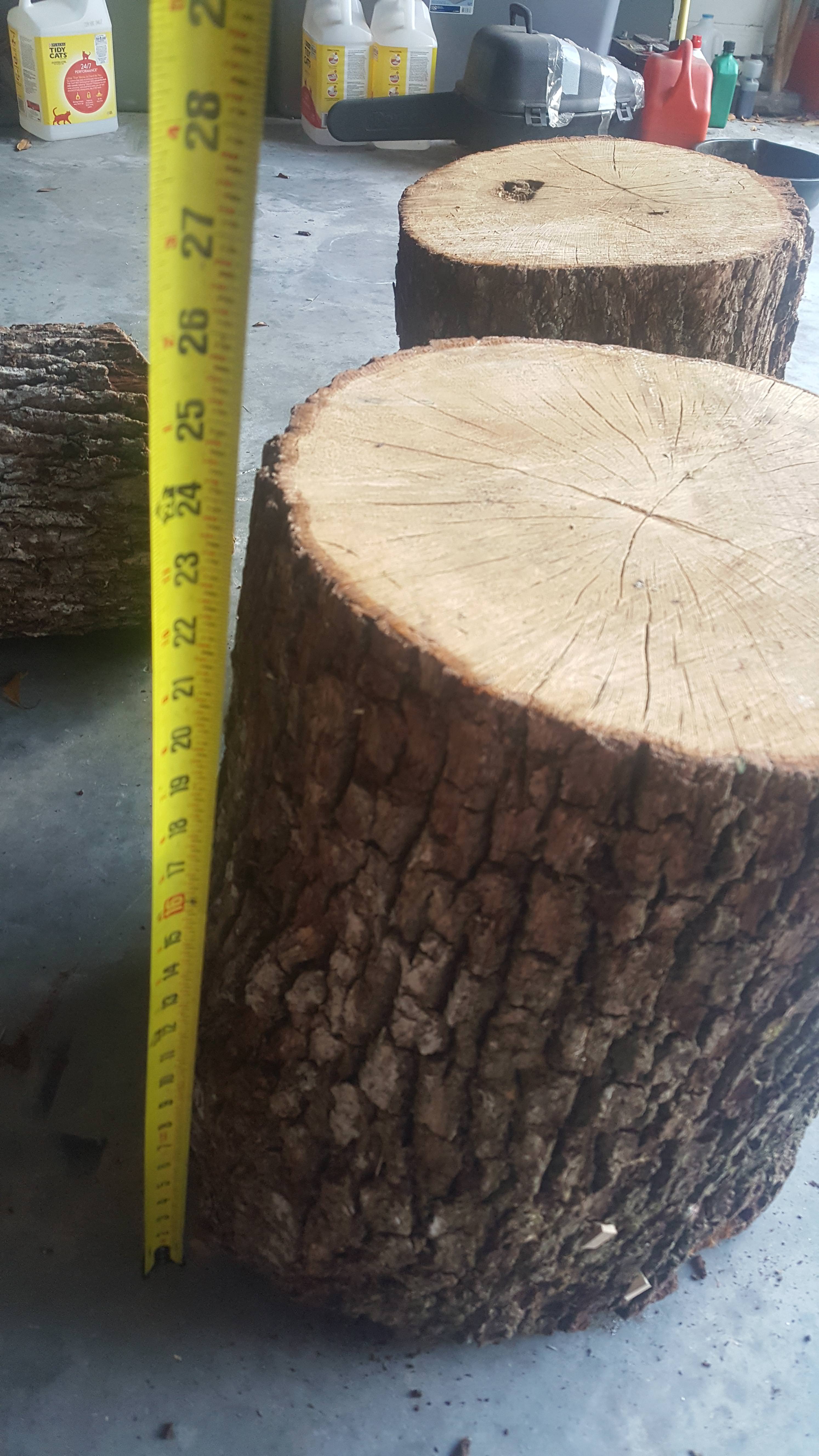

2 issues. 1 it's a tad short I was thinking of placing it on some 4x4 tgat were screwed together as a platform.
3) how should I mount the anvil? Weld a stake and drive it home or weld some angle iron and bolt them to the log?
Pretty excited. To be able to forge soon. :D
You probably should paint the ends of that log no matter what. It's already got a ton of small splits. You don't want to give your anvil a whack and have the log give out underneath it from a big split.
Yeah that would suck. I sprayed it down with shellac bit I'll paint it too
I would glue it down with urethane.
Just happen a few pints leftover from lining a vibratory bin. Glued right, wont come off and wont ring...
Otherwise, suggest weld a few tabs & fit lag screws.
I would've never thought of that. I have some gflex epoxy that would probably hold it better than urethane.
Or I was going to weld a 1/4 plate under the cylinder and lag bolt that to the stump

I think you'll probably be better off setting this in concrete with rebar under it rather than just setting it in this stump. I have a post anvil which is basically just a heavy splitting maul head wedged into a heavy log, and my anvil set in concrete is vastly superior. Search for posts about Rick Marchand's anvil - I based mine on his. If you don't have access to a welder and can't find large steel pipe like his is set in, a box made of 2x4's like mine has worked well so far. But you really want the anvil to act like as large a mass as possible.
Oh I've seen that just didn't know it was his. Just saw @JTknives YouTube of his post anvil. I'll figure something out or just bolt it to the stump
I watched that one the other day actually. I was thinking about using t post hammer an concrete the piece In. But I'm stubborn and really want it on that stump lol
