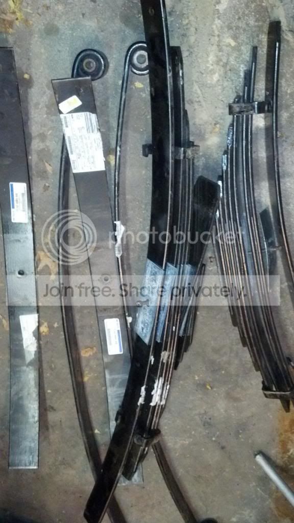

Scored some free steel, willing to share
Jun 12, 2012
29
I happened upon a set of unused (only installed and promptly removed) leafsprings that were designed for an F-550. The springs were installed on a F-250 and taken off when the owner of the truck was not happy with the result. I believe the steel is likely 5160. These springs appear to have been manufactured in the last year or two and were purchased new, stickers still on them.

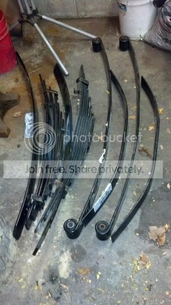

Here's my problem, I do not own a power hammer and can see myself spending the better part of my life making these springs usable to make knives so I am willing to share the spoils of this score. I live in central Indiana, on the west side of Indianapolis. If anyone is nearby and would like some of this, send me a private message and I will share my address. I am also planning a trip to northern Indiana at the end of the year and can take the springs with me if that would work better for someone. I will ship them but will need to be paid for the shipping costs and boxes. I believe I have well over 200 pounds of steel, very possibly approaching 300 pounds or more. If someone is willing to use their power hammer to bring this steel down to a more manageable size, I would happily trade most or all of this steel for a few bars being returned. Here are a couple pictures.
Let me know if you are interested in taking some of this off my hands or if you have other ideas on how I could utilize this product with my limited resources. I do have a 300 pound anvil and a coal forge in addition to a cheap bandsaw. My only other thought was to cut the bands into sections approximately 1-2 inches thick and forge them out from there. Like I said, I could likely spend the better part of my life doing this, although it is tough to beat free steel. Thanks.

What are the average width and thickness dimensions?
I believe it is unlikely to be 5160...almost a guarantee it isn't.
Call it F-550LS or BNTS ( Brand New Truck Springs), but don't call it a specific alloy.
Can you make a knife from it - yes. Can you an as good or better knife from a few bucks of Aldo's 5160 - absolutely yes.
If you have the steel analyzed you would know more about what you have (assuming all the leaves are made from the same batch of steel).
I think you have a good idea with ripping them in half. A plasma torch would be the most efficient way, and I don't think you lose much steel at all.
Forging wide, thin stock into narrower thicker stock has been problematic for me. It makes for interesting etching, but I don't think it's optimal.
Of course, JMHO. I wonder how correct I am.
Well, I guess I have a crap load of F550LS steel which I will be able to use to practice forging and welding. I assume it will make a great chopper, although the edge holding could be suspect. I guess ripping them and then stretching the steel out will be what I start with. I will likely have some of this hanging around my shop for years and will probably give a lot away after I get it chopped up.
The pieces are all approximately 3 inches wide and between 3/8 and 1/2 inch thick.
Big steel=big knives. We've forged several bowies and choppers from leaf springs 2.5-3" wide and 3/8" or thicker. We don't use a power hammer, and very little stock removal. I'd just hot cut it to a rough shape, and forge from there.
