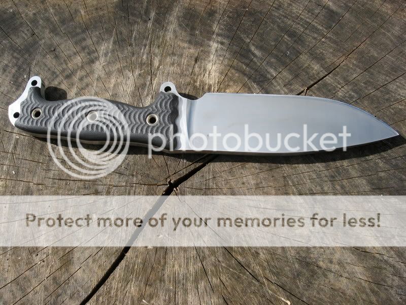

Well here it is. Just a quick 9 minute tutorial showing how I use the Scotch-Brite drill attachments to give my stripped INFI a satin finish. I'll ad some pics tomorrow when I have better lighting. In the future I want to do one from stripping the blade to finishing the satin finish. This vid, however, begins after the stripping is finished so keep that in mind. I hope this helps out with those of you that contacted me with questions. Sorry if I ramble a bit but I am used to speaking to 8th graders.

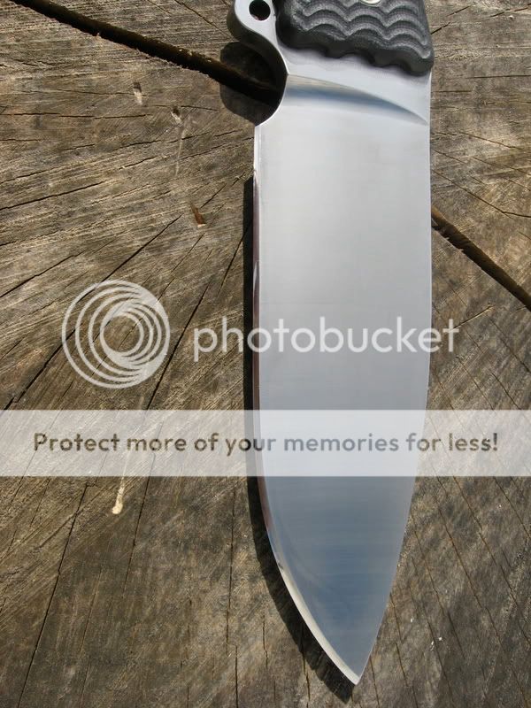

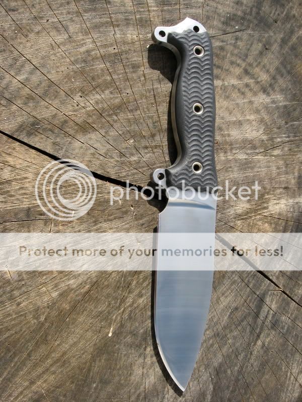

Here are some pics of the aftermath.
