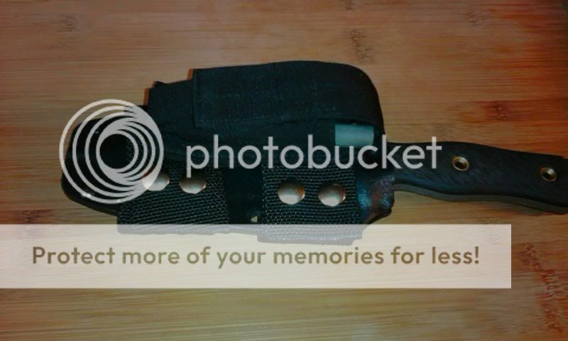

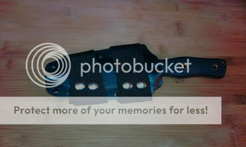

Scout Carry addition to RC-5 Kydex Sheath
Pic added...
this looks like a convenient way to carry a bigger knife like the 5 or 6
Easily removable too... problem with making it fit BOTH hip carry and scout carry without any sheath configuration and remain tight for drawing the knife/resheathing is that they are on opposite sides.
A scout carry right hand draw (RHD) is actually the same facing as a LHD hip carry, and vice-versa.
So, if you use the stock belt clip attachment the clip itself will prevent you from clear access to the knife handle. This can be fixed with a high-hip carry, but with an RC5, the glass-smasher pommel will bruise your side in the best-case scenario, worst case involves your blood and medical care! :-)
I studied all sorts of sheath designs and stared at my knife for hours with this riddle... it's the best I could come up with - if you can offer any improvements or suggestions, they would be quite welcome - that's how this community works!

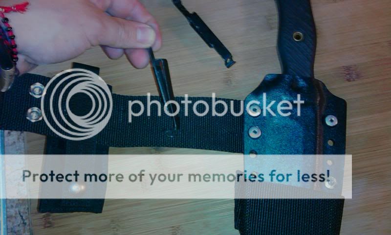

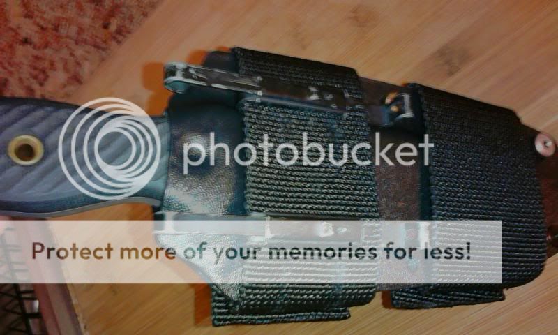

Update: New mod to straps
1) Put in brass grommets for durability
2) Changed firesteel carrier - swapped to LightMyFire Army for my sheath-carry. It's now in a section that tucks behind the strap when fastened to the sheath, pinned with a single Chicago screw. I had a Firesteel.Com Armageddon that is now on a small EDC pack.
3) Added additional set of holes on backs of straps so I could "choke up" the strap for narrower belts. The weight of the knife held it in place pretty good, but this really keeps it tight for 1-handed draw and re-sheathing.

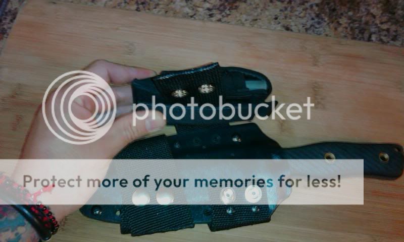

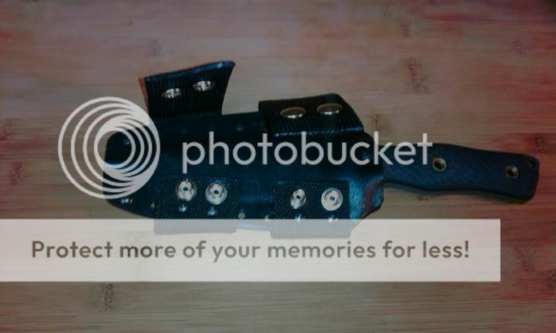

well after watching tarditi's set up i went to the local rei pick up the snap kit and got bussy !!! 1 hr later here's what i end up with ...
the greatest thing is that there's lots of ways to attach pouches for multi tools or in my case fire starters and sharpening rods
And if for some reason i have to do side carry i can just add some clips and ready !!
Thanx again for the great idea tarditi ... next round of beer's on me !!!!!!!!!
Reymuerto,
Great innovation there! I like how you made yourself a modular system to accommodate other piggyback pouches and ALICE clips, too!
