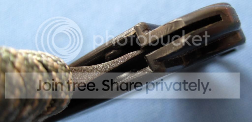

Speaking of Izulas, I have my Scrapivore in a leftover Izula kydex sheath and it fits great in there.
"Speaking of Izulas, I have my Scrapivore in a leftover Izula kydex sheath and it fits great in there."
...cool ! I've got an Izula 2 in my car's emergency bag..... Nice to know you can switch things around:thumbup:
I should clarify here a bit, the sheath pictured above is a kydex one for an Izula but the design makes it a tighter fit than the standard plastic Izula sheath would be. The kydex wraps around the the shoulder on the Scrapivore and has to separate a bit to go in/out. The Scrapivore will fit in the plastic sheath but it isn't very secure in there. The plastic one doesn't close around the Scrapivore.

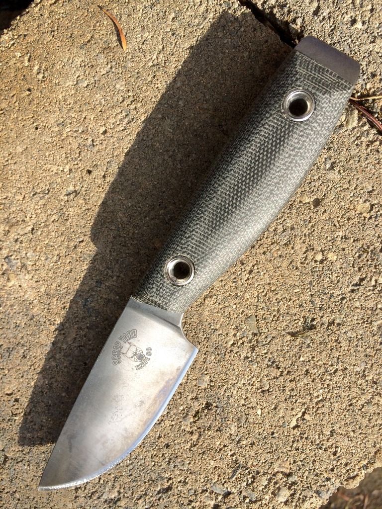

I had a whole bunch of screws and barrels that I ended up giving away, as I've found I prefer the tube rivets. I get the 1/4" stainless tube for free, and with a drill and the flaring dies it is really easy to install and remove the rivets.
