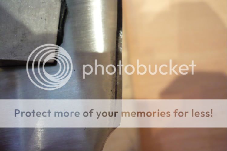

Remember to coat the edge with a marker pen and use a magnification loop to see how the metal is being removed.
This lets you know during the reprofile that the stones have gone to the edge pinnacle consistantly throughout the whole edge. I say this because often by the handle/ricasso you need to take a little more metal off than elsewhere to give a uniform edge angle where the stones have fully taken the edge to a pinnacle.

...You need to do some accurate measurements...

I have a quick alternative which I use with my DMT Aligner set, similar to the Lansky set. Tools required: protractor, indelible marker (preferably Red or another bright color), aligner kit, knife.
1) 'Paint' the entire edge bevel of your knife with indelible marker (as you mentioned)
2) Clamp knife into device and set rod-apparatus such that the hone contacts the knife edge at an angle approximating your desired bevel angle (esp. if reprofiling). Use a protractor to show what the set apex angle is at various locations along the blade edge (as the hone-arm swings from the clamp), and decide whether you are satisfied with this angle or not. Adjust hone angle or clamp position as desired.
3) Once your angle is set, lightly run the x-fine hone along the entire edge of the blade - the idea is to see where the hone is contacting the edge via removal of 'paint' with minimal removal of metal. If 'paint' is removed along the shoulder but not the edge, your set angle is more acute than the knife's angle and you'll want to either adjust the angle setting of the device or start with a coarse stone to reprofile the edge. If 'paint' is removed from only the edge, your set angle is more obtuse than the knife's angle and you'll want to either adjust the angle setting of the device or use a fine stone for the minimal metal that you'll be removing. If the location/amount of paint removed on the initial swipe varies along the edge, this indicates a difference in the geometry of the knife's bevel and the manner in which the device sharpens it. You can reprofile from the position you have the clamp set or move it to another position along the blade length, etc. Whichever choice you make, make a note of where you locate the clamp and try to be consistent about clamp placement each time you resharpen on the device.
4) Proceed with sharpening at desired coarseness, noting progress and consistency via removal of the edge 'paint' (which you can reapply as desired).
The DMT Aligner Kit is easy to carry into the field. But if you are confident enough to freehand, V-bevel or convex, all you need to keep a consistent angle is that indelible marker. Simply 'paint' the edge, place your hone at the approximate angle, and make a light pass. Adjust your angle as needed based on the removal of the paint, and work until you've achieved the desired level of polish.
The difference between your post and mine is that yours is dependant upon retaining the angles set by the maker ...
Using a marker pen to determine where the stone makes contact with the edge and then altering the contact point to bring the contact to the pinnacle so that it replicates what has already been established .... then fine .... that works ...
