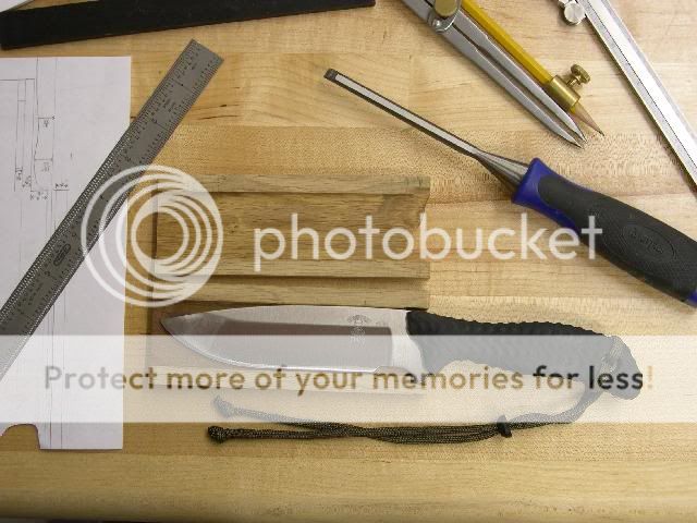

I really liked PeterPHWS's removal of the spine bump on his S5 LE (thank you, sir), so I did the same to mine. Mine was a user from the git-go, so the removal is no great loss. I left the shoulders where I ground off the hump very sharp for striking sparks from firesteels. I realized that with the bump gone, making a cover for the S5 would be a lot easier.... so I made one up in oak wood and brass rod that will offer more protection than the cardboard cover it came with.
I did the hokey rare-earth magnet trick to keep the cover from falling off. Just below the piece of oak with the round magnets in the picture is the scrap of walnut veneer I glued in to retain the magnets and keep them from scratching the blade upon insertion-withdrawal.

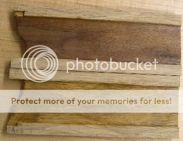

Here is the interior of the two sides of the cover sealed with a coat of Daly's Benite wood conditioner. Note that the edges of the two pieces that will eventually get glue applied to them are still raw wood.
Here is the S5 LE laid inside the half with the walnut veneer covered magnets to show the position of the knife after everything is assembled.

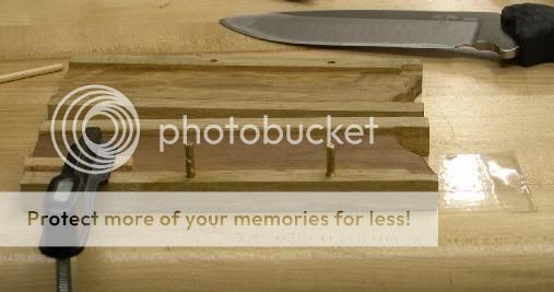

Here I am epoxying the 1/8" diameter brass rod sections in place. They are to keep the two pieces of oak in place during glue-up (no sliding around with the glue acting as lube between the pieces). They will also serve as an edge guard should the edge ever wear through the inside part of the glue joint. The shine is from the cellophane tape I used to keep from epoxying the cover to the table. ;)

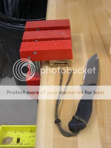

The glue-up in the clamps.

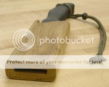

The final cover -- the open end to make clean-out easy.

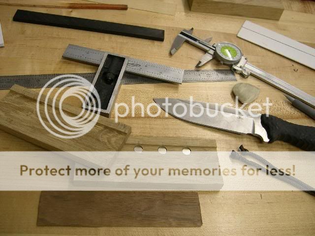

How did you create the raised sides/channel in the oak? They weren't applied right? Its two solid halves of oak?
Correct -- it is two solid halves of a single piece of wood.
I resawed a block of oak in half, then took successive passes dado'ing into each half on a router table. I used a 1/2" wide router bit set just a hair over 3/32" deep (x2 equals the 3/16" thickness of the S5 blade). I kept moving the cut sideways until the dado groove was as wide as the blade is high plus a smidge (very technical term :D ). This created a very shallow U-shaped block of wood from each half of the original block of oak.
I then aligned and clamped the two U-shaped pieces together to drill the holes for the 1/8" diameter brass rod that would keep them aligned while gluing. Epoxied the rods into one of the pieces. Used the rods to keep the two pieces in register while I bandsawed the mouth for the handle cutout into them. Then apply glue to the mating edges of each U-shaped piece, dab a little epoxy into the brass rod holes in the un-rodded piece, and clamp. Shaped on router table with round-over bit to radius the outside corners and apply finish.
