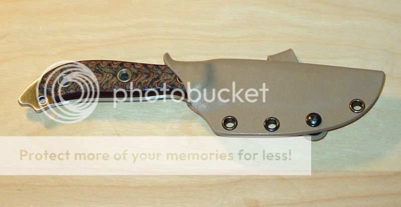

I think it depends too on the style of the kydex. Some makers tend to craft sheaths that depend on a little bit of blade friction. Others tend to rely more on friction around the handle area.
Here are a couple of sheaths which depend mainly on handle friction. I haven't seen much, if any scratching, on the blades from the sheaths, although I did coat both blades with a healthy amount of RemOil before using the sheaths with any regularity. The first is by Tom Krein; the second is a Sheath Mechanic sheath.
I did see some scratching on my BATAC LE (in a Spec-Ops sheath) pretty quickly. I actually sanded some of the scratches out with 600 grit paper, oiled the knife pretty well, and have seen much less scratching since.
My point? Oil the knife well the first few times you use the sheath and it'll lessen some of the scratching--as long as you keep dirt/grit from getting down in the sheath. In that case, the dirt will stick to the oil and then, bingo... more scratches.

Tony, you didn't steal that pic off of Bad Mojo, did you? :p
Nice sheath. I like the way the top edge forms a curl to fit an index finger.
