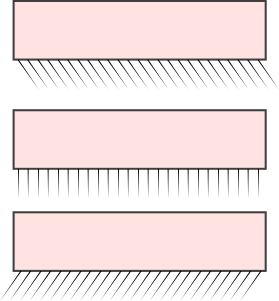

Hi, see 1259287-Scratch-pattern-when-sharpening
and consider this image,
when you're slicing toward yourself,
which scratch pattern will have more slicing aggression,
which one will bite first?
Saws have similar idea, some are pull stroke saws (teeth angled toward handle), some are push stroke saws (teeth angled away from handle), some work equally well on both push and pull stroke (teeth straight down, not angled).
Thanks and yep those are similar to what I was thinking/trying to say, for the very small teeth on the blade, the perpendicular would care not so much as to which direction you tried to cut, it should be quite aggressive, where the other two might cut better depending on the motion you use.

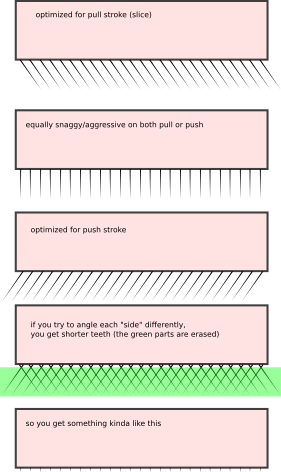

I have an idea,
based on the idea of crossing the scratches when deburring using double angle edge leading alternating passes,
if you do perfectly even alternating passes,
it makes for shorter teeth,
which might translate to more edge retention on a push cut
and less aggression on a slice , equal for push/pull, like straight non-angled teeth
But if you're not even, if one side gets longer passes or more pressure or ...
then you get teeth angled that way, but only half as many,
so slicing aggression is half of what it could be
making smaller saw teeth in green
