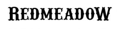

I also have a stencil maker coming from Martronics. One of the biggest things I always heard about etching was the cost of stencils, which are mainly custom made. That always steered me away from the process. With the ability to make my own stencils though, I can have a few different sizes on hand, change fonts, etch designs, dates, names, c......s and things like that, at least that's the goal.

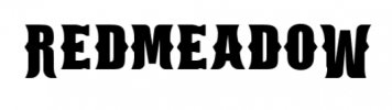

I'm going to try to fill the etch with some Birchwood Casey bluing see if that gives better contrast.
Agreed!
I'm just struggling to make it crisp, get rid of the blurry stuff.
Well I'm a complete etchnoob but we'll see what we can do. I've always heard the stencil has more to do with it than the machine.

Absolutely no clue what I'm lookin at here, but the Mark 440 Stencil Maker is here.
Everything was packed extremely well and very nicely organized. I like to see that attention to detail.
Maybe you're getting the stencils too hot. If you have it turned up too high or hold it on too long it will heat up and soften the adhesive on the stencils. This can cause the edges to lift creating fuzzy edges
On my homemade machine, if I take it slow, and allow time too cool it comes out crisp and clean. I do it a few seconds at a time with a pause to cool. I also dip the pad in the etchent often too
