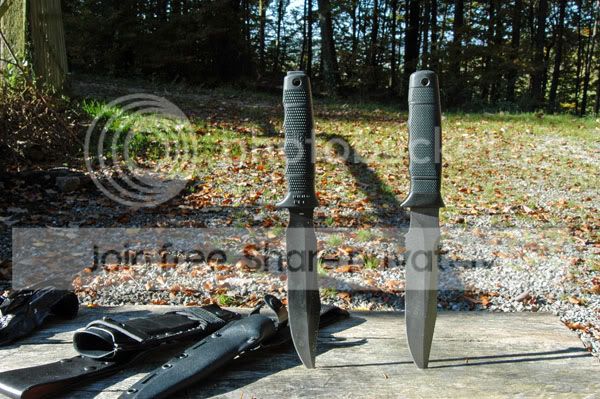

Let's do a short review of the Seal 2000, seki made and the Seal Team Elite, made in Taiwan.
Chopping
Well, while both were not primarily made for chopping, they both do the job.
The bulkier handle of the Seal 2000 feels better for this and gives more control. The Seal 2000 is heavier too, so you get more bang for chopping.
The handle of the Seal Team Elite is more aggressively textured, which gives you a perfect, secure grip. However, when chopping you better wear gloves, or you palm will suffer.
Overall: Both are not bad for chopping, but the Seal 2000 is certainly the better choice here.

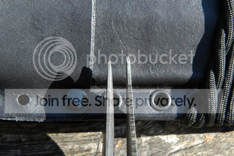

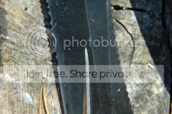

Tip stability.
Simple test: I stabbed both knves in some dry hard wood and forced them out laterally.
First of all, no breakage. However, a second look revealed a significant bending of the tip of the Seal 2000.
The Seal Team Elite did perform with no bending. So I repeated the test for the Seal Team Elite more forcefully. The result was a minor deviation of the tip. Both tips could be reestablished by simply repeating the test in the opposite direction.
The Seal Team Elite clearly appeared to be thougher here.
Should they bend at all?
Keep in mind, these were designed as fighters, with pointy thin tips for penetration.
BTW: penetration.
I tried to stabb the tips of the knives through an iron sheet, which worked well. However, the tip of the Seal 2000 was a bit blunt afterwards.
The tip of the Seal Team Elite kept stable, even after repeating the test.

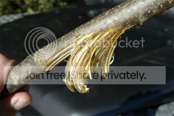

Both knives are equally good for making feathersticks.
Overall:
The Seal team Elite is lighter (hollow grind vs flat gind on the Seal 2000), the handle is thinner (which I prefer, except for chopping), the grip is perfect, the steel is stronger. Both knives were shaving sharp in the beginning. Edge retention was good with both knives, with the Seal Team Elite being significantly better.
The Seal Team Elite is for sure the better fighter, and in my opinion the better overall knife.
Except for chopping it outperformed the Seal 2000.

Tip stability.
They both went into plastic deformation, which means they got permanently weakened even if you were able to flex them back.
That said bending is always better than breaking.
