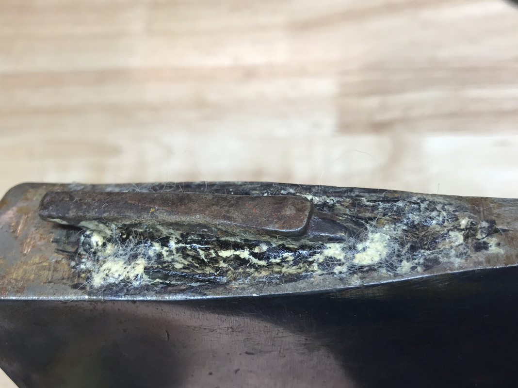

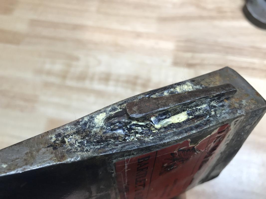

I tend to render
and for particular application, bleach
the difference is apparent
Maybe the hair is part of the juju imparted to the mix by the camp Shaman. Adds to the charm!
