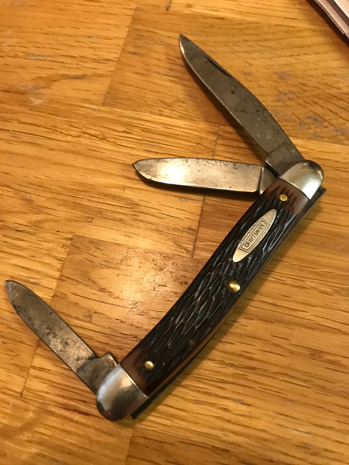

I just picked up a neat two blade Sears Craftsman.
Reads: Sears Craftsman U.S.A. 95222
The other side says: Stainless
Can anybody tell me:
--who made this for Sears, what company?
--what steel might this be?
I have a couple of Craftsman stockmen, and I too think they (and yours) were made by Schrade USA, so probably 440A stainless.

Your particular example was made by Camillus, and Baer had some blank Uncle Henry shields sent over from the Schrade buildings. The tip-off is the visible bolster pin. When made by Schrade this pattern would have used the Swinden system, with no visible pin. At this point in history, Baer mostly controlled Imperial, Schrade and Camillus, and contracts, parts, knives, employees, etc. were traded around on a regular basis within that system.

Thank you so much. Since it's Camillus, what would the steel be?
That might not be easy to answer. Camillus and Imperial Schrade used 420C and 440A at various times, I believe. Someone will know more than I.
No yours are definitely Camillus made there Black Mamba.A dead giveaway is the spey blade.Secondly is the swedgework which Schrade Cutlery didn't do,but Camillus did...Schrade ground the shoulders off the clip-point's blade spine on their stockman pattern up until the early 1980's.

Interesting information on the different makers, but mine are both Swindon key construction (no visible pivot pins), which I thought only Schrade used.
Yes, David Swinden of Imperial Knife Associated Companies (Schrade being one) filed for the patent in January 1960.

This is my daughters EDC knife. All the research I've done shows it to be made by Schrade in the late 60's - mid 70's...
Clay
I've looked and can't see a pin on the bolsters, so I believe this little one was made by Schrade.
If that's a Craftsman 9473 which it appears to be, it's made by Ulster as its an Ulster 89 rebadged for Sears.
