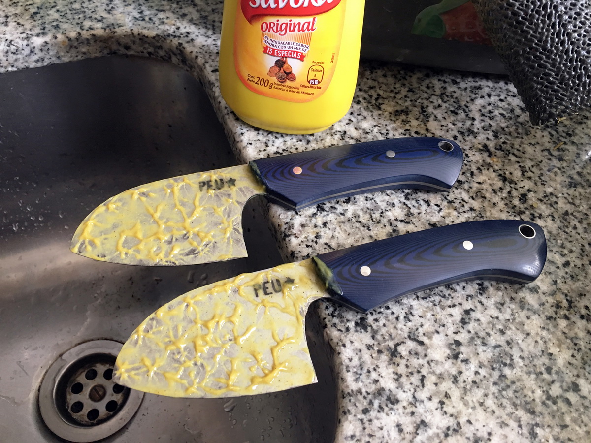

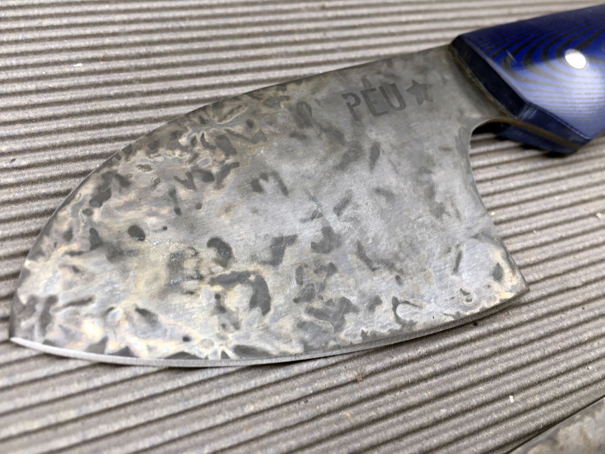

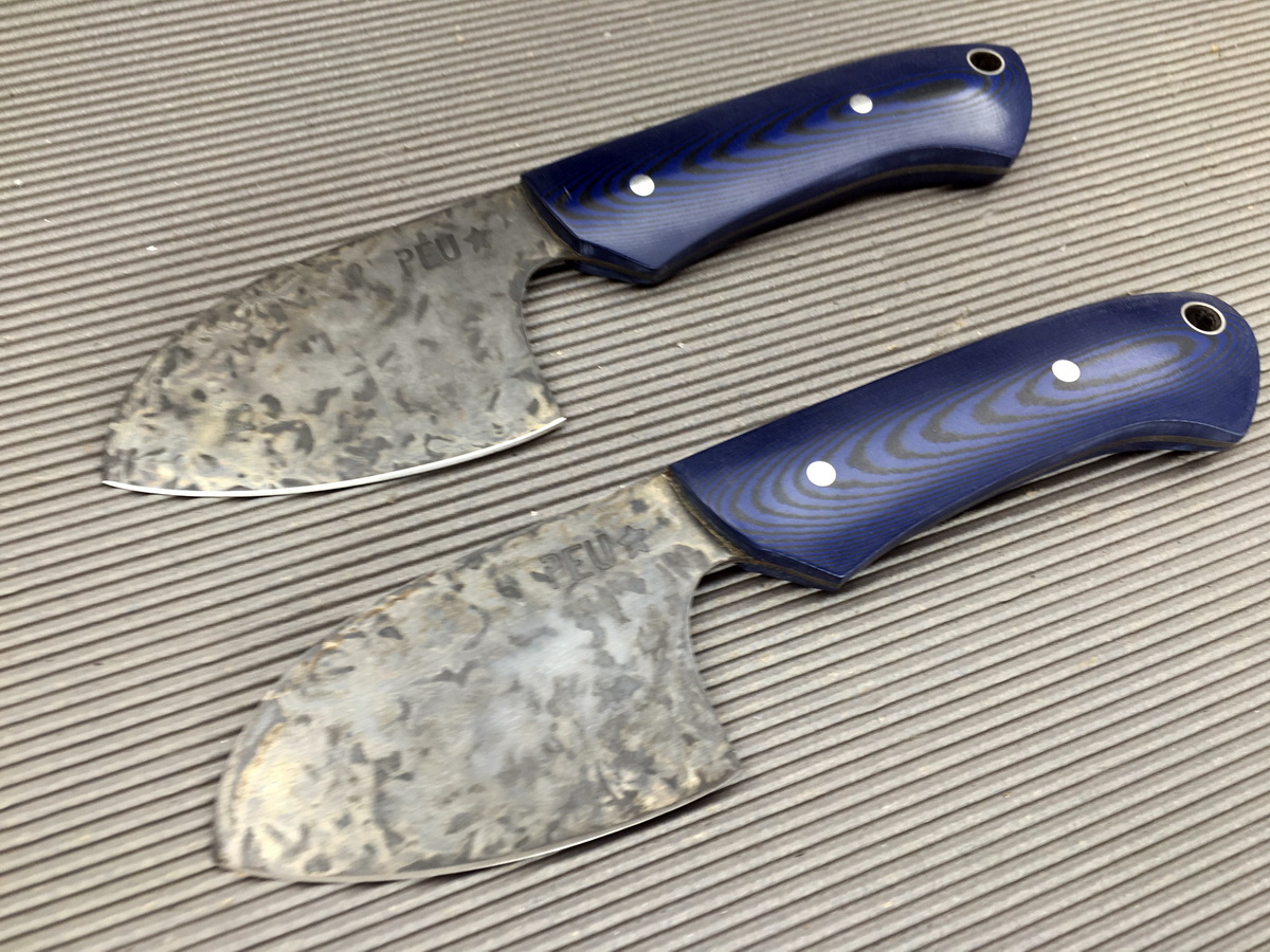

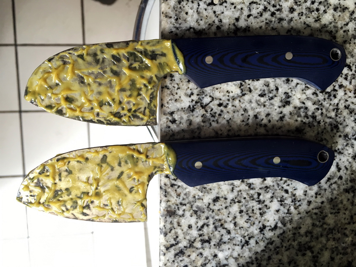

Yesterday I seasoned a couple of knives... :D
Pablo
Not exactly what I am after Pablo, but interesting never the less. That little knife of yours coupled with a couple of requests I've had inspired one of my latest kitchen knives. :)

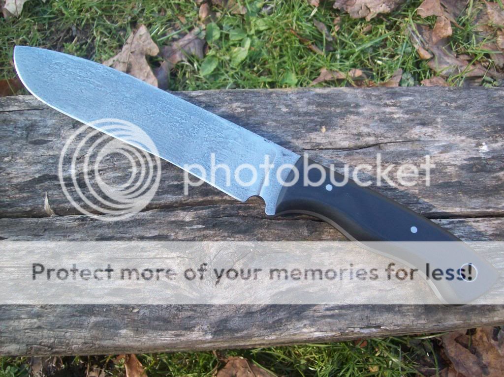

Heres an example of the gun/bleach method..Just finished regularly, because the etch is aggressive it dosnt need to be taken to a fine grit..
