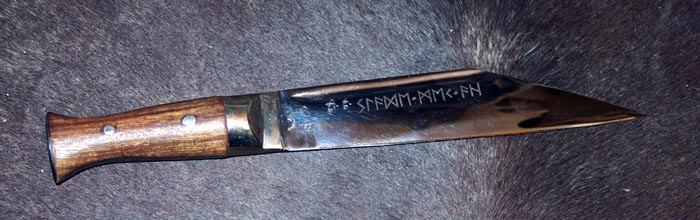

For those going "Huh?" Check this past work out, the HI seax:
'SHER-MEC-WOERHTE' (="Sher made me")
Photo/text credit: Beoram
'SLÆDE-MEC-ÆH' (="Slade owns me")
Photo text credit: Beoram
