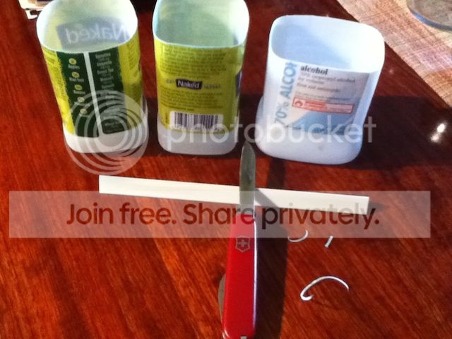

Just a photo and then back to the problem at hand.
While the storm was going I cut up some little bins to use at work.
I used a SAK that is like pretty much flat ground to the edge. I don't know what the angles are but think well less than 10° per side. These were a little dusty; stored under the crawl space for like ten years. I cut the tops off and trimmed the ends square. The knife hadn't been sharpened in a while (I use it at work to precision cut soft rubber tubing, thick wall ~ 2inch diameter. I keep it mirror and hair whittling when I sharpen it.
I figured after cutting this harder plastic I better check the edge.
It was easily shave sharp.
About three super light strokes on the Spyderco Ultra fine rod and it was back to hair whittling.
The edge did not role or ding at all that I could find. Shaved both directions before I touched it up.
I would think the trimming of the ends would have put some side loading on that thin an edge and rolled it some.
Why, again, do we need edge grinds that are thick behind the edge > 0.20" and angles > 15° ? ? ? ?
I don't. I couldn't even have done the work shown with an edge / knife like that.
I mean this SAK steel is not super. I enjoy super steel for even tougher jobs but edge geometry as stated above.
