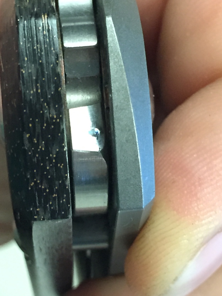

My Sebenza 25 has developed pretty bad/consistent lock stick. I've cleaned it up and scrubbed the mating surfaces. There's a small divot on the tang where the ceramic ball meets the lock face. This knife if definitely a user, as I don't baby it at all. It's used as a tool. I certainly plan on sending it off to the spa to get checked out, but I'm wondering if anyone else has experienced this with their 25/Umnum.

Picture of the divot

That looks like a deep divot, cant say I've ever seen that before.

A slight stick is normal and desireable as it seems more secure. The divot in your pic is definitely not normal at least in my experience.

That said, that is the deepest intent/groove that I have ever seen in a 25/Umnumzaan. (Not that I am any kind of expert...)
The mark on your lock face does look more pronounced than you would normaly see, there is usually more of a track to the point where it stops rather than just a dimple so that is probably why you are felling the action more. You can try working the lock to flaten out that edge of the dimple. There is also the after market LS carbonfiber scale you have on the knife that could be throwing things off. :)

The issue with lock stick is coming from somewhere so the possible issues need to be highlighted untill they can be discounted. That is an unusal working mark on the blade tang so I have to wonder where that came from. :)

To me it almost looks like it had to be a homemade mod or something. I have a hard time seeing how the ball could have just "made" a deep divot like that with no track. Is there any up and down blade play at all?

I'm going to assume there is a track on the knife, but it is washed out in the photo. You can see a bit of it on the left side of the dent.
There is a very pronounced and obvious dimple on the lock face and that is unusual. That dimple seems to be acting like a "detent" and is causing the lock stick. How it got there is the obvious question. :)

Now that you point that out, it is a REALLY early place for a dent like that. Very, very strange.

My best guess is the thicker-than-normal (or so it appears to me) aftermarket scale is preventing the pivot from screwing in all the way, or maybe from being held firmly. Also, the factory bevel on the back of the pivot screw precisely matched the factory bevel on the slab. I could see that if there is any mismatch, it could introduce play in this assembly. This play may be almost unnoticeable, but create a situation that as the knife is opened, the ball sips off the end of the tang, takes up the slight slack in the assembly, than slams back into the tang, creating the divot.
I would sand the divot flush, with very fine sandpaper, and swap out the CF scale and see if the problem comes back. Or just live with it. Might be the price you pay if you like that scale.
