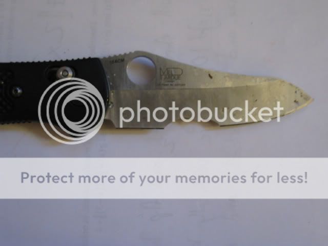

Any pics available? Are we talking like this?
images
Or more like this?
