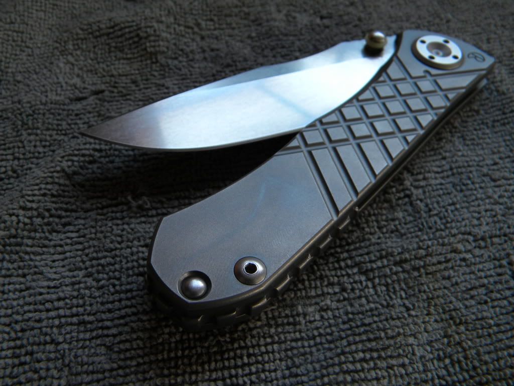

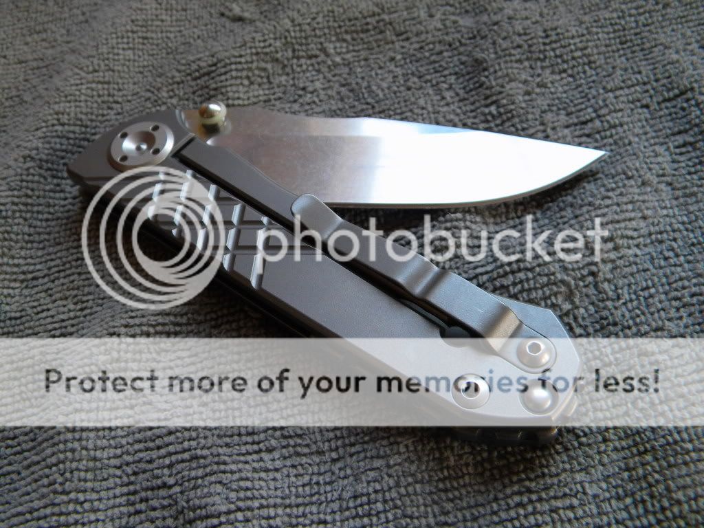

Its possible yes, after my scales were covered in scratches I took steel wool to the finish and smoothed it out then dropped them in the tumbler for a stonewashed finish. I love this look and it hides wear well. Tom is correct though, it makes the knife smoother than a blasted finish but thats a individual like and dislike issue.

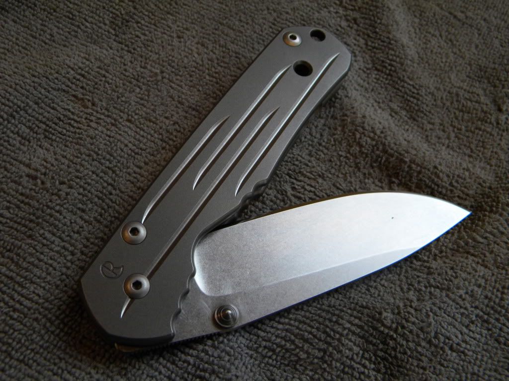

CRK sand blasts the scales. Bead blasting smooths them out nicely, and that tumbled finish looks fantastic. If you want them bead blasted PM me or drop me a email an I can do them free of charge, i've done a few for people here and they really liked them.

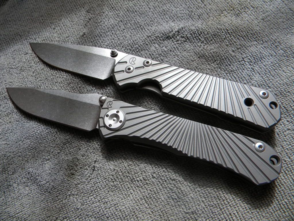

Some of mine that I did.

Drop me a PM I can stonewash it for free of charge.

gunsmoke and atony - those handles look fantastic! I personally don't like how the scotch brite pads make titanium look.

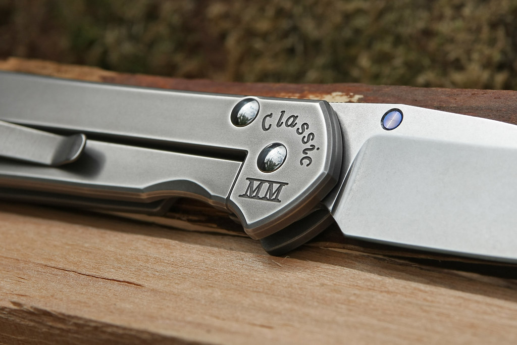

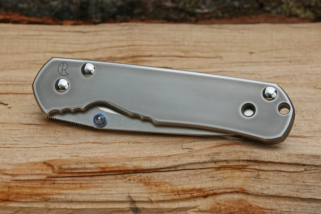

Here are two examples I did with a combo of wet/dry and scotchbright.
Okay, I'll have to admit those last few pics look good. I guess I should rephrase to say that when I do the scotch brite on Ti it doesn't look good. ;)
