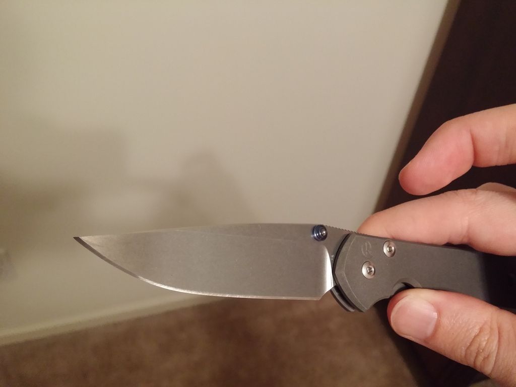

If I understand correctly CRK sharpens a Sebenza to a convex edge. Also, if I understand correctly sharpening systems (Wicked Edge, Edgepro, KME, Sharpmaker, etc.) don't really do convex edges but can fairly easily put a primary bevel and add a micro bevel.
First, am I correct in my understandings? And if I am correct, how do you sharpen your CRK knives? Free-hand a convex edge? Used a system and if so what sort of angles do you use? (Like a primary of 30° and a micro bevel of 40° or something else).
My freehand sharpening has been honed with probably 30 years of practice and still sucks!! I use a Sharpmaker now but am considering upgrading but now all my EDC carrying is only CRK so if I'm going to make a change I want to be sure I'm doing the best thing for my CRK knives.

After about three years of daily CRK carry, I have settled on a KSF leather strop loaded with medium and fine grit compounds as my main sharpening system. Very little metal is removed, and the strop has no issue dealing with the convex CRK factory edge. I default to a sharpmaker for repairing any major dulling or damage to the edge. With the sharpmaker, you are forced to removed the slight factory convex first, to get right to the edge, and this can be a hassle the first time. Once you start using a loaded strop, the convex comes back over time, and if you have to hit the sharpmaker again, you will need, again, to remove the convex to hit the edge with the rods.
Sounds like maybe a hassle, but to tell you the truth, once I started sharpening with a loaded strop, I find I never pull out the sharpmaker. Things just seem to truck along fine as long as I don't do severe damage to the edge doing something foolish. It's really hard to screw up with a leather strop. You remove very little steel, and don't run the risk of ugly scratches on the blade if you slip. Also I feel the slight convex edge it gives you is more robust than a true v-grind.
Heresy, I know, but I just hone my 21 edge-forward on diamond hones, never mind the convex edge, which was pretty subtle anyway. Cuts like a banshee. S35Vn is a fabulous steel.
I mostly use loaded strops, like kidcongo. Dull edges or heavily used edges sometimes go to the SM at 40 degrees. I have some CBN paste on balsa that I like a lot as well as a couple of Brommeland loaded & bare strops.

I use 1000 and 5000 grit water stones then strop with BRKC green and white compounds. If you want more of a slicer, strop on a hard surface to keep more of the "V" edge.
I only use the sharpmaker and have been using this and the old vintage crock sticks systems the sharpmaker is based off of for 30+ years. Once I get to the belly, I slightly tilt the blade to follow the convex edge. I can sharpen a sebenza dozens of times and the edge still looks factory. Sometimes, it only takes 1/2 dozen strokes per side to get it back to razor sharp. CRK also recomends the sharpmaker. It's easy to use and you can easily follow the contour, while the fancy wicked edges and edge pros ruin the edges by taking off too much metal. I cringe when I see the proud sharpening jobs people used on those systems. In many ways, all they did was ruin the edge and the knife overall. Learn to use the sharpmaker and you can't go wrong. Use the sharpie trick to get the hang of it and you will be happy.
Why are the fancy Wicked Edge and Edge Pros applied edges ruining the knife by removing too much metal? Can you explain what you mean?
To me an edge that looks like a factory edge means it is at least 17-20 degrees per side dull (34-40 inclusive, sometimes 50), so very dangerous to use, no matter how well it shaves. An edge that looks "factory" is often the worst thing you can have on a knife...

So the factory edge on a CRK is the worst thing you can have on a knife....??? Maintaining that factory edge is the worst thing you can have on a CRK.....??? Comical to say the least.
These systems work so so for the flat edge of the blade, but when you hit the belly to point area, they keep taking metal from the shoulder to compensate for their lack of contour. There are tons of pics of sharpening jobs showing this. So now you have a sebenza with the blade sharpened 1/8" in that belly to point area. WAY too much metal removed. Could show you many pics of what I am talking about but photobucket is being a pain in the but lately.
Do a google search of " sebenza edge pro edges " then click images and you will see what I mean. Belly to point area is completely ruined. Try telling me these butcher jobs is better than the factory edge....????

IMHO the sebenza does not have a convex edge. It has convex character due to the final edge being put on with a belt; but is not convex enough to be a true convex edge. That's why you can readily sharpen it with a Sharpmaker. If you want a convex edge, use sandpaper on a soft surface. I have a Don Hanson custom with a convex edge, that's how he told me to do it and it works well. I use different grits of sand paper on a small pad of paper or cardboard.
For my sebenza I use the Sharpmaker. I needed a little bit of work to get the factory edge ground to the same angle, but not much. Works great for me. I have a polished blade and don't want to use stones or sandpaper due to the risk of an errant scratch. I do however occasionally do touch ups with sandpaper to give it some convex character.
I too tried out the WorkSharp at Cabelas, not very impressed. The ability to severely goober up a knife quickly was more impressive than the edge it gave. Don't use it if you drink and sharpen :) For the knife I tried on the WorkSharp, it lowered the quality of the edge I had originally put on in it.
We'll why don't you looky here...a Wicked Edge sharpened Sebenza that's not ruined. An even bevel from heel to tip? JAYZUS, heresy I tell you! I'll keep my V edge over the dull 45 degree inclusive convexish thing, thanks. At least it's shiny?
