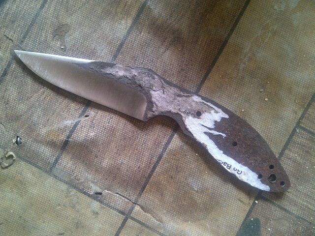

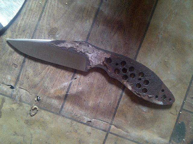

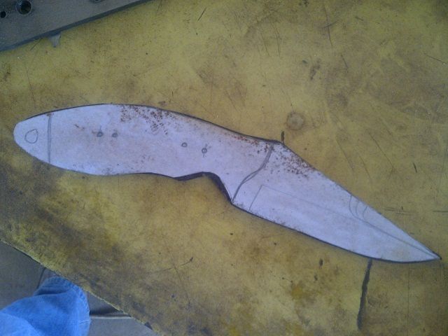

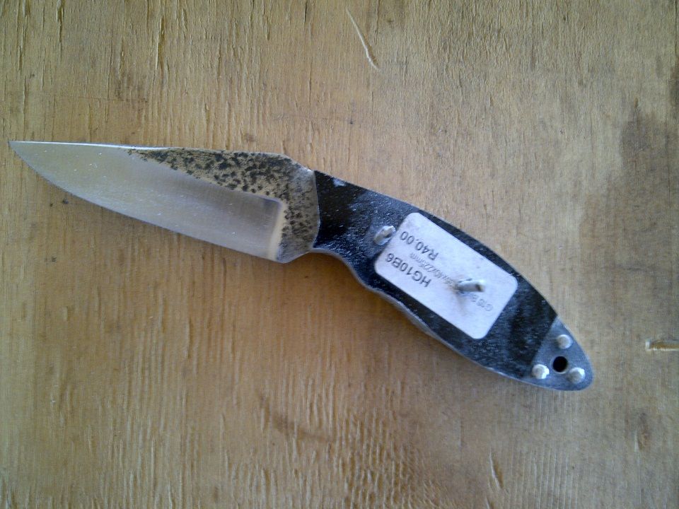

I have decided it will definitely be number 2, and I am going for a "retro" kind of look - using some W2 from a circular saw blade, combined with micarta, stainless steel and leather. WIP to follow shortly.
Here it is, marked out on the blade:
With the initial grind, pin, bolster and lanyard holes drilled:
Balance/structural holes drilled:
Almost finished — the shellac needs to dry and then I need to make a sheath. I've got a lot of pictures and I'll do a full WIP when it's done.

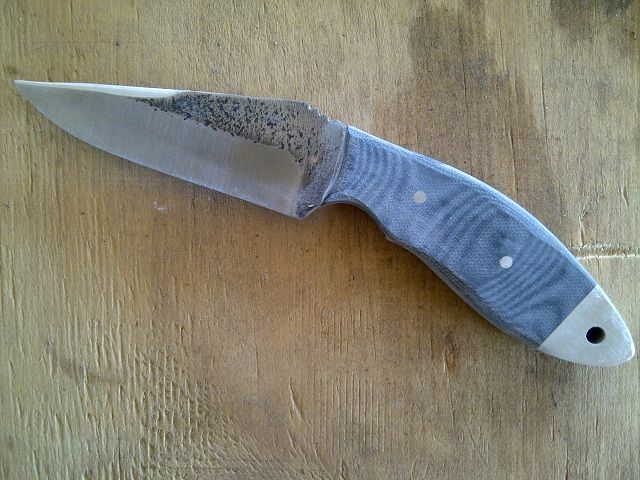

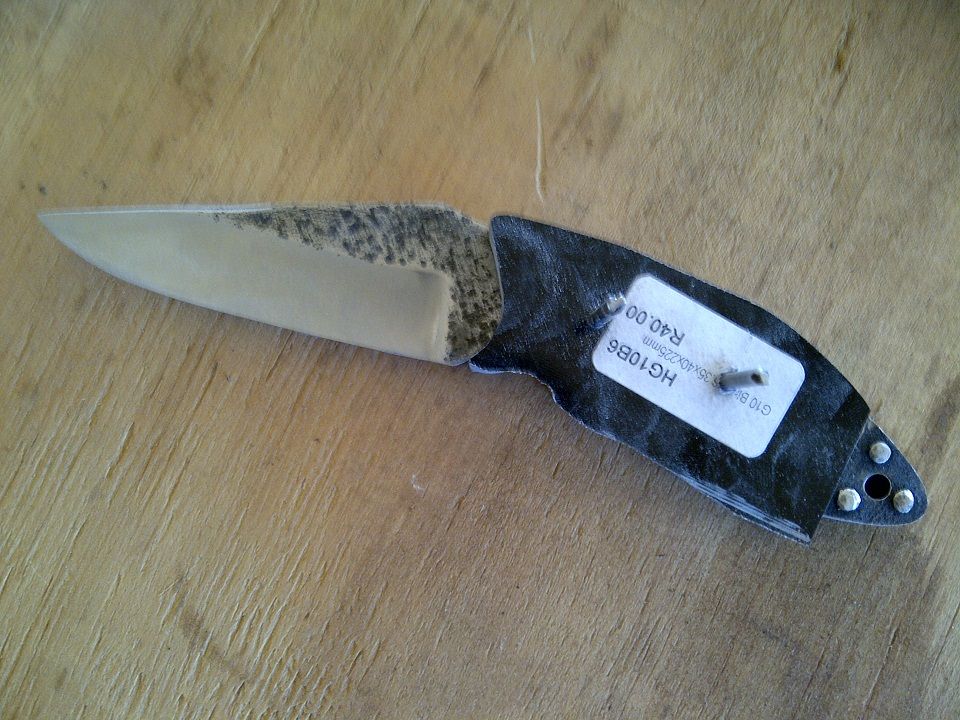

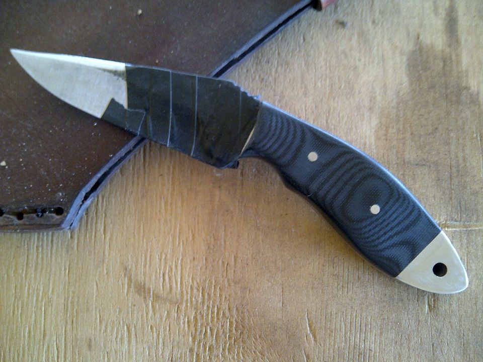

Right, made a bit more progress. I didn't take pics of all the steps but I know you will get the idea:
Pommel bolster fitted and riveted, Micarta scales rough fitted:
Scales profiled more:
Epoxied, pinned, shaped and initial sanding done:
Sanding a bit further along and approaching final standard of 800 grit:
I should be able to finish it off in the next week or so and have it on it's way to John at 3RiverBlades.
