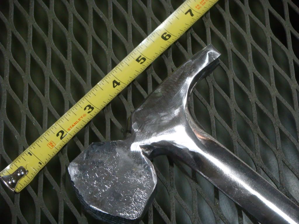

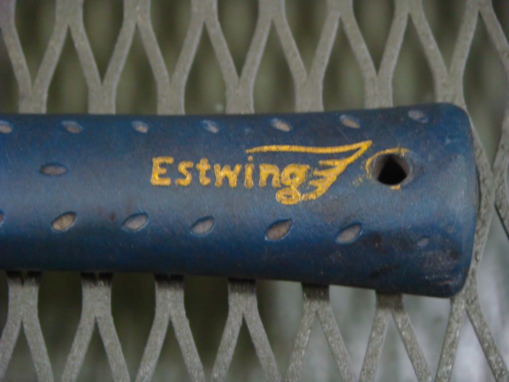

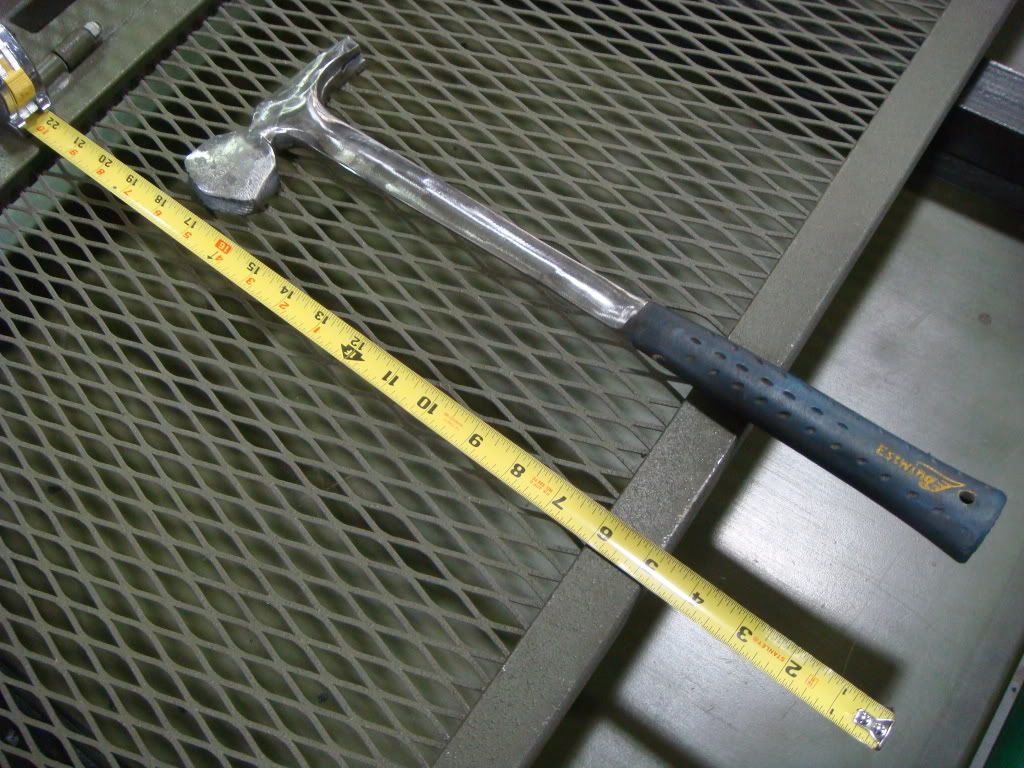

I was cleaning up the garage in preparation for the holidays when I came across an old roofing hammer that has not been used in many years. It's an old "Estwing" with the molded blue rubber grip. I just hated to through it away. Then it dawned on me to try my hand at converting it into a tomahawk of sorts. I can tell you I have always had an amazing amount of respect for knife makers and Black Smith's but that respect has increased substantially!;) I am doing it with a acetylene torch and the 3 pound sledge hammer. I have a heavy duty bench that is working fine but I can tell I wish I had bought one of the many small anvils I seen at auctions. I will nab the next one I see for sure!:D Anyhow I thought I would share my progress thus far and will add more as it happens. I am in a (designing stage) right now meaning I'm not sure what to do next...:confused: But I'll come up with something. I need to widen the head (cutting surface) another .075 to 1.0 or so. That's all for now. ~baba~
looks like you should either grind the fishmouth out of what will be your cutting edge, or use what steve calls his "bump and draw" method. his youtube videos detail this very well. but youll need to do something about it soon so you dont end up with a cold shunt on your edge.
Got it. that would make sense for sure! That will be my next move then, thanks much!:thumbup:

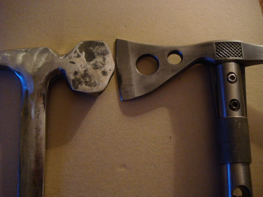

p.s. what is the hawk in the third picture?
