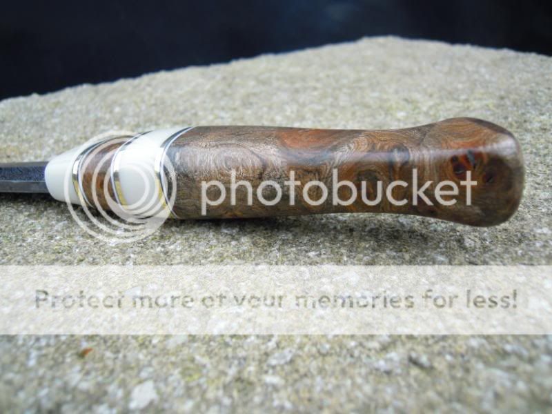

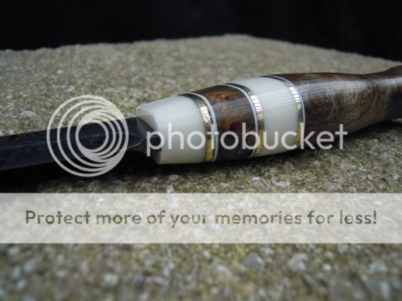

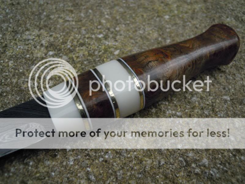

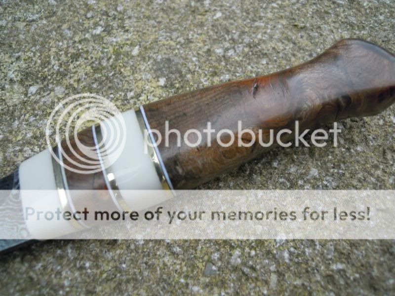

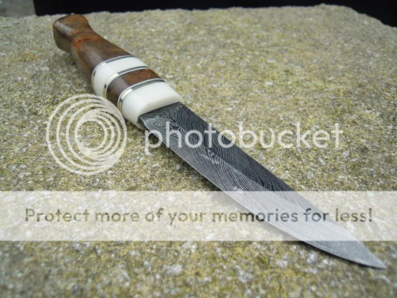

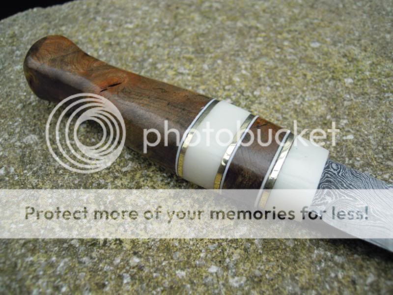

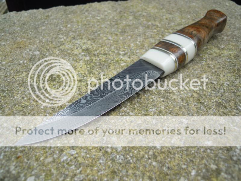

My second attempt, at a true Scandi Style, field, working knife,don't think i'm quite there yet with the handle shape,a few little things am not 100% with but a new learning curve for me :thumbup:
The Specs are,overhaul length 8 1'2in,blade Alabama Damascus 4in by 7/8th by 1/8th,with a 3/8th flat Scandi grind
Handle Corion bolster,with Brass and Burr Elm Spacers and end piece
Feels great in the hand,in all grips,and good allround work knife,with a bit of bling :D
Bernie
More than a bit of bling... I'd use it. I wonder how white Micarta would look on that knife as opposed to the Corian, not that it looks bad, but just a texture change.
Very nice!
Edit: The Damascus pattern fits very well with the blade shape and size.

To be honest,i know the good aspect's of Micarta and can't fault it,but for a handmade Knife,feel you need something different, so none look the same

I think thats awesome! good show!
Although I think it's too pretty to use, and I only buy users, that's one good looking knife. Well done!
