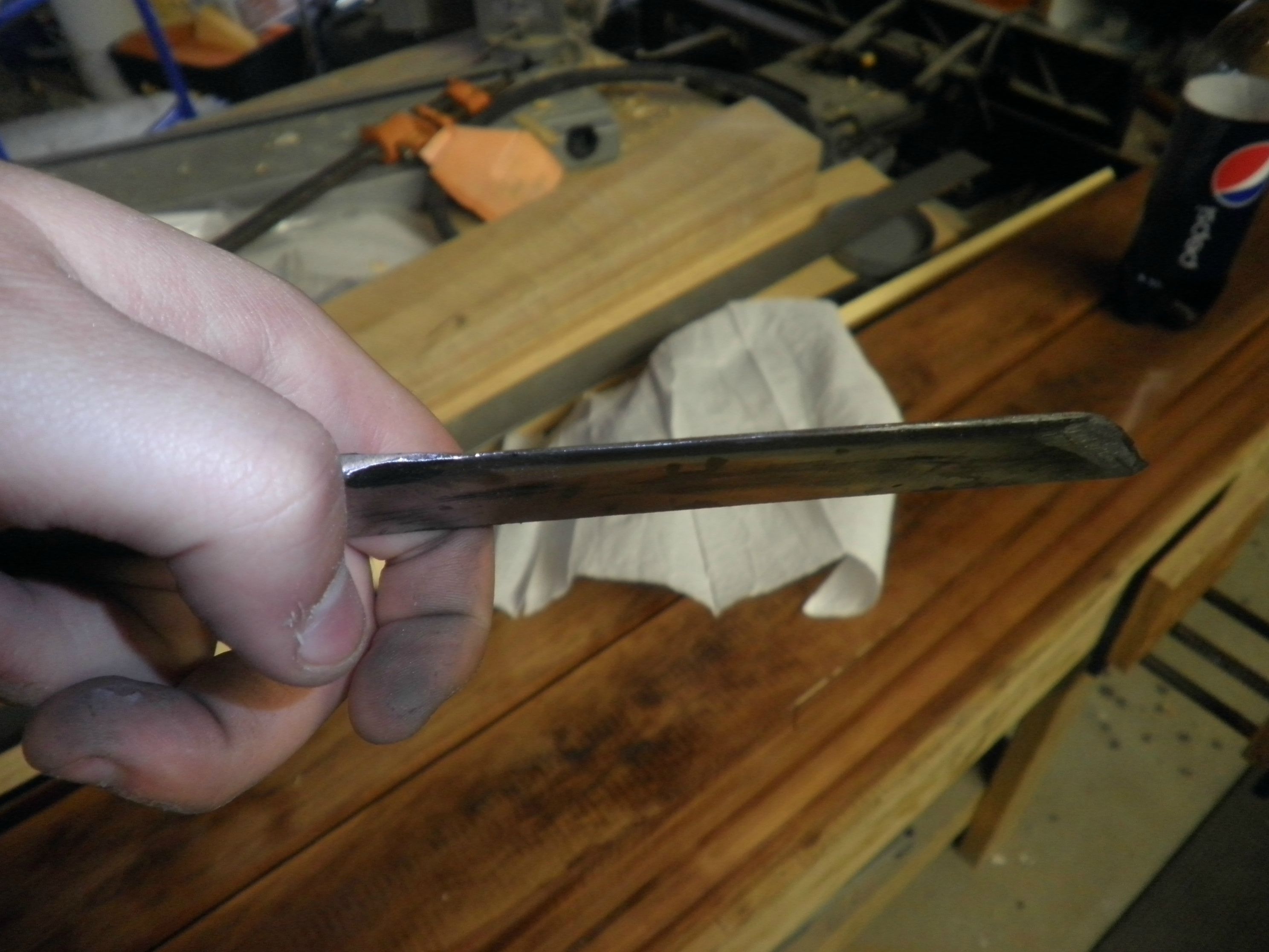

Well, at least you are consistent.
I would really try and read the tutorials and follow the normal procedures, including HT.
I tried doing it different this time, I used a angle grinder. I am still trying to figure out how to make the plunge lines right. Hopefully Christmas I will be getting a belt grinder.
Good for you on using a good piece of steel.
Does that knife match the picture you had in your mind?
If yes, I'd say look at some really good knives and see what's possible.
Internet photos, videos, real knives, whatever you can get.
If it does not match the picture you had in your mind, then what do you have to do differently to get that knife to match the picture you had in your mind. ?
Try reading all the links in that standard reply, it will help you so much.

Seriously I'm trying to find something good to say about your first and second.
Usually there is a huge improvement between a new maker's first and second as they apply what they learned.
So you finish a knife at record speed and then ask what we think?
I think you should be able to do better.
Notes for you to consider
Your wooden sheath looks like a 2x4
the flame colouring can be interesting, but the shape is - shapeless.
Carve it down, the soft wood you used will probably cave in by the time you get to a decent slender form that matches and complements the knife.
Try hardwood next time - real hardwood maple flooring samples or scraps work

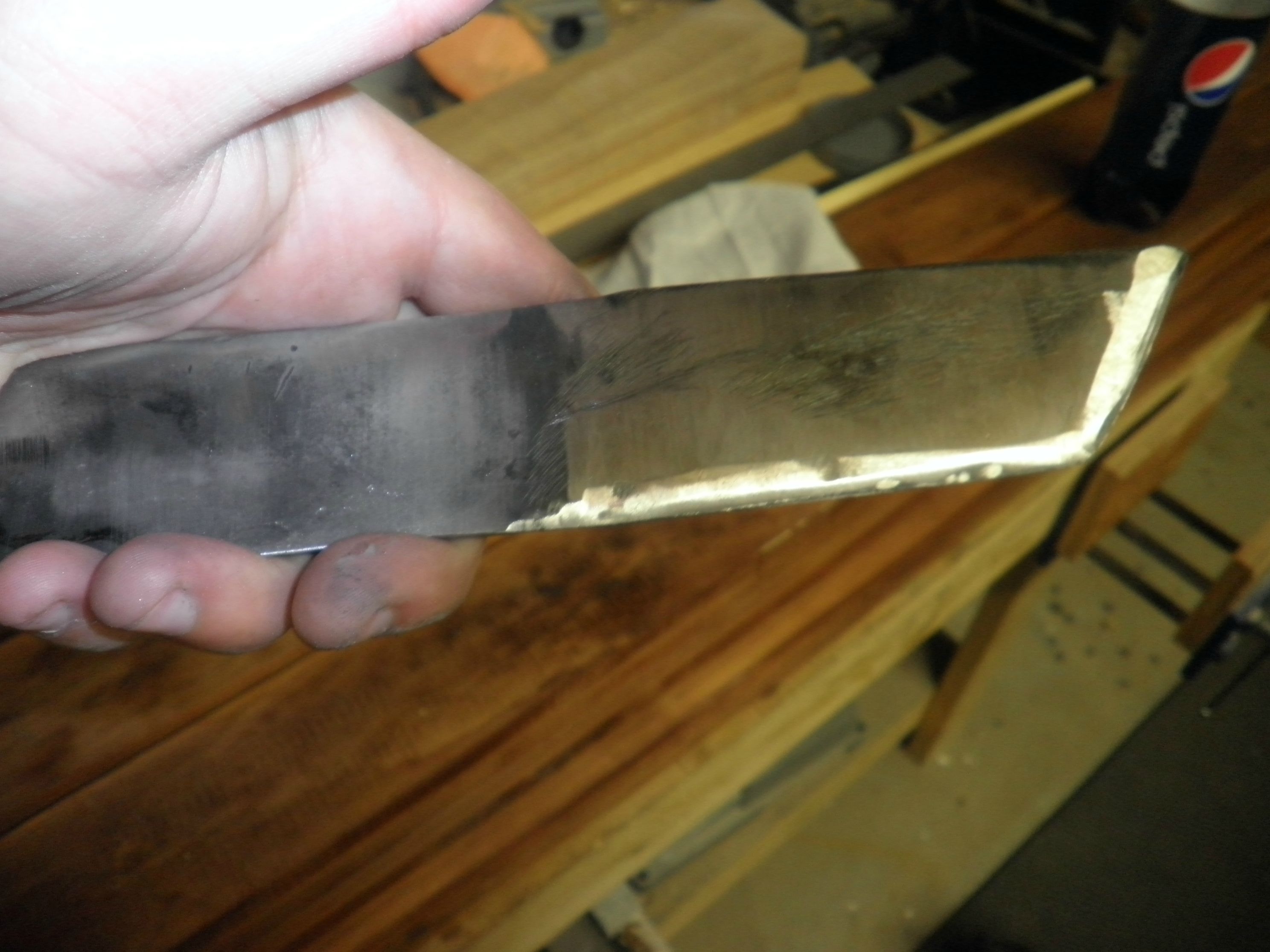

Your blade bevel
I understand Scandi grinds are popular, but look at any American tanto
http://www.rationalselfdefense.com/...n Pictures/Cold-Steel-Tanto-San-Mai-iii-3.jpg
http://www.canadaknives.com/images/sanmeil.jpg
http://pages.123-reg.co.uk/winchester-774595/sitebuildercontent/sitebuilderpictures/110.jpg
The grinds go at least half way up the blade, thin edges and thin wedges cut
Your blade, is a flat piece of steel that you skipped putting a bevel on and jumped straight to an edge.
You're blade is perfectly straight.
Look at the 3 photos above in the style you are trying for.
They're not straight, the visual appeal comes from curves - think of a woman - curves.
Try making an exact copy of a knife you have, so you can compare one to another side by side.

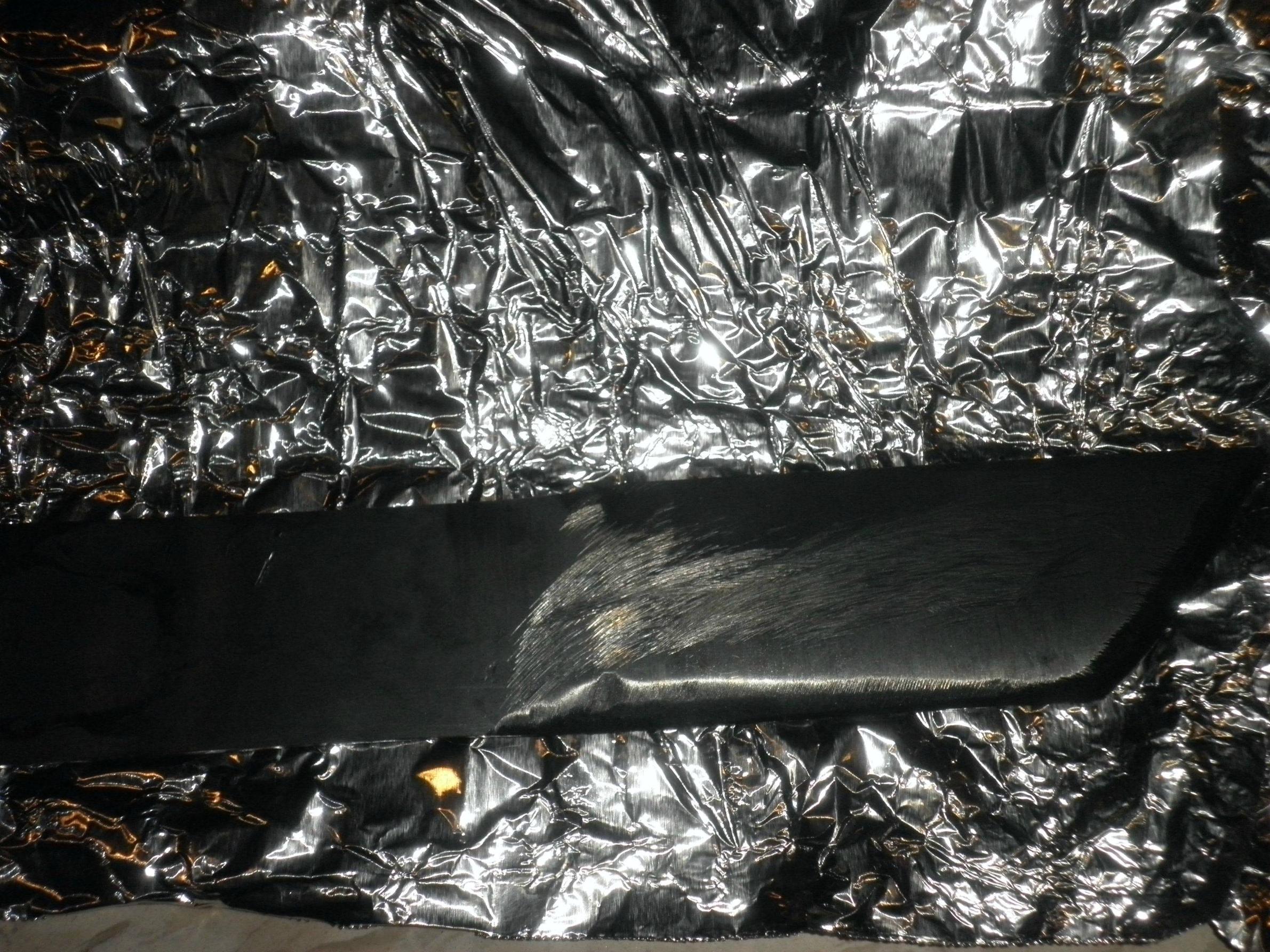

And heat treat, i have a question How are you heating the blade?
To be honest i think you are rushing things way too much. I would advise that you slow down and focus on each step before moving to the next, without skipping any steps, like putting bevels on a blade, or giving the handle a smooth contour. Like i said before i am not a master by any means, and im not trying to be harsh, but right now it looks somewhat like the blade i took off my lawnmower when my girlfriend ran over the curb with it. Ditch the bench grinder and angle grinder and, and remember three words, files, files, files. And like Stacy said, read the stickies here. there is an insane amount of information. Quite honestly i think that the blade shape on your first knife was a more functional blade also. Like i said just slow down, take a look through the custom knife sub forum and the knifemakers for sale area and just think about the time involved in some of those knives. I am willing to be that very few of them were finished in a day.

I'll speak plainly here. You're trying to rush through a process that should be moving slowly enough for you to learn something along the way. Don't wish for a grinder for Christmas. Wish instead for some time to work on a knife. The more time the better. Learn how to grind using files. That will teach you how to move the abrasives against the metal to achieve a certain look... like a defined plunge line. Learn to use sandpaper in a way that preserves the crisp lines you struggle to grind. Learn to make handles that look like handles. Learn to make sheaths that can actually be used to carry a knife.

I watched your videos and you do not mention "Heat treating" but only "Tempering". How did you heat treat the 1084 before you tempered it?
