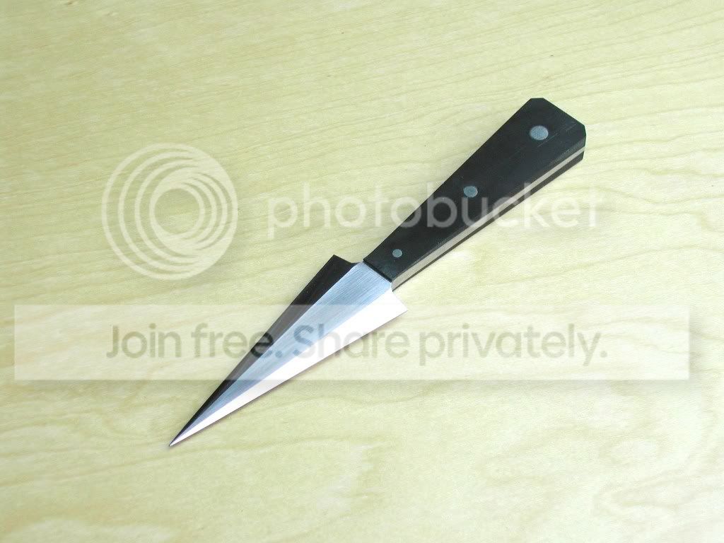

Second Knife
Apr 16, 2008
814
1084 forged and hand filed, flat
220 -400 finish on KMG
Black paper micarta, 304 SS pins
1500 F quench, 400F temper twice 1 hr.
Length 7 1/2" blade 3 1/2"
I've been studying and procrastinating for 30 yrs.
Looks great to me. Heck, you could strap that baby to a pole and... tada! Instant spear! COOL!:thumbup:
I agree it looks awesome for a second knife. I thought arrow head when I saw it. Very nice design.
The pin diameter decreases toward the point. Nice. It almost looks like an art deco piece to me (mind you this is noob input here). Tang appears tapered. Very nice. It looks very formidable as well. Super nice!
Very cool, love the hard angles, normaly I like more of an organic look, but that looks awsome.:thumbup:
