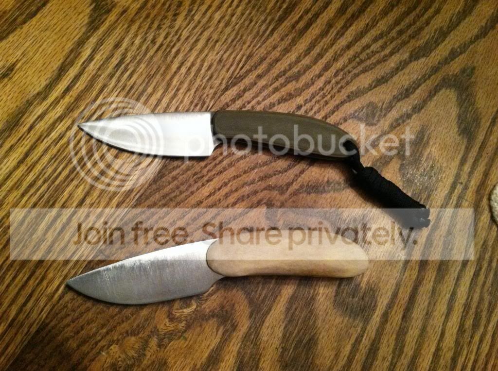

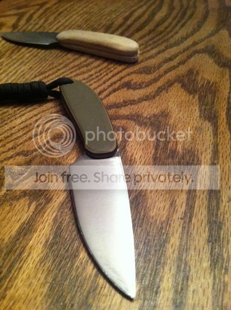

Edit: Here are the first knives I made (I made them both at the same time, one G10 the other deer antler. Both from a sawmill bandsaw blade. Heat treated with acytlene torch, quenched in motor oil.)
Ditch the M390 especially if you are going to HT yourself... The temps needed are over 2000F and require a soak. Then the quench is a bit of a trick to really get the most out of this steel. May I ask why you are so set on it? I find that so many, and don't take this the wrong way, new makers get in their head they want one type of steel and don't really know why. They are maybe basing this on one blade they looked at for five minutes, or just because "my buddy said." If you don't know the metallurgical process involved with proper HT, the steel is as worthless as mild steel when the knife is done.. That said, DO stick with known steel. I feel like I have just now reached a point where I can start playing with mystery steel to some degree. However I will spend a lot of time checking it, testing it, and trying to determine exactly what approach to take with it. In the end though, 99% of the time I start with known steel where I know what result to expect. Also, do not quench in motor oil... This is bad bad mojo. Motor oil is designed to deal with temperatures of around 500-750 degrees max. Not triple that. In addition, USED motor oil can have suspended water which will cause it to violently erupt on you, and also contains nasty heavy earth metals and such which can do bad things to you health wise if the vapors are inhaled. Use a quality quenchant, or at the very least something similar of known content.

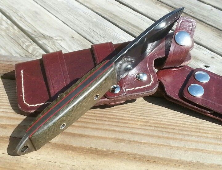

This is similar to your drawing. Also has a sort of flat grind, however is compound with convex near the blade edge. It may appear to have a shallow bevel, however the measurement is actually .090 a full 5/8 inch into the blade, customer did not want a plunge cut... I went with 3/16" thick 1095 steel and the customer who now has it reports it is far stronger than he ever imagined... I actually took a similar knife with my HT and drove it into a crack in a rock wall, using it as a step just to prove my point to someone... Then I pulled it out and shaved the hair off my arm. Don't discount simple carbon steel. Simple doesn't mean it isn't capable, just that its chemistry is free of a lot of alloying components.

That design sure does look like an ESEE, which is ok as long as you're not producing and selling them. I like the small sharpening choil. I do the same thing on my knives:
http://livknives.com/wp-content/uploads/2013/05/Ranger-3V-Tan-3.jpg
The biggest issue I see with your design is the handle shape as viewed front to back. the handle is thin exactly where you'd expect there to be a palm swell. Have you made a full scale model yet? That's the first thing you should do before you make the knife. Making a model out of wood or other cheap materials is an easy way to figure out if it's a good design.
First of all, What an unbelievably attractive knife, LCK. Just, wow...its perfect.
Also, I appreciate you taking the time to type a lengthy response.

Hah, I am aware that the antler doesnt look like an antler in the traditional sense, but it is, in fact, the very outside of the antler for the most part. Just not a very unique looking one. It was laying around and i thought what the hell. I can still remember the smell of running it through the band saw.
I will definitely reconsider the steel as per your suggestion of using a carbon steel. I wish I could say that m390's name and reputation has nothing to do with me wanting to use it but I guess it kinda does. But, using it wont break the bank and I just thought it would be fun to use something exotic so I went straight to the top of the exotic list.
I am completely aware that the fit and finish on my first knives are sub par but I really rushed through them because I was having so much fun. I probably spent 6-7 hours start to finish on those knives. This, I want to make more of a summer project/hobby, leaving not detail to spare and taking my time.

Yeah, if you are sending out for HT have at it. Sorry about the antler, I have seen more than one that was used as scale material cut down into the pith. It is hard to get a grasp of removing material for the under side to get it thin, and I think a lot of people just assume they are solid... No worries, sounds like you know better... And yes, it is some smelly stuff when it gets a little warm... lol.
Thanks for the compliment, I think it turned out well.
