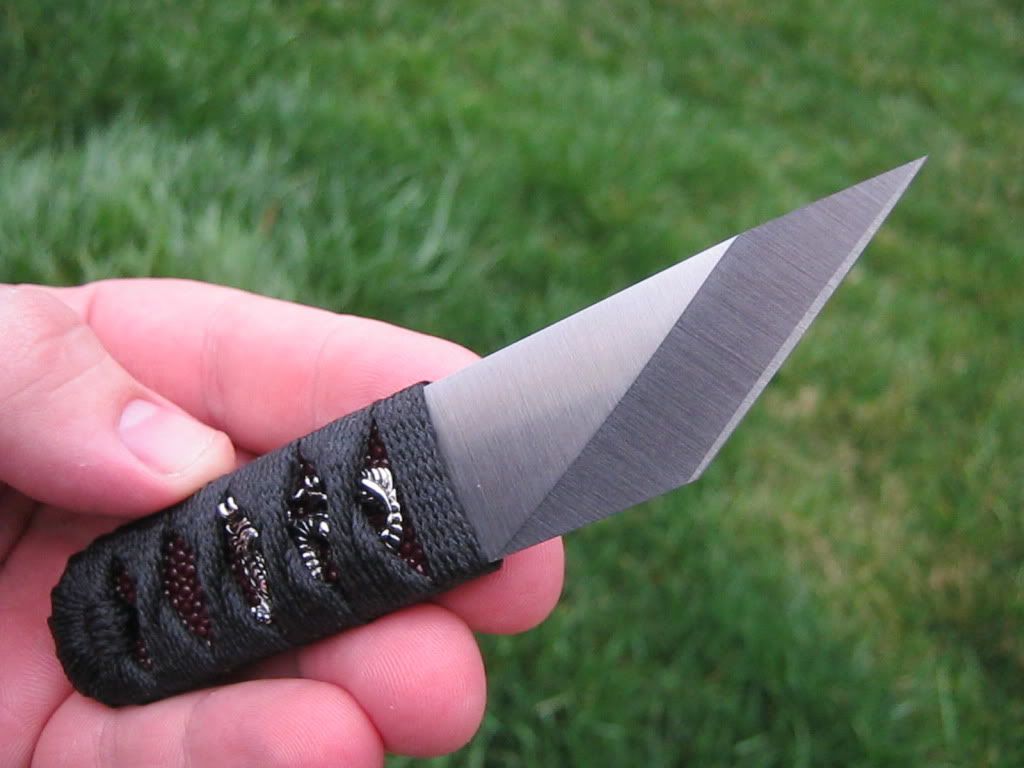

I'm with Jonathan, I tried zero ground knives and mine were very chippy and delicate. I want my customer to be able to sharpen these knives without laying the entire bevel on the stone. What a pain in the ass, and a quick way to ruin the original finish.
Alot of my knives are a single bevel, with a secondary edge on the bevel side, and even a tiny microbevel on the flat side. I've also tried sharpening a bevel on the flat side that terminates into the primary grind. very interesting, and very sharp. Cuts nicely too.
Here's one of my kiridashi's with a secondary bevel on the grind side, and the burr knocked off the flat side with a leather belt. VERY sharp.
