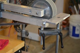

Having a second slot on my grinders is "A game changer" for me. I have several different tool rests that I have constructed for different jobs but the best one is mounted to a tool arm. I have a tool rest like the Esteem grinder uses and it is a good rest as well but not as stable as the tool arm mounted rest. Here are a couple photos. Larry

Justin, I modified my KMG for a second tool arm slot as well. I have seen photos of your grinder and the direct drive conversion is nice too. I love having an extra slot...best thing I did this year! Larry
