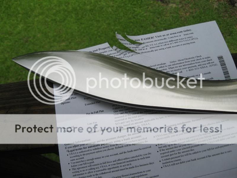

Once I got it sharp, I chopped trees with it.
I split wood with it. We don't need no stinking batons!
The edge on mine was a bit thick. I had to thin it down all along the blade to keep things even, grinding off the "Busse" and "Test Team" logos.
Once sharp, it did a fine job.
Just stick it into a log. Then beat the log against the stump. Works every time.
It's a beast of a chopper. It actually handles more like an axe than a knife.

Thanks, Helle. I think maybe things got a little rushed getting these ready for Blade. Here you can see below my grind marks just how obtuse the final edge was. Yeah, those are 40 grit scratches. Why mess around when you have some serious stock removal to do?
But I went to finer grits once I got the profile near where I wanted it. It came out really sharp.
I didn't remove anywhere near the amount of material Horn Dog did, but mine will at least slice paper now.

Mine wasn't that dull, but it needed some work. I figured that to truly test the Killa's chopping performance, it needed to be sharp.
I might be exaggerating slightly, for comedic effect ;)....
but it definitely did more tearing than slicing when I tried it on paper with the factory edge.
The knife weighs about 2.5 lbs and balances about 2" in front of the scales. It's a hand full of knife to swing. Of course, it hits like a ton of lead. On softer wood it sometimes goes through 2" limbs in one blow, sending each piece twirling through the air in a most impressive display of power! :eek:
The knife weighs about 2.5 lbs and balances about 2" in front of the scales. It's a hand full of knife to swing. Of course, it hits like a ton of lead. On softer wood it sometimes goes through 2" limbs in one blow! :eek:

Hi Horn Dog. Thanks for the pics and the review.
Mine arrived in a state of monumental bluntness too. Not to incite a cool-aid fueled human sacrifice (especially of me), but I think this point is worth emphasizing/repeating.
The problem wasn't so much that the Killa was dull. The primary bevels were just wrong and left enough INFI behind the edge to pretty much kill any ideas I had about just "sharpening" it. I gave up trying to 'sharpen' mine by hand when I'd worked a 22.5 degree secondary bevel (i.e. 45 degree inclusive angle) back past 1/8" on both sides and still had a lot of work to do before they formed an edge.
I ended up taking a 36 grit belt to it and re-profiling it much the same as you did (even keeping part of the logo). Not a job to be done by hand.

Here is my summary of testing the Killa Zilla.
1. This is a very heavy Khukri, but not any heavier than some traditional ones. Still, in a Khuk with a 12" blade, I'd prefer one around 22 to 28 oz rather than 39 oz. I realize that this is my preference and that some users are fine with the very heavy Khukris.
2. The edge profile on mine was too thick to chop well. Yes, I tried it with the factory edge first. I don't know if all were like this or not. I would prefer the knife be made in 3/16" stock or else 1/4" thick with a full flat grind to lighten the knife and improve the edge geometry.
3. A Resiprene C handle and hidden tang with a traditional khukri shape would be easier on the hand and improve handling. It would also reduce costs some. I realize that Busse Combat no longer uses Res C, so let Scrap Yard sell it! :D SR77 is fine for this type of knife.
Overall, it is one heck of a chopper and wood splitter. I could live with the handle and even the weight, but the edge profile needs some serious work.
