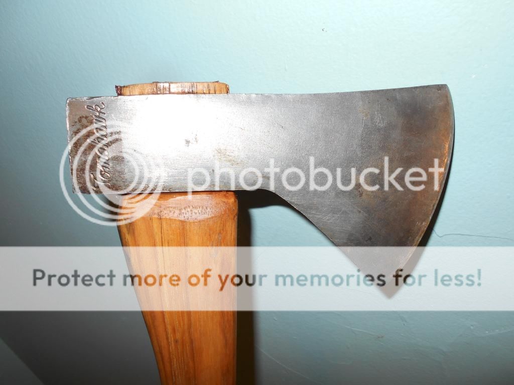

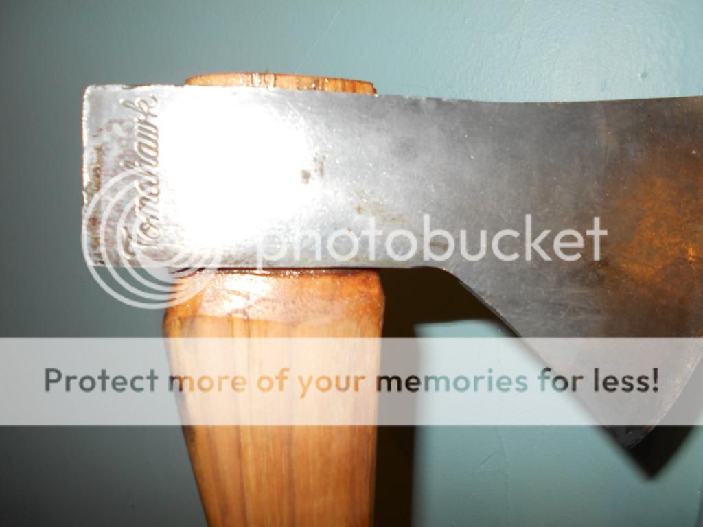

Okay, so I managed to shave off 1/8" off the shoulder, soaked it with
the DPG and then dropped the head down to get a full 1/4" over the eye.
I tried to recess the round wedge a bit, but it barely moved. I soaked above
the eye with DPG and I let it sit for an hour per Swel-Lock's instructions,
checked it, it shifted a bit, I let it sit for another 2 hours, checked it again,
she felt snug. I would've liked for the head to be tilted down at the front
more, but it is what it is. I'm sure I'll have the opportunity to adjust that
after tomorrow for sure.
Of course, the true test will come when I do some work with it tomorrow.
Truth be told, I'm not confident that it'll hold. If/once she loosens up again,
I'll try just smacking another wedge into it before I try to widen the kerf and
install a broader wood wedge. After that, I'll re-handle it.

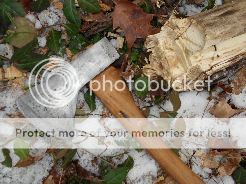

Here we go...

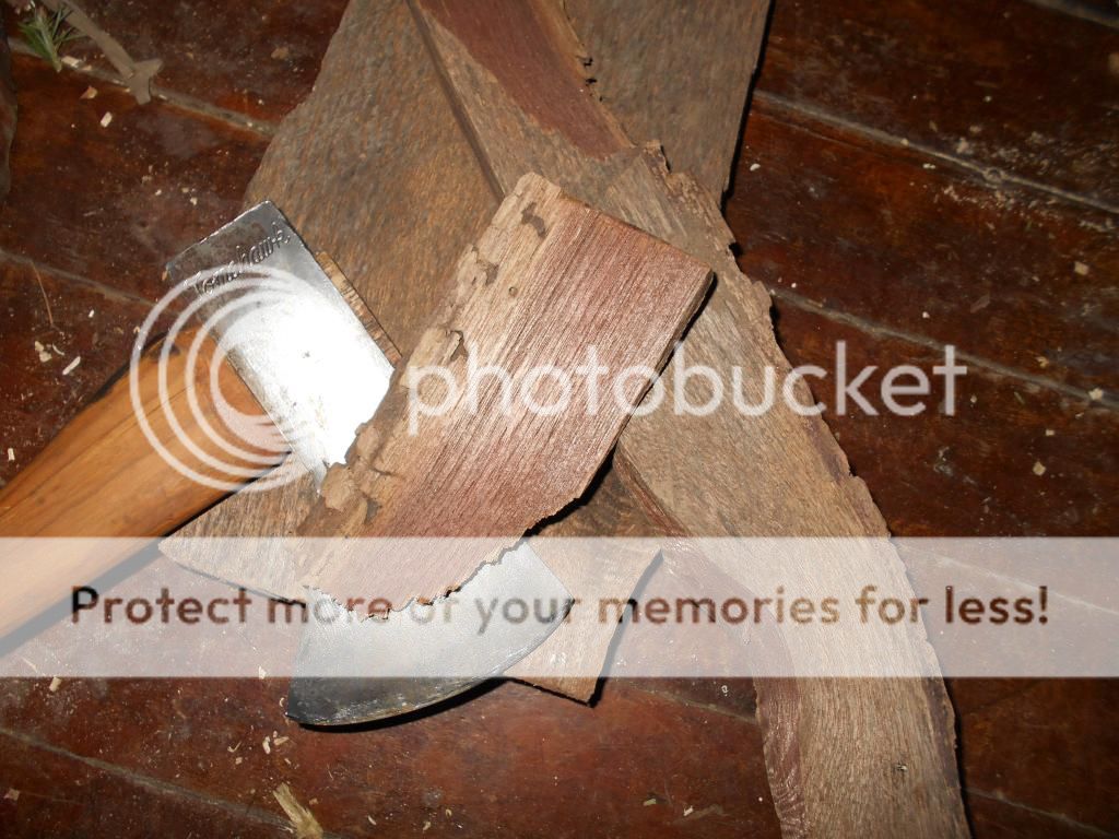

So I take the Norlund out to the yard to whack on a 6" log and on the first strike, the head shifts.
On the second strike, full loose. I didn't get mad, I walked back to the mancave, grabbed my tried
& true Council Tool Boy's Axe Forest Service Edition and put in my work on that log to get a fire.

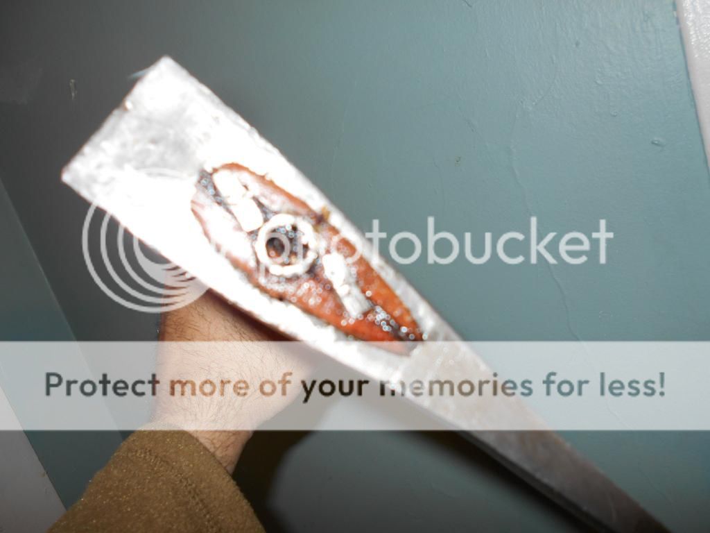

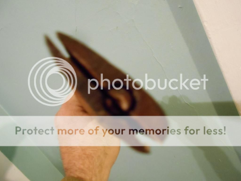

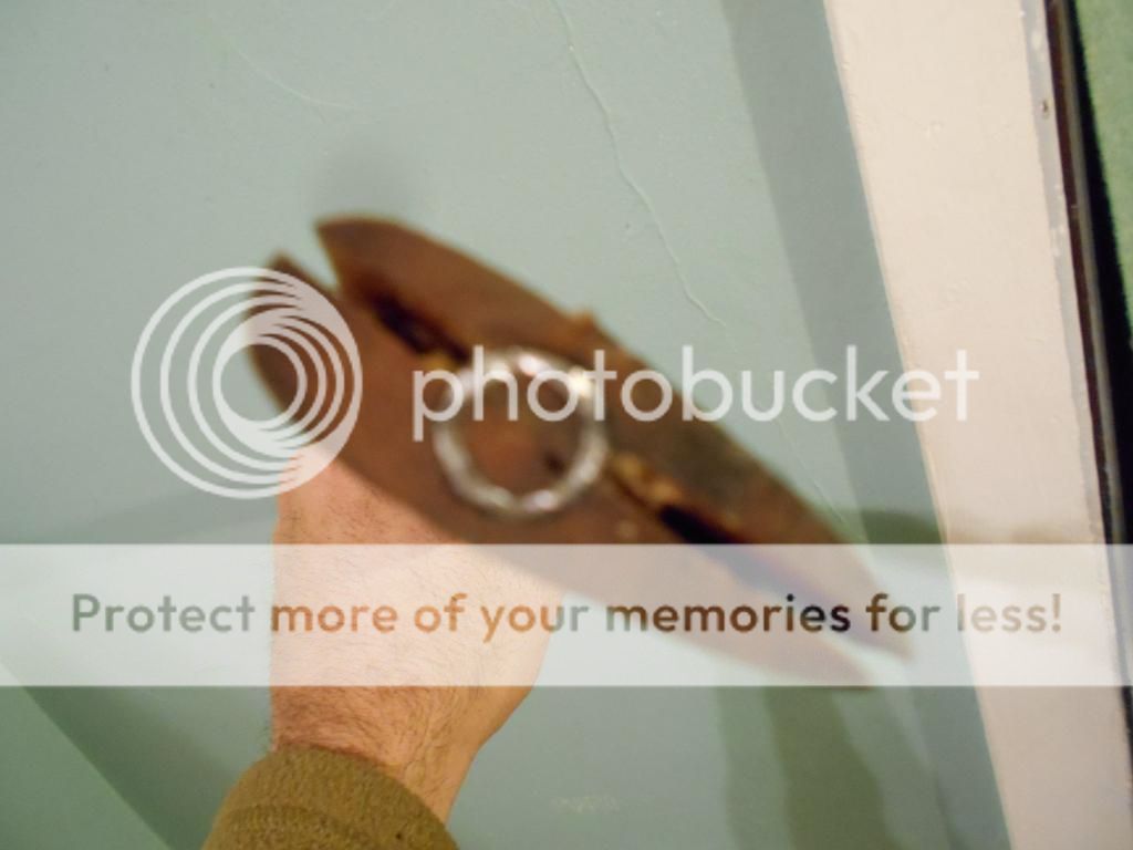

I took of the head off, widened the kerf, made a new wedge out of some seasoned oak and installed it.
But before I installed the new wedge, I soaked the top of the handle, the kerf cut and the wedge itself
in DPG and made sure it was drenched. I'll let it set overnight and try again tomorrow. Wish me luck.

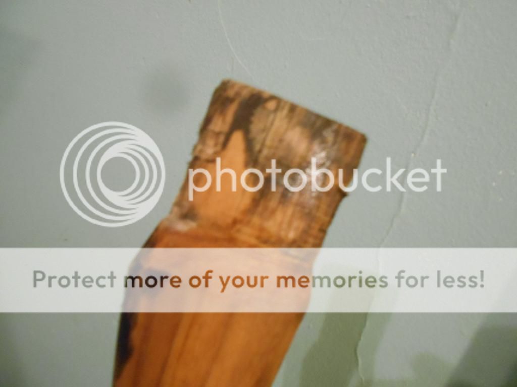

I felt like I had to do everything to practice with this particular handle first. It already had issues
to begin with so damaging it in the process through my learning curve wouldn't be so awful.
Even if I can't manage to rescue this handle, at least when I rehang the Norlund with a new
handle, I'll already be familiarized with the process so there'll be less (not no) of a chance of
my damaging it through my inexperience.

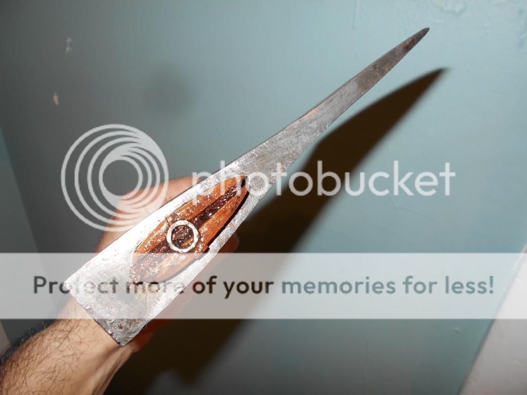

Update:
While the DPG "did" swell up the wood a good bit, it wasn't enough to keep the head secure.
After about half a dozen chops (granted, on some frozen wood), the head came loose,
but this time, it only loosened up by less than an 1/8th". It wasn't coming off so the top
is secure. The handle has spread out over the eye at the top to keep it in. I'm going to
try one more thing (adding a straight wedge) and after that, it's either a new handle or
a spanking brand new Council Tool Hudson Bay Velvicut.

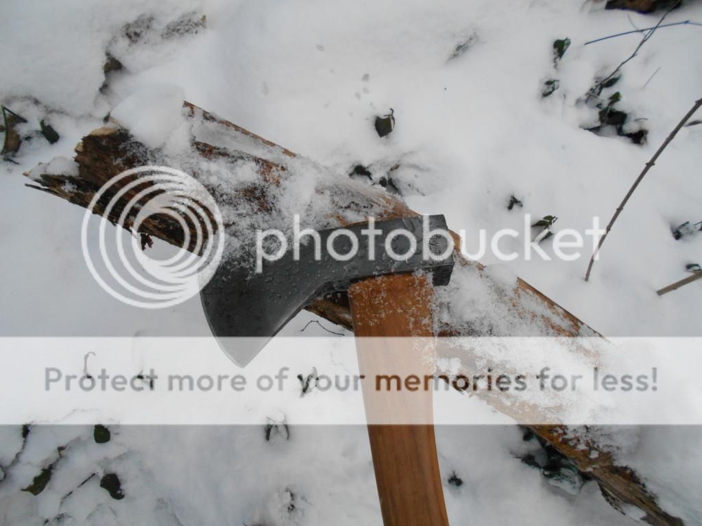

Update 2.0:
Is there such a thing as "settling" on an axe head?
I added a couple of hammer wedges. It tightened up.
I took it outside, went through the same frozen 6" log that it loosened up on the first two times and
probably about 3/4's in, it came up about 1/32" form the top of the shoulder where I had it seated before.
BUT!!! She held firm from then on. This leads me to believe that I may have removed too much material from
the shoulder when I shaved some off. Either way, I continued to chop through log and it didn't budge after that.
I then went on to split some oak and a 3' section of that same 6" log and she went right through it. Is it possible
for the head to settle in just above the shoulder and hold fast there? Can I be satisfied with this for now?
I can only expect it to expand a bit and tighten down even more with the warmer weather in a few months.
Eventually, I'd like to blow it out and re-hang it with a brand new handle, but this'll definitely do me for now.

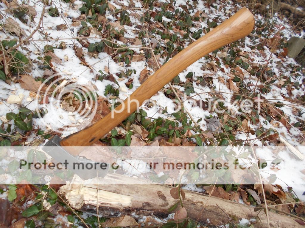

I just came back from doing some more work with it into some frozen logs.
I smacked it 1" deep into a stump several times. The head does not budge.
It just moved up a hair after the first time I went out with it and now, it's stayed
there after I reset the newer wedges and added a few more drops of the DPG.
I went out after that and split down a 6"X24" log to kindling.
Again, it's as if the head actually got tighter and tighter.
It's not loose at all and I tried to force it to move when
I stuck it into the stump a few times just to be sure.
I'll definitely be taking the handle up to at least 26-28" next time.

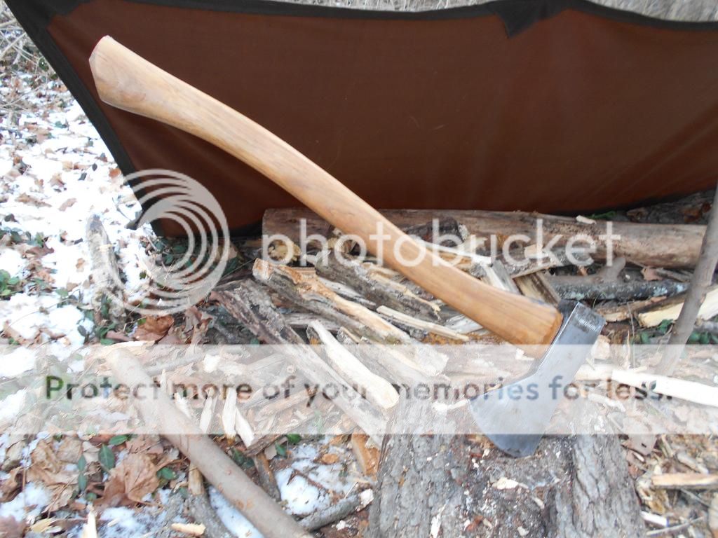

The Norlund continues to perform.
I split some pine today and she held fast. I turned an 18"x 8" log into kindling in under 120 seconds.
I think I figured out what happened. When I first took her out and bucked that fallen log, the DPG hadn't set up yet.
Maybe Swel-Lock adds some kind of additive that speeds up the process. After the first however with this Norlund,
she has continued to remain factory-fixed firm and I'm confident that she'd going to stay that way and only get
tighter as the weather gets warmer.
All that's left to do now is to give the head and haft a good sanding and a nice bath in
BLO and call it a day. She's done. Thanks to anyone who's contributed to this thread. :encouragement:
