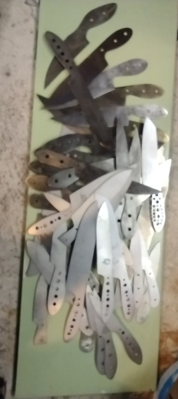

I've currently have almost 50 blades wrapped up for sending out for heat treating.
Just under 25 pounds.
I'm questioning if this is right?
How do the makers who regularly ship out large orders of blades do it?
A packed cardboard box seems borderline flimsy.
Should I be making a small, reusable crate.
Is there such a thing?
Any ideas appreciated
I ship 40 to 50 pound boxes via UPS on a weekly basis. I just tape them up good with regular packing tape and rarely have any trouble. I typically tape all sides of the box though.
With blades or something similar it’s a good idea to wrap them up together with shrink wrap to make one large piece rather than a bunch of small pieces. That way if a hole does get punched in the box the blades won’t start falling out one at a time.
I wrap the batch in saran wrap, with cardboard on the ends, then bubble wrap inside a cardboard box...never an issue.

I have them bundled and wrapped in butcher paper, and taped. In their respected hardness groups.... And tagged and labeled.
*also, I grind post hardening, so all my blanks are dull, no bevels.
I wasn't sure if duct tape was allowed. On the outside?
I have clear shipping tape, but 25 pounds felt alot, like I was pushing the boundaries.... Good to know you guys do it.

Getting them there is one thing but they also have to come back. I would try and make my heat-treaters job as easy as possible when it comes to shipping blades back. A reusable pine box with a screwed on lid would be the go for me for that many blades.
That assumes the heat treater will use the same box going back, it’s best to ask them how they ship and if they would be willing to use a solid box if you sent one, but even wooden crates will bust in shipping and then the heat treated would likely default to their normal shipping method.
For heavy boxes I'll use the fiberglass reinforced packing tape on all seams and a few turns around the outside of the box as well. They use the same boxes for the return trip too and they've held up great. Some have hit 45 pounds. I use the flat rate Priority Mail boxes.

I line a USPS flat rate box with pieces of 1/4" wood. I wrap the blades in newspaper and tape them up good. I pack the box tight with bubble wrap or wadded up newspapers.
I send my blades to Bos heat treating and they always return my blades to me in the same box.

This week my blades made it back to me.
Straight, and Safe
I packed them really tight into a cardboard box with lots of tape. Under 30#
They repacked them in a different box/arrangement on the return home.
