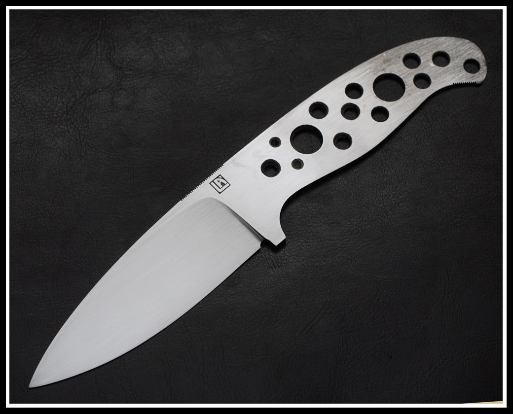

I have all the blades Machine finished to 400 Grit (Belts). I am going to hand sand, Etch Makers Mark, and Etch Hamon's one blade at a time.
HUK Blade #1
Handsanded to 600 Grit, Here you can see Lorien's Mark etched into the blade. My mark is on the other side of the blade.

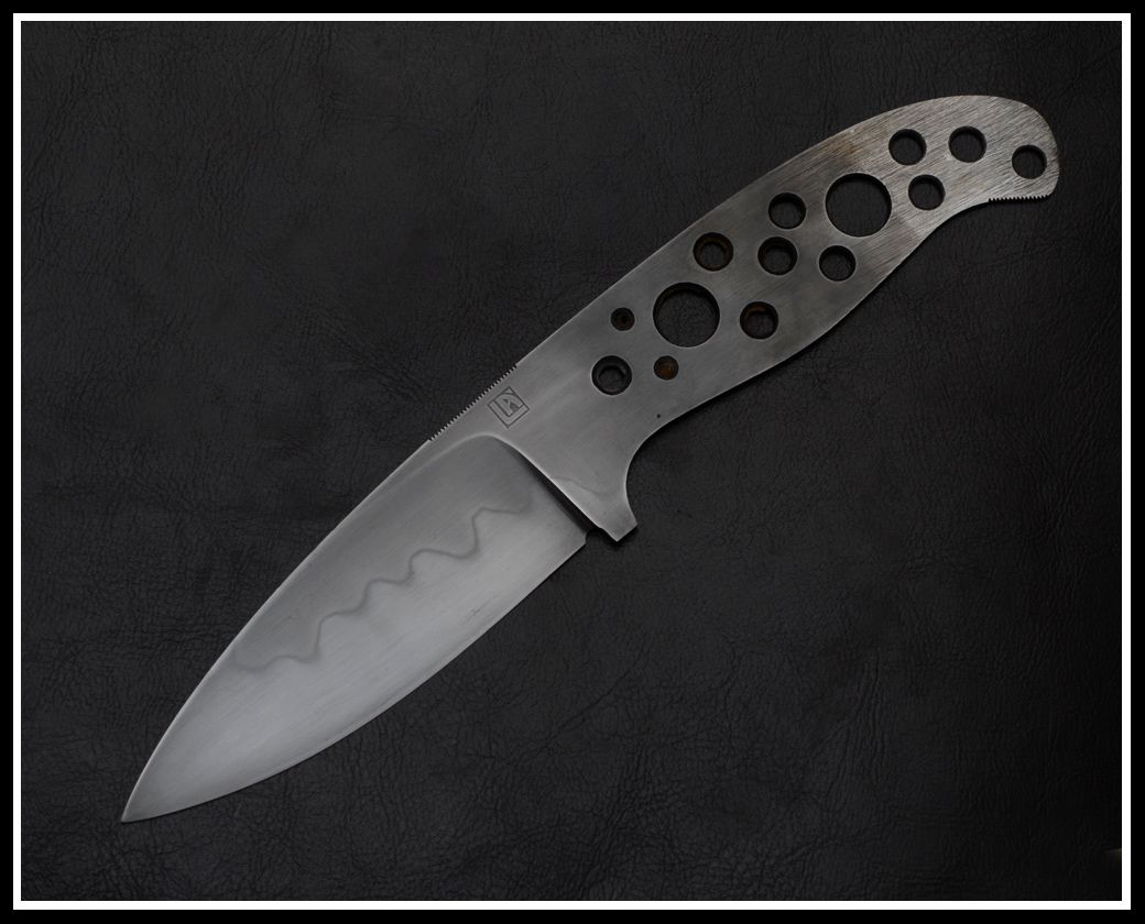

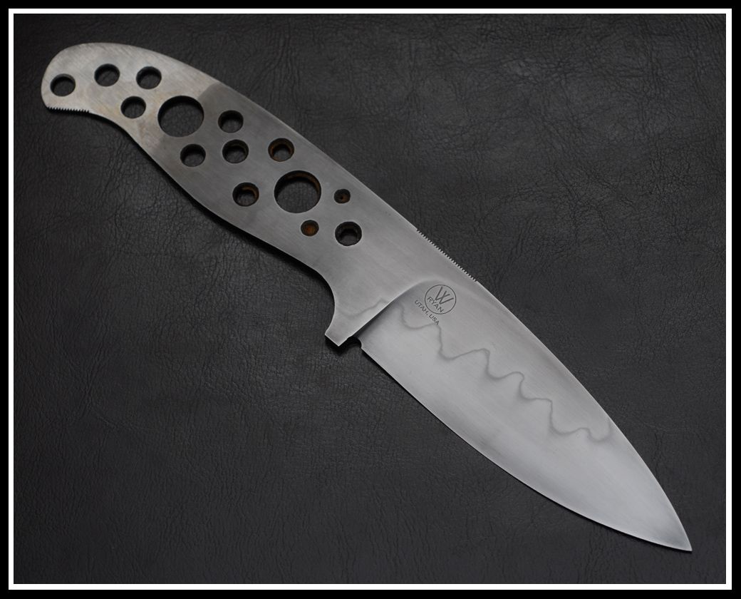

Here is the Hamon Etched, still needs a bit more polishing. I coated with Oil and hung #1 on a nail. 5 more to go!
Thanks for following
