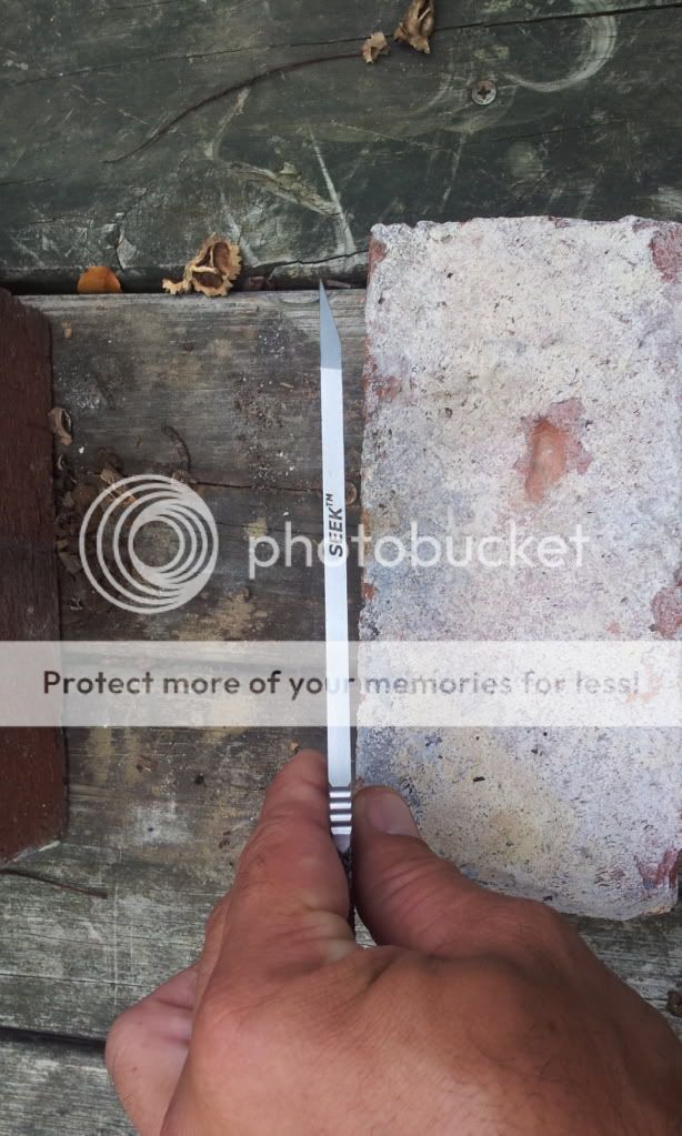

Here is a new blade I picked up from Steve Johnson at Blade Show this year. I will be doing some more involved testing and reviewing soon, but I wanted to get some feedback from ya'll.
See what you think.
So far, I been pretty impressed with how well it cuts, but we'll get into that a little more later on.

The whole thing is D2. And if memory serves, its HT takes it to around 60. SEJ would be able to answer that better.
Right now, the handle is a just a synthetic all weather material covering the D2.

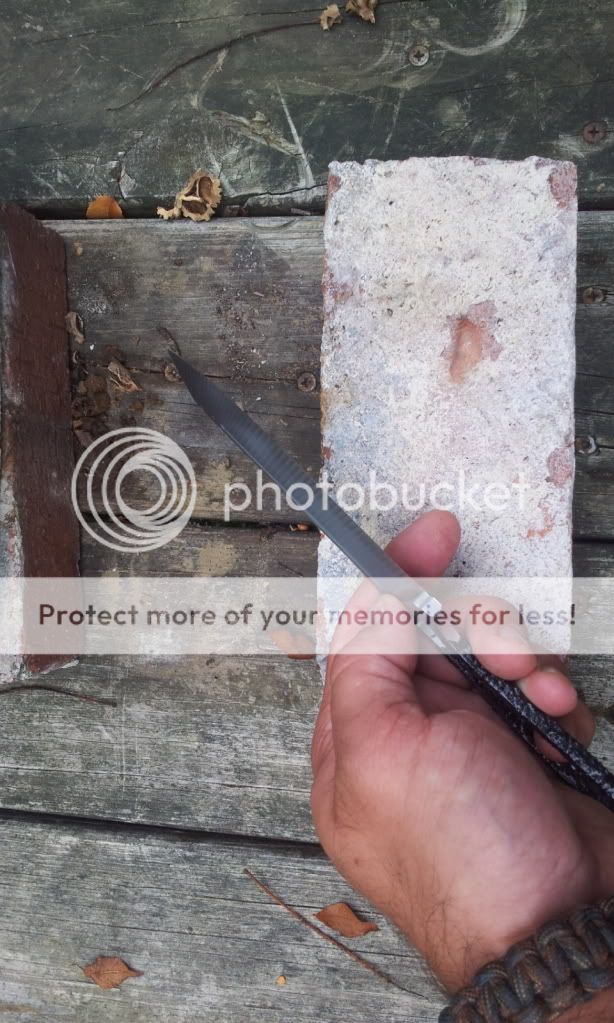

Nope. Not at all. :) I tested one of the prototypes to failure. I'm not saying you CAN'T do it with a sand brick....but they're pretty tough.
Its just black from some tree roots I was digging at, that's all. :D
There is still a very pointy tip left on it.

Blade, steel & heat treat: edge has Microserration(TM) (grinning) Steel is D2. Heat treat is in house and I'm taking the fifth on my exact process...I will say this....at one point in the process there is big pot of stuff that bubbles, smokes and get's really angry when I put the steel in it.... Handle is a work in progress. The one Moose has is dipped in Hurculiner, it is a very utilitarian coating that provides good texture, light weight and easy clean up. It will be the standard handle finish and keeps the price point down. I made some scales yesterday that will be the model for a mold that's in the pipeline, but that will probably be a 25-30 dollar option.
it's not so much cheap as it is ignorant.... I am coachable.... (insert pointers here, please) :)
Gracias. if you can give me about 1 hr, I'm getting some stuff wrapped up with our ad agency on the beef side....
Is that chisel-ground with a micro-bevel on the back side? Voo-ha!
You are correct sir.
The MicroSerrations (tm) are designed to be renewed, easily. Instead of sharpening it like normal serrations, you just sharpen the back bevel, then strop the front. The serrations will be fresh and sharp. So far, its worked. I've sharpened it twice (didn't have to) but I was curious.
