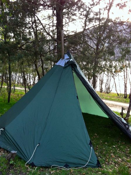

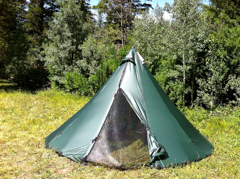

Screen doors:

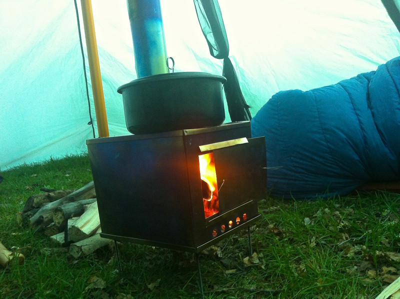

Tipi with wood stove:
The stove is titanium. Specs:
  • Volume: 680 Cubic Inches
  • Dimensions: 8.25 x 8.25 x 10 inches long
  • Height 12″
  • Weight w/ 8.5" stove pipe: 42 oz. (2.6 lbs)
I went back and forth on whether to go with the medium stove or the large, but so far I'm happy with the medium for a tipi of this size. It really cranks out the heat, and draws really well once it gets going (there is a damper adjustment). However, if I was doing a lot of camping in the middle of winter, I might upgrade to the large.

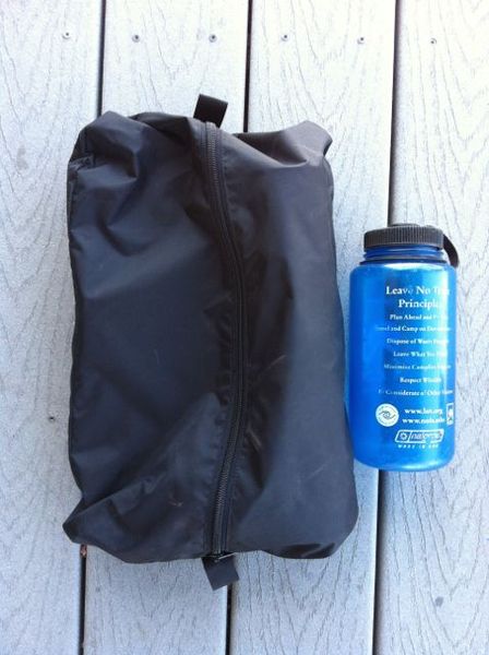

Here is the stove packed up in a zip bag, next to a 1L H2o bottle for size:
The whole setup, with the stove, weighs just under 10lbs. You could easliy split it up between 2 or 3 people and backpack with it just about anywhere. And while it's described as a "6-person" it's really appropriate for 3-4 people max with gear, especially when using the stove. For early/late season backcountry trips, I'm really happy with this setup. :thumbup:
