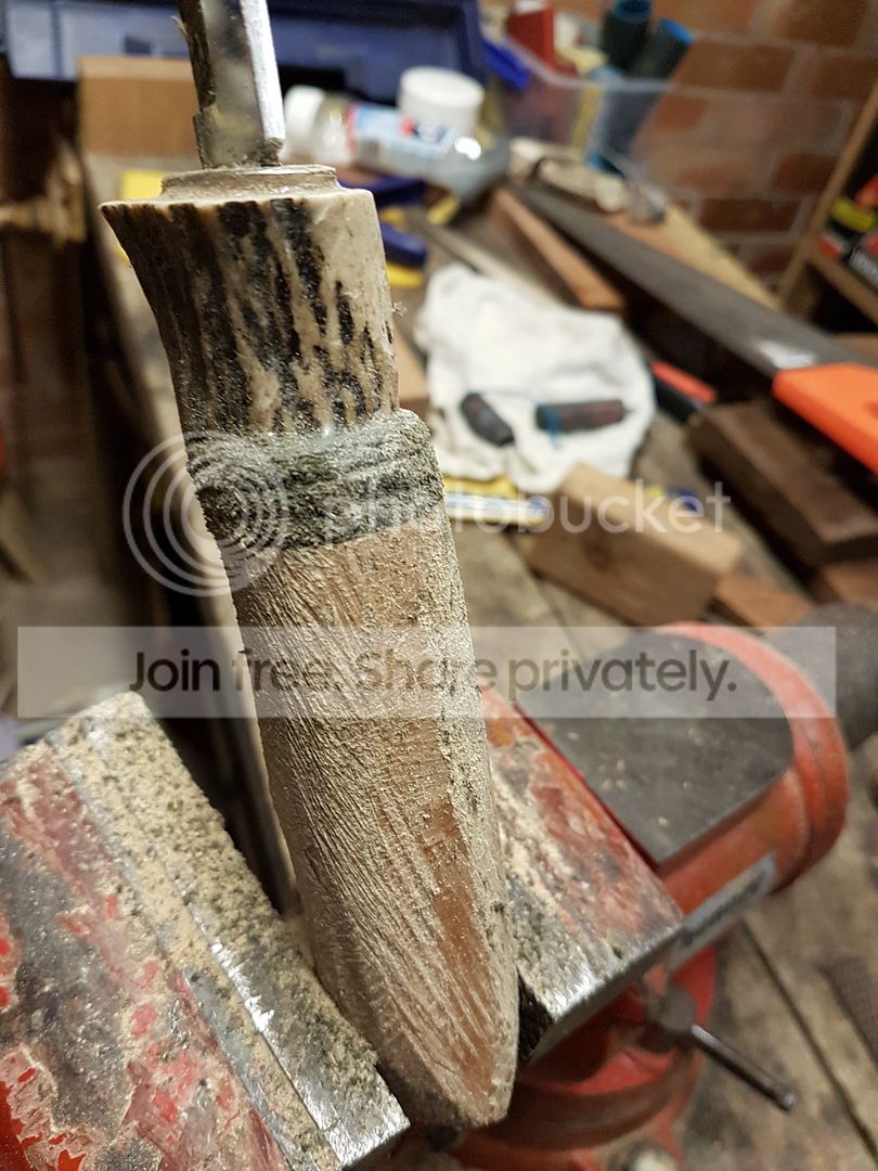

I took a treated stick tang stainless blade and nickel silver guard,knife kit making components,
epoxied them to a piece of antler and a block of Gidgee wood. Hidden tang type construction.
3 days later I pulled the wood off the tang as the epoxy had not cured .
The antler has stuck fast despite not having as much epoxy in the core as I would have liked.
The wood has cracked and split anyway because of a hidden knot I think but why is the epoxy from inside the wood still a gluey mess?
I note also that the antler did not adhere to the wood well.
all advice and thoughts welcome and appreciated.

I used 5 min epoxy - nb it came in a tube that premixes as as you squeeze it out.
I mixed the 2 parts together with a match as suggested.
What intrigues me is the antler is stuck fast to the metal which is good -but the the exact same glue in the gidgee hole didnt even set.

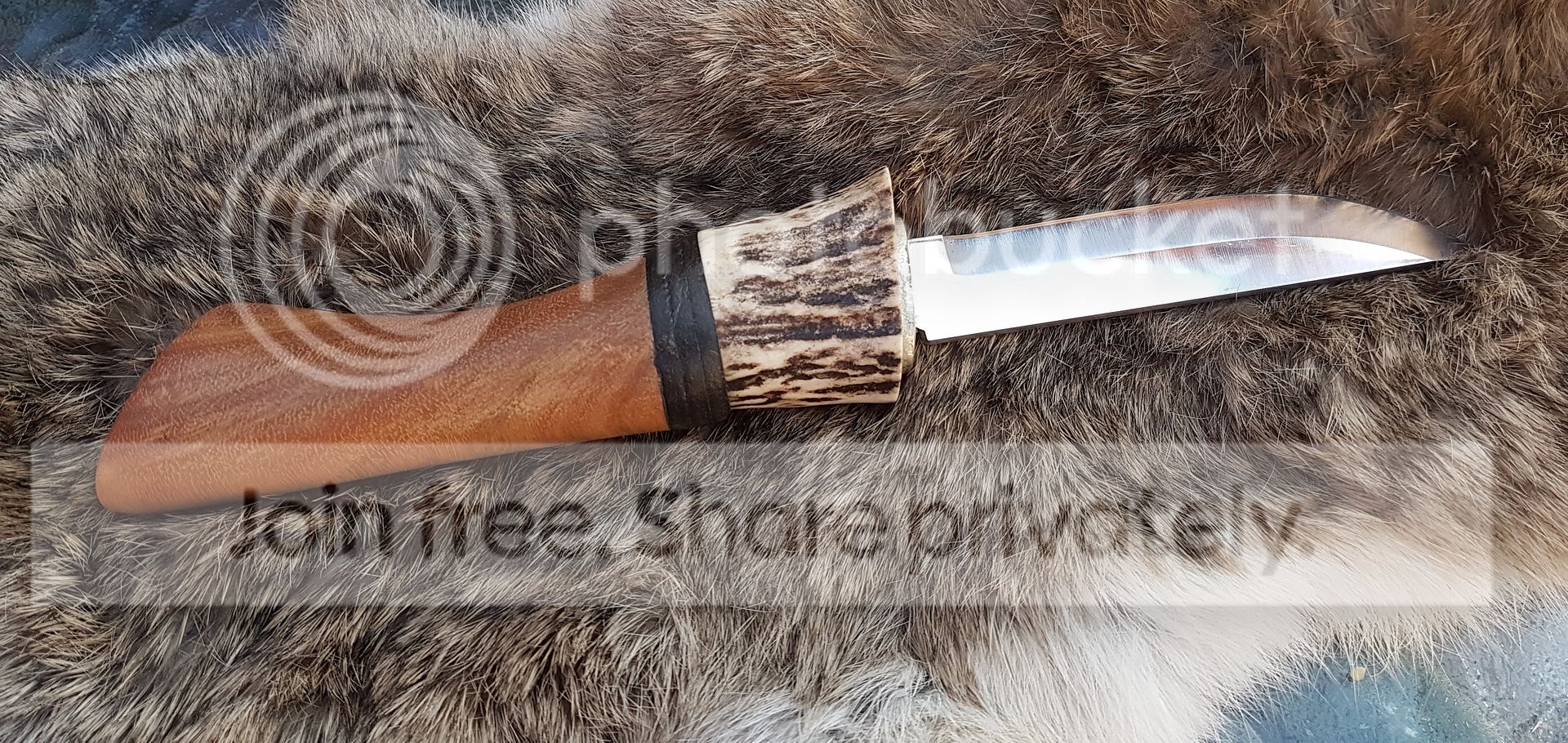

Well it all turned out OK in the end.
I used longer setting epoxy,a piece of old leather belt and a piece of scrap timber out of the firewood bin at a local joinery-could be Spotted gum but not sure. It certainly had none of the "issues" that my $20dollar piece of Gidgee had:grumpy:
Its all stuck fast and although the blade is a tad small for the size of the handle it rides well in hand and is comfortable.Quite happy with the result as it was a first attempt with the leather bit.
Cheers all for the good info.
I missed one thing in the OP. The wood that had the problem was gidgee. Gidgee gets really HOT when grinding, especially if you don't have VS. That could easily heat the wood up above 200F and make the glue joint fail. The softer wood on the new handle would not have had that problem.
Gidgee is a beautiful wood, but not the easiest to shape and finish.
Thanks Stacey.
I was using hand tools mainly a rasp to do the shaping -I also feel there may not have been enough glue in there. Alls well that ends well.
