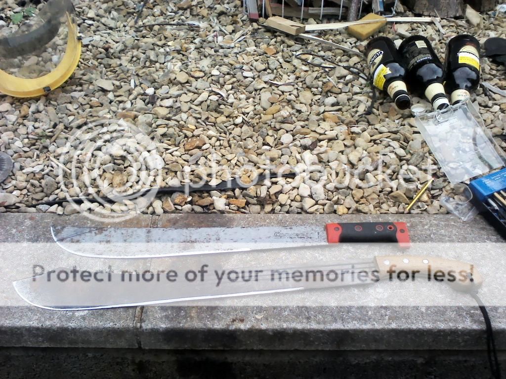

At this stage I'm restricted to hand tools - don't have the funds to spring for a belt sander yet. I do have a handheld belt sander, files and angle grinder. I have a number of machetes and "sword-like" machetes, most of which have a pretty sad edge. Any tips or hints for improving the factory edge using hand tools?

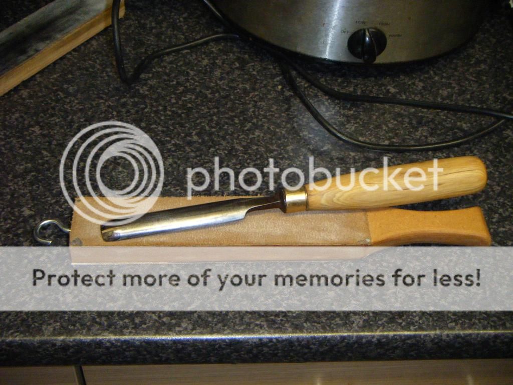

I'd also recommend purchasing or making a strop if you don't already have one. A strop makes the sharpening/maintenance process a lot easier.

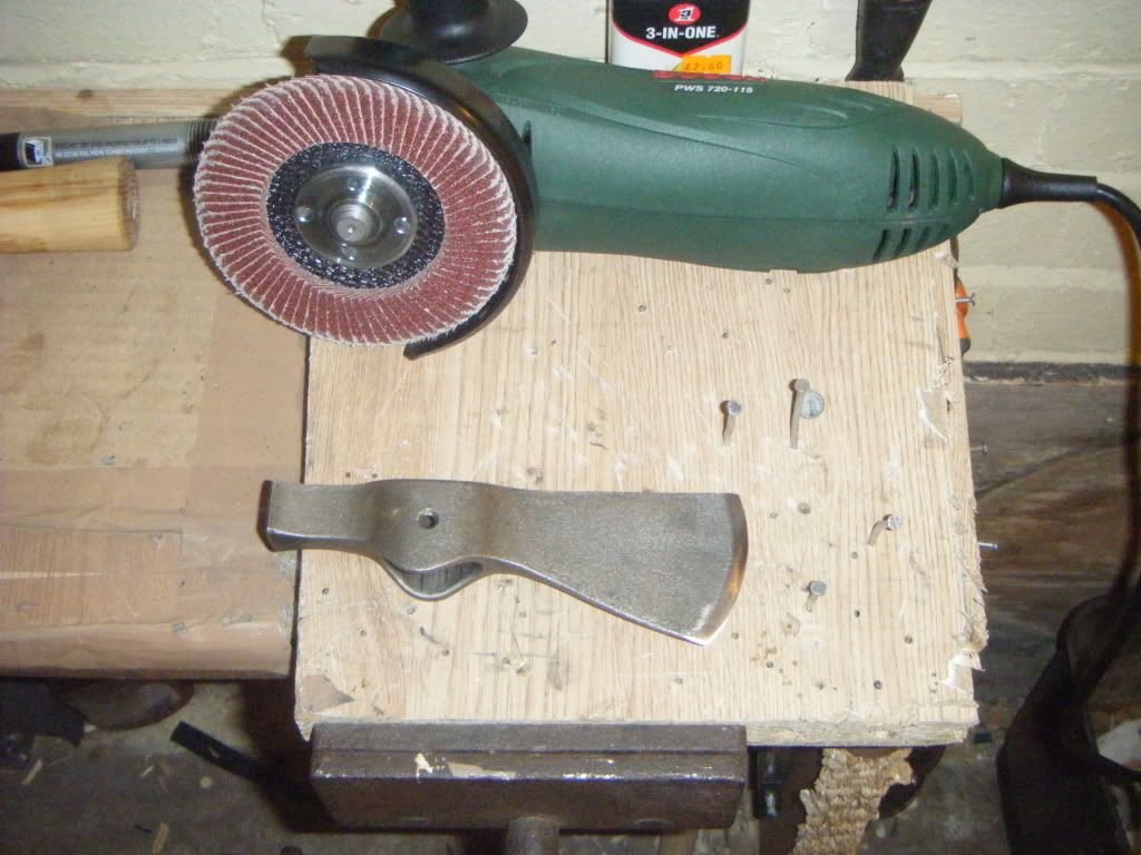

I disagree, the angle grinder in the right hands with flap/sanding wheels is the ultimate poor mans workhorse.
Being a poor man I've had to use mine for years and years as I could not afford belt sanders and the finer knife making tools and I can polish your nails with my Bosch! ;)

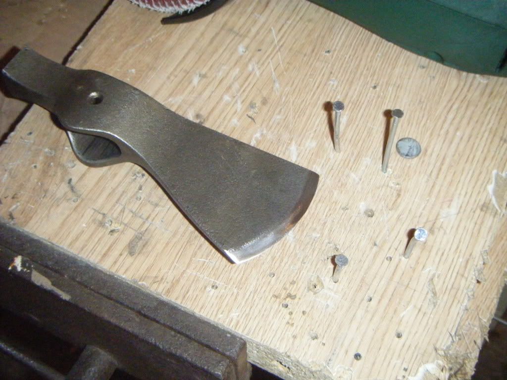

The only issue you'll run in to when sharpening tools with an angle grinder is the convex edge producing nature it can have and too much pressure causing over heating in the steel. Go light and even. I use mine professionally at a local place to sharpen all the tools they sell (I volunteer my spare time) and have done so with my own personal tools for years. I even create and modify bevels on thicker steel tools.
I don't mess with pocket knives or anything too thin though, not because it's undoable, but because I haven't needed to in a long time as I have enough files, stones etc to do that.
Angle grinder being the only power tool and finished 90% with it until final finishing with fine sand paper after.
All down to the right disk, practice and going steady. Always dip the steel in cold water as regularly as possible and always have one hand ungloved so you can test the steel temperature on full restoration jobs.
