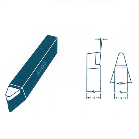

If you wanted to cut a fuller, I would use a regular lathe bit ground the shape you desired, and fit into your "gig".
You could use a carbide insert type;
Or grind down a more typical lathe bit;
Just my opinion, no experience cutting fullers, like I said I use the parting tool for extreme shaping, and shaving high spots.
Yes, those replaceable carbide and synthetic PCD diamond inserts and a tool holder make a great fullering sen cutter. These tools can be as fancy as you want, with screw clamps and adjustable guides ... or as simple as a piece of wood with a square hole in the center and a wedge tapped in to hold the cutter.
