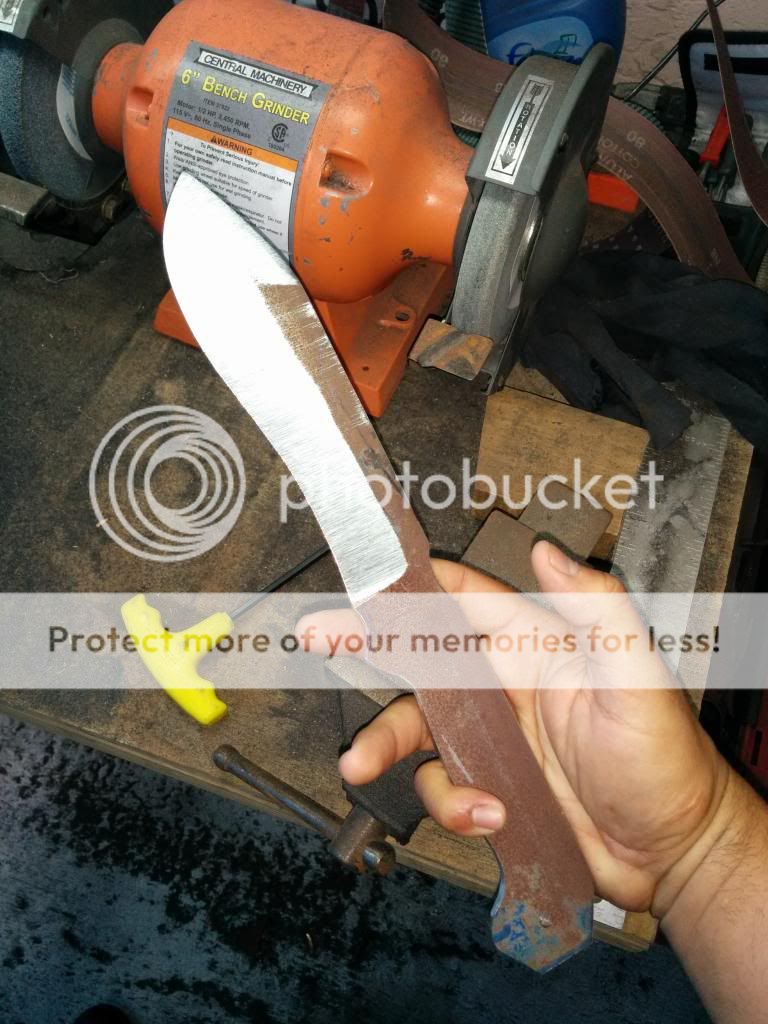

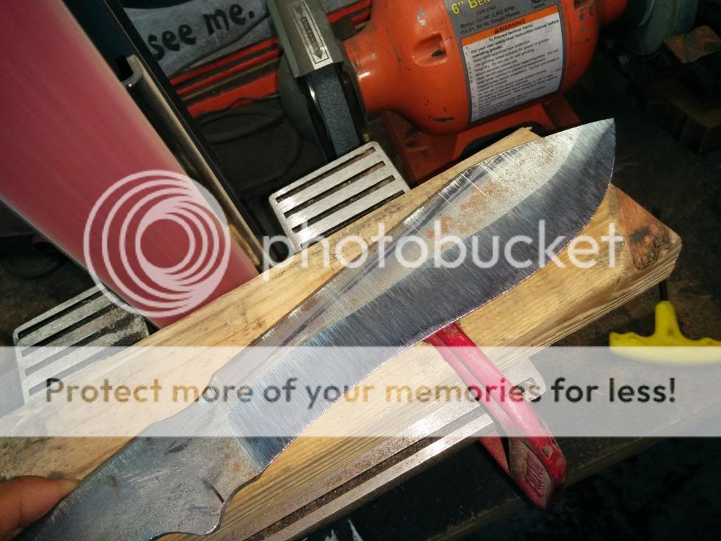

I will snap some pics and post later, one side is almost done. Thought about going full flat but will keep it a high saber and front swedge, not doing the other one at the spine. Lengthwise I think it is a hair shorter than the original due to this being a late idea with what was left of a bar of 1084.
Those are cool!
...quoted from the other thread...
Thanks, and yes, here she is:
I like that one as a starting point.
This blank is an old 5/16" thick leaf spring, 2.5" x 32". Leaf spring blanks are plentiful. Once I figured out how to make them flat, the rest became possible. I had planned to attempt some type of sword, but I have more leaves. In fact, I have a shorter one from the same pack. I'll have to go and find that piece.

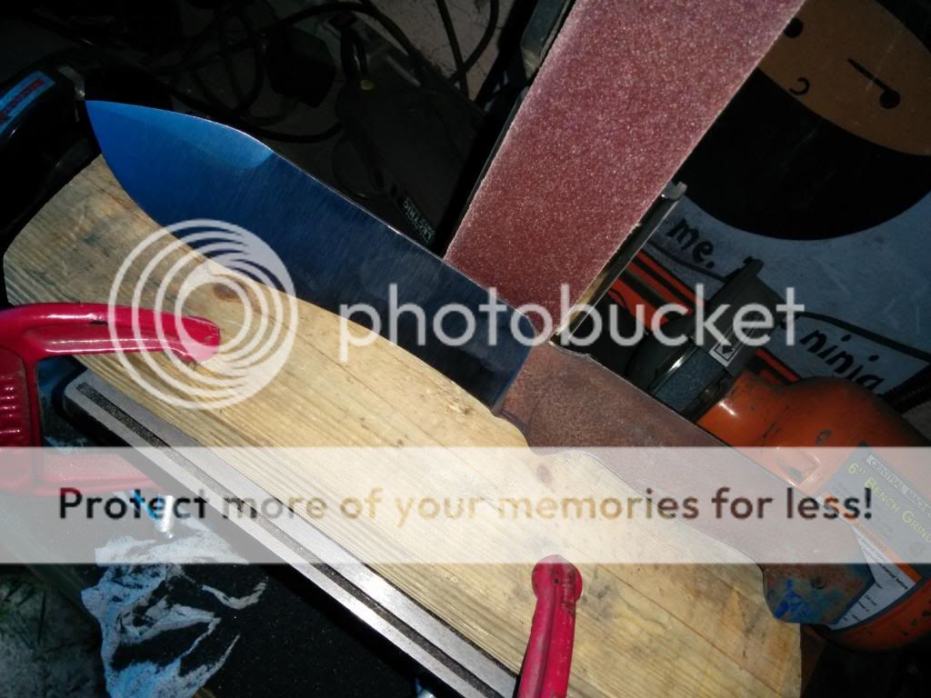

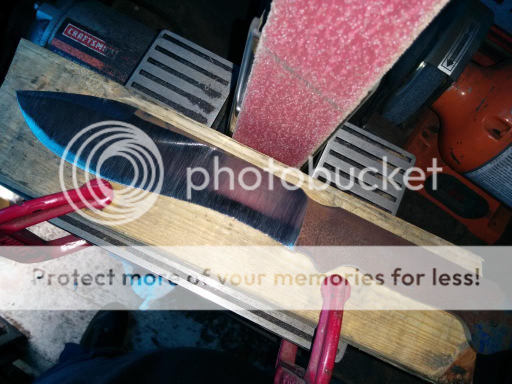

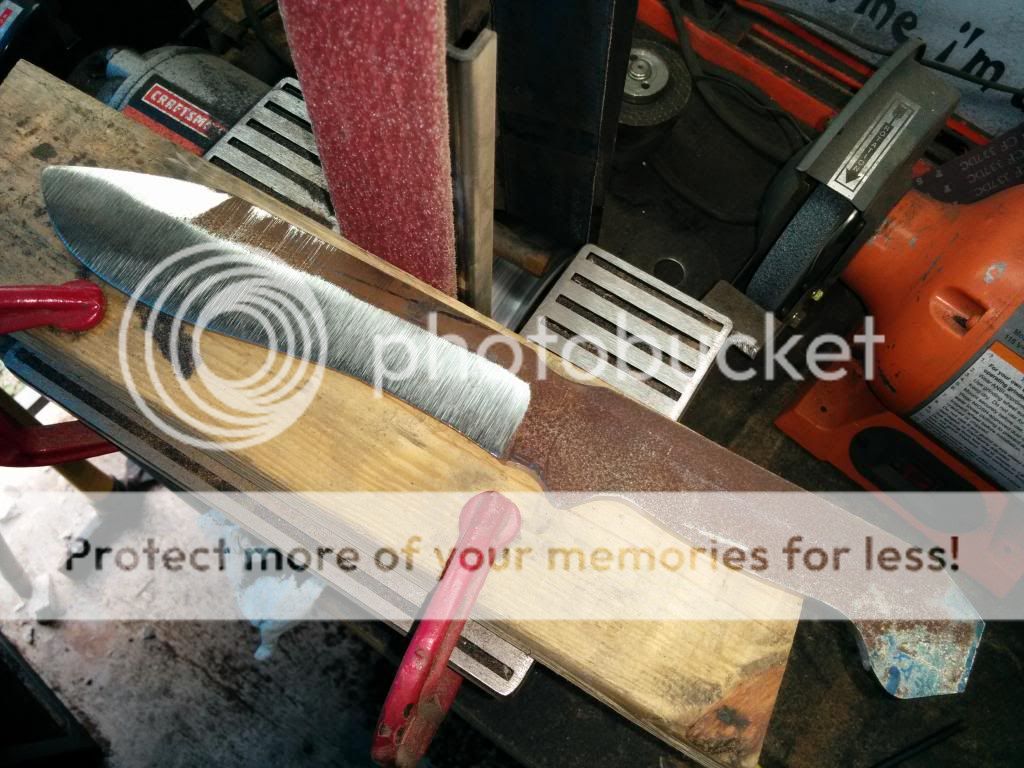

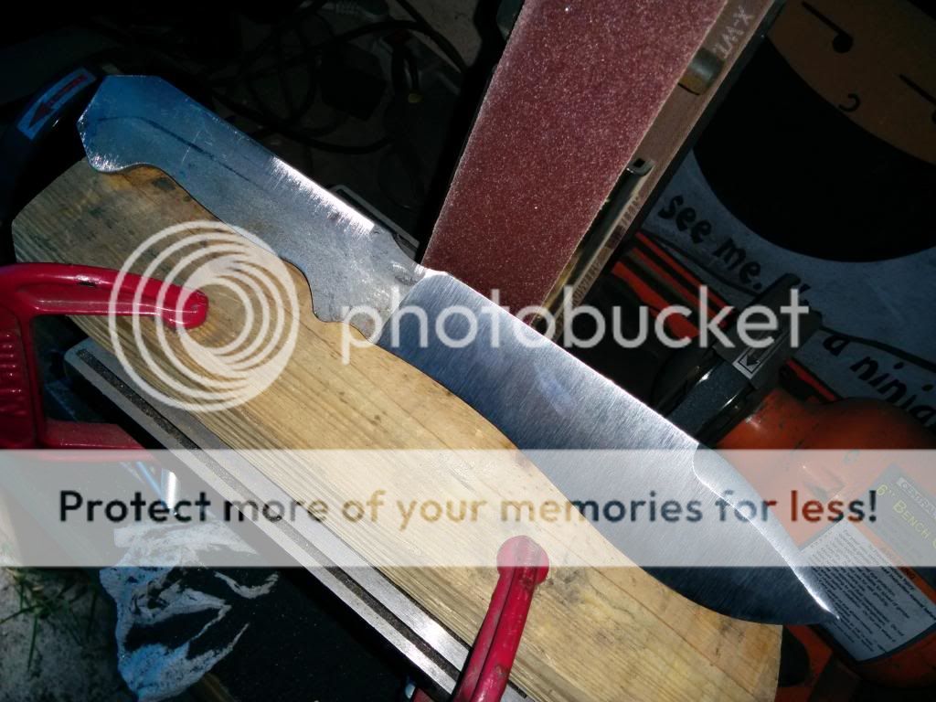

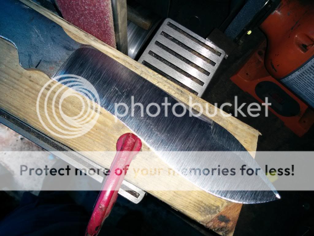

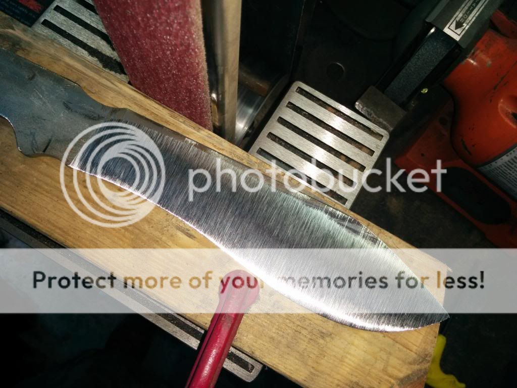

well, scratch the high saber, it's gonna be a full flat. Had some trouble keeping the grind straight on the right face so decided to go all the way to the top. Now it needs holes, and it will be refined by hand and scaled when it gets back from ht. If everything goes right and it comes back in reasonable time, I might be able to take it to Ethan's gathering.
left face was going ok

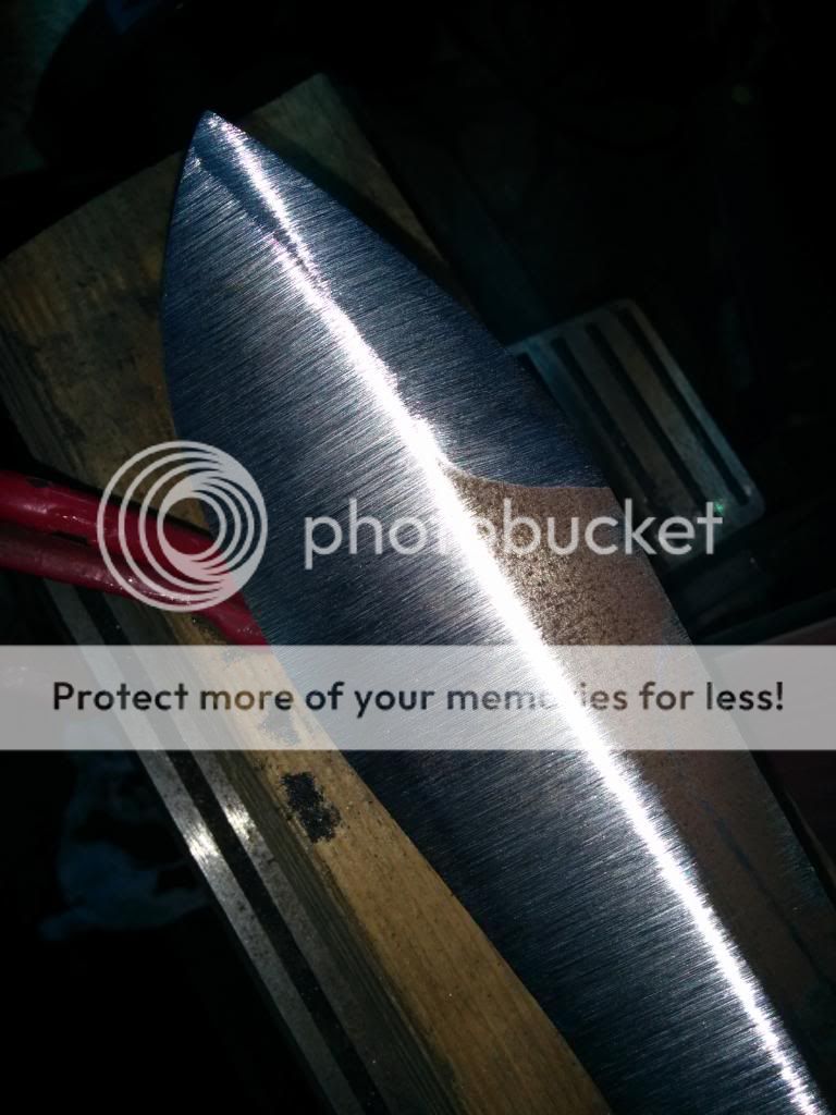

and so was the right face, too, until I started to push it up

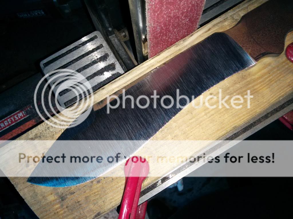

at this point I said "f*ck it let's go full flat"
left it at 80 grit belt, and will drill the holes tomorrow
