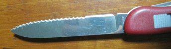

I got my Adventurer SAK confiscated at a McCain-Palin rally last fall. Since I can never find one in town I ordered a replacement on the internet. Due to a bad picture and a faulty memory I ordered the Boy Scouts version of an Adventurer, forgetting that they come with serrations. Although I decided that I didn't like serrations 40 years ago I thought I would challenge my prejudices and carry this serrated knife as my EDC for a year.
Now at the end of the year I have determined that my assumptions about serrations were wrong, they are even less useful than I thought. I had thought that if I simply needed to slice through a fibrous material I would find the serrations had an advantage--they don't. I thought that maybe if I chopped into a material with a somewhat tough outer layer and a softer inner layer the points of the serrations would break the surface and cut easier--not true. I thought that if I used my various sharpeners I could improve the serrations sharpness and approach the performance of a plain edge--I couldn't.
What I found is that serrations drag so much that they torque whatever I am cutting and generally cause material to bunch up for reduced performance. I thought that maybe this reflected issues with the serration geometry of the Adventurer, but I saw the same thing when I tried a Spyderco kitchen knife that I own. The simplest things like cutting open plastic bags works worse with a serrated blade than with one of my razor-honed plain edges.
So my year long test is over. I am going to grind the serrations off this knife. I will try another experiment in the process. I have begun to think that a sheepsfoot blade shape is optimum for city boy useage. I kind of want an oversized box cutter. So that's how I'm going to regrind this blade. Take a look at this blade below. Next time I show it it's going to be a sheepsfoot:

I think it has a lot to do with the design of the serrations.
For example, I've found my Endura ZDP-189 (fully serrated) to be an excellent cutter.

Sounds like dull serrations, but I am under the impression you sharpened them.
Serrations can grab onto things, though.

My serrations are sharp. I have numerous tools just for sharpening serrations. The problems that I see are fundamental to how serrations work.
In general when I cut something I hold it or stabilize it with my left hand and cut it using my right hand. Serrations have multiple points of contact with material that I am cutting and cause increased drag on the material as I make my slice. A solid object like a stick will pivot from my left hand and cause the serrated blade to bind in the cut. With a straight edge I would be using somewhat more of a push cut and would have less drag for the slicing action and would pivot less and bind less.
I often cut material like cloth or plastic bags. Serrations sort of snag in the material and the increased surface area in the edge scallops increases the work to get through the material. I work harder to get a ragged cut than if I had a smooth blade. This is compounded when the material twists away from my left hand as I make the cut. Even rope does much the same thing if I don't have it secured to something. I might conveniently saw through a knot that pinned to the surface of a structure with a serrated blade, but if I cut a free hanging rope the serrations just tangle up the process.
I am spoiled by thin razor sharp plain edges. If I cut through plastic bagging it is effortless and smooth. If I cut through a rope the force gets high, but it takes only a single smooth push. I was particularly disappointed in the effort required to cut cardboard with a serrated blade. Again I am usually controlling a box with my left hand and cutting with my right. With a smooth edge I usually just zip through the cardboard with minimal smooth transverse action. It is slightly slicing and mostly push cutting. This works without binding with a thing smooth blade. With a serrated blade the box twists and the blade binds. The asymmetric blade grind and the serration points also make the blade wander off my target path. It was outright displeasing to use a serrated blade on boxes.

I reground my blade and got it back to razor sharpness. I had to remove a bit more blade width than I might wish and the edge isn't quite as straight as a true sheepsfoot, but it works great. I'll post some examples later. Anyway here is what it looks like now:
