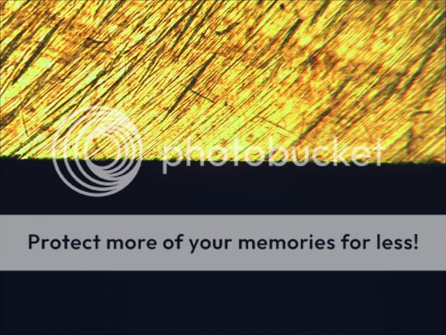

I have a number of images taken at 640 and 1600x (technically 400 and 1000x because the wavelength of light prohibits greater magnification than 1000x - so some of the increase is low quality digital enlargement, must go to SEM for higher). That said, any edge that fails to show teeth at 1000x (and there are plenty) effectively have no teeth - take a look at common objects at the same magnification and it becomes clear that any teeth too small to see aren't going to interact in a meaningful way with whatever you're cutting. I will add that it is difficult to get to that level of polish by hand - edges that look wonderfully polished by eye or even at 120-200x look a lot different at 640 or higher.
This is one at 1600x from a 1200 grit King - no real serrations, but some formations visible.
Here's another one at 1600x that shows even fewer formations
this is what it looked like at 160x, by eye it looked nearly polished

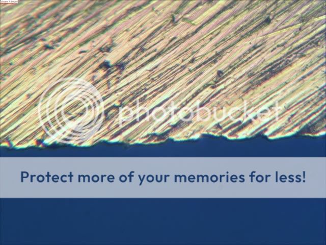

This one is at 640x - scale at upper right is 7.7mu - consider a single blood cell is about the width of the scale. A single human hair is 30-50 mu and would take up about a third of the image area at the low end. This edge is hair whittling. If I'd added the same scale to the above 1600x pics, it would be about 3mu,a human hair would take up over half the image area.
FWIW I don't much care for serrations, but there are certainly formations on rougher edges that absolutely have an effect on cutting performance depending on what it is you're cutting. The formations have to be able to press into the target material and separate it somewhat, or IMHO there'll be no advantage. Not sure what other folks find, but for me, as near as I can figure, when the edge reaches the example of the hair whittling edge above, it starts to loose all drawing advantage - that is there's no real improvement in cutting with a drawing motion as opposed to a pressure cut. From that point on I'm pretty sure the formations, microserrations, whatever you want to call them become irrelevant unless you're cutting something with a microstructure small enough to interact with it - not sure what that would be. That said, there's sure to be formations present at any level of polish if you can get a close enough look until you're down to the crystalline structure - do they matter at that scale is a better question?

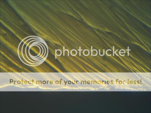

Here's one from an 800 grit King stone - very toothy, but not really serrated. The high points are pretty polished from stropping on newspaper and mighty acute - at a guess I'd say a micron or just under, the low spots are considerably thicker. This edge could easily shave your face, but then it would itch like mad for a couple of hours. Was amazed it could tree-top leg hair.
Serrations are a little different than coarse edge formations but not so much in how they work. I find I have to use less pressure and more movement with serrations and they work OK - they choke with too much pressure - more like a pruning saw, and a plain blade with a somewhat rougher edge might be comparable to a hack saw at the same scale.
