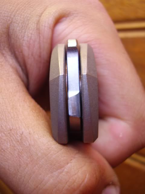

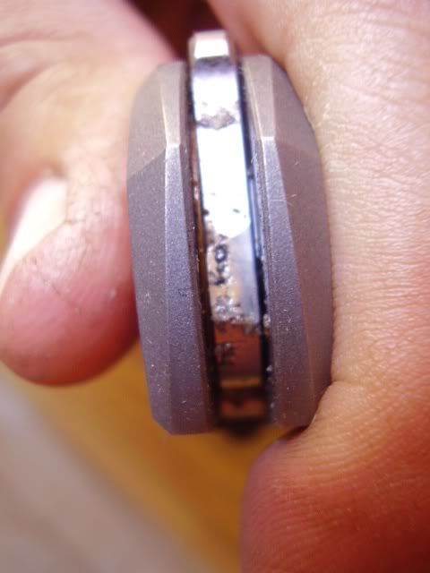

Though I appreciate the ability to take a Sebenza apart it is not always necessary. IMO some people overdo it with the "taking a knife apart to clean it"
Here is a post I did a while ago.
Forgot to put the :) face with my previous post.
People tend to freak out way to much about water. Using warm water, soap and your lungs can get most of the moisture out.
Here are some pictures:
Nice and dirty from sawdust.
Then some soap, warm water and lungs....
Nice and clean
I do apply a small drop of fine machine oil (designed for small gears). Been doing this with my knives since I can remember.
